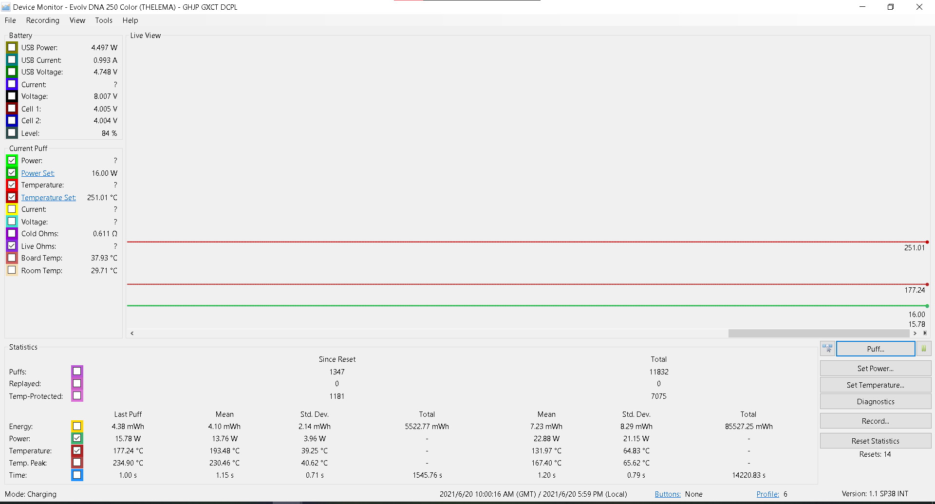

CMK Posted June 20, 2021 Report Posted June 20, 2021 Kannst Du dieses Verhalten bitte mal in Escribe dokumentieren und entsprechende Screenshots hochladen?

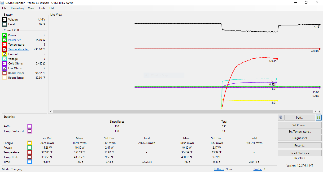

dwcraig1 Posted June 20, 2021 Report Posted June 20, 2021 Here is an example of what's requested, this is done with Windows Snipping Tool but any screen grab will do.
rin Posted June 20, 2021 Author Report Posted June 20, 2021 38 minutes ago, gwyar said: Kannst Du dieses Verhalten bitte mal in Escribe dokumentieren und entsprechende Screenshots hochladen?

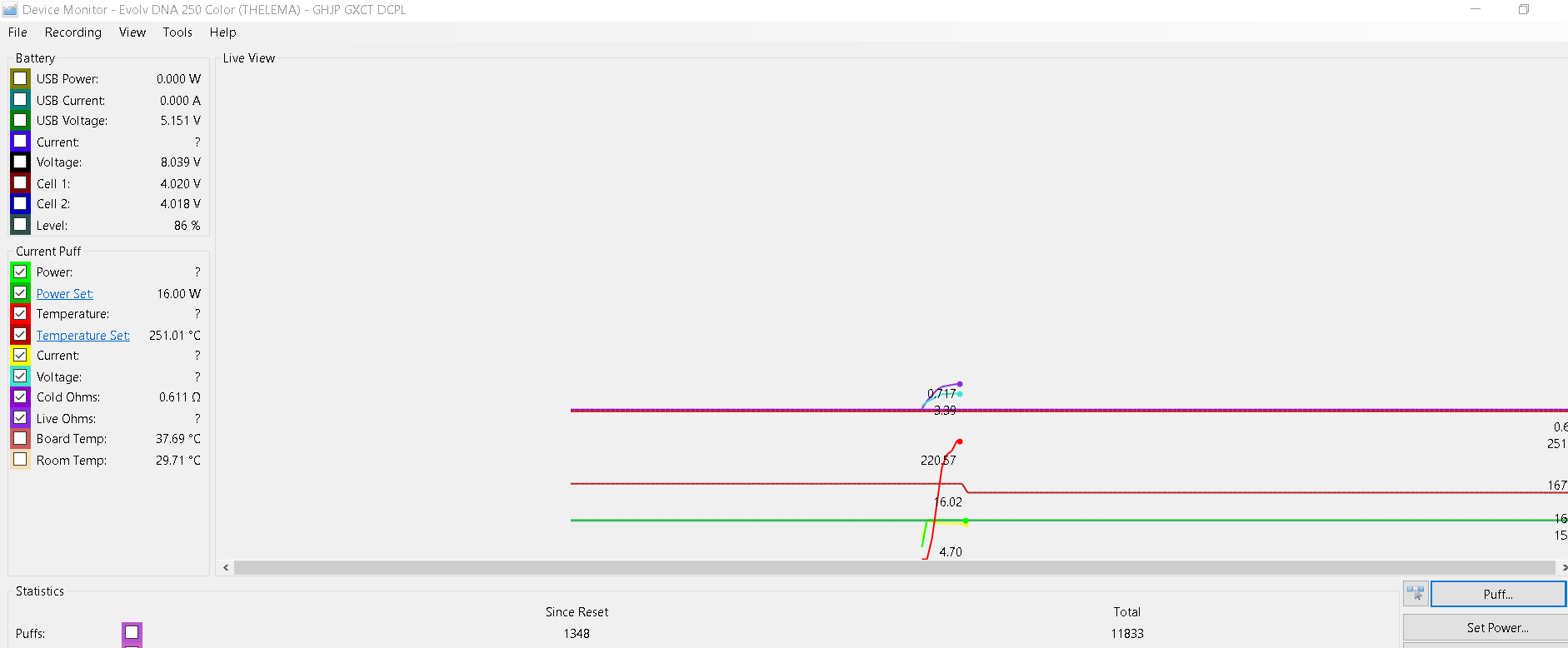

CMK Posted June 20, 2021 Report Posted June 20, 2021 Kannst Du bitte auf der linken Seite "Current Puff" die Kontrollkästchen "Current", "Voltage" und "Cold Ohm" aktivieren, anschließend einen Puff machen und das Ergebnis hochladen? So ist da nicht viel zu erkennen.
rin Posted June 20, 2021 Author Report Posted June 20, 2021 3 minutes ago, gwyar said: Can you please check the checkboxes "Current", "Voltage" and "Cold Ohm" on the left side "Current Puff", then make a puff and upload the result? So there is not much to see.

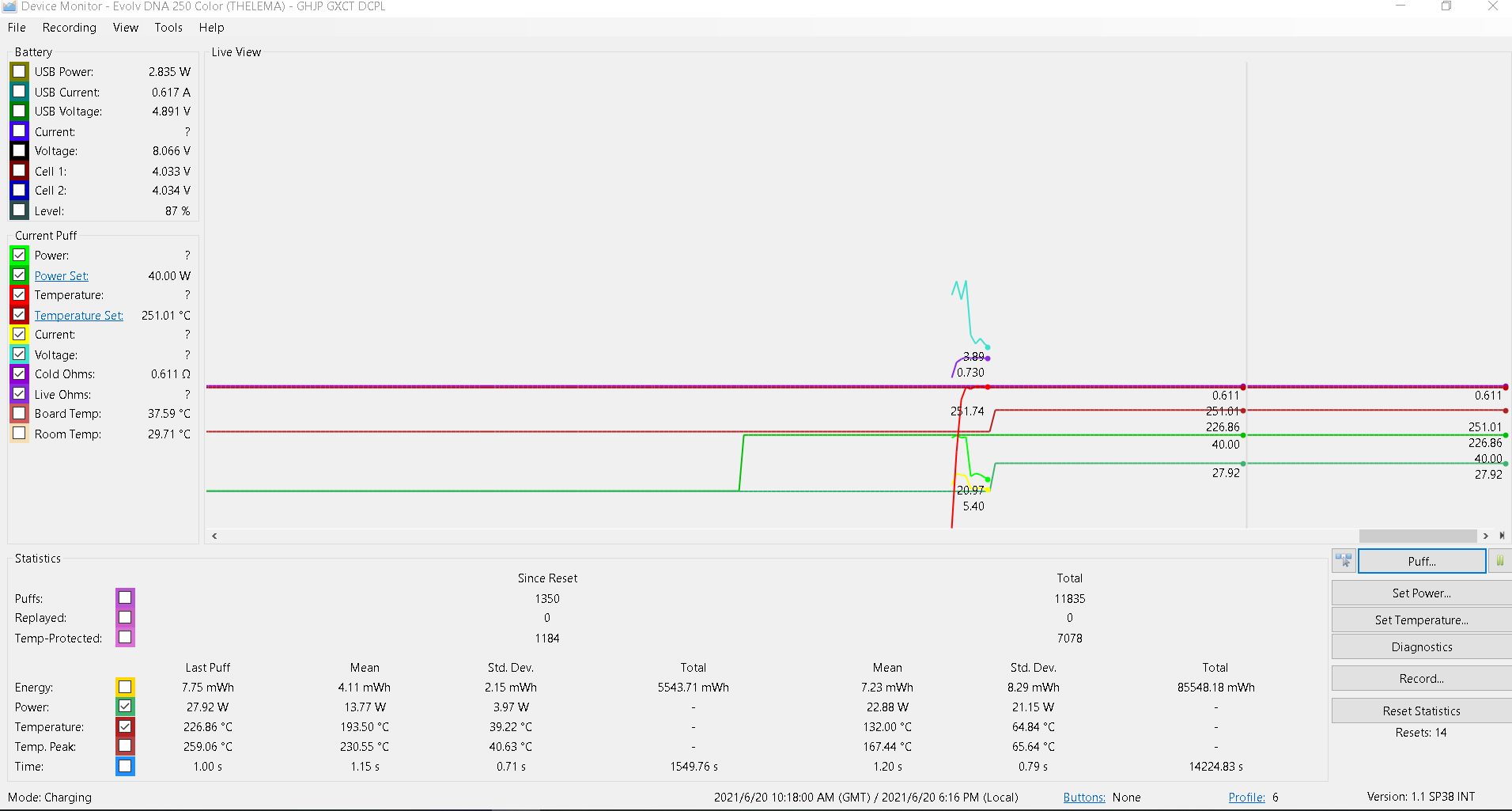

rin Posted June 20, 2021 Author Report Posted June 20, 2021 1 minute ago, gwyar said: Oksy, now please again with 40 watts
CMK Posted June 20, 2021 Report Posted June 20, 2021 Schaut doch prima aus - 250 Grad Celsius erreicht. Leistung zu Beginn stark angestiegen um die Temperatur zu erreichen, anschließend die Leistung gerade soweit heruntergeregelt, dass die Temperatur gehalten wird. 1
rin Posted June 20, 2021 Author Report Posted June 20, 2021 1 minute ago, gwyar said: Looks great - 250 degrees Celsius reached. Power at the beginning greatly increased to reach the temperature, then the power is reduced just enough that the temperature is maintained. what should i do now? I vape at 15 watts
CMK Posted June 20, 2021 Report Posted June 20, 2021 vor 1 Minute schrieb gwyar: Leistung zu Beginn stark angestiegen um die Temperatur zu erreichen, anschließend die Leistung gerade soweit heruntergeregelt Das würdest Du besser erkennen, wenn Du Dir "Battery" => "Current" noch anzeigen lassen würdest
CMK Posted June 20, 2021 Report Posted June 20, 2021 Gerade eben schrieb rin: what should i do now? I vape at 15 watts Nein - Du willst mit 250 Grad dampfen. Also musst Du eine Leistung einstellen, welche es dem Chip ermöglicht, die Coil ausreichend schnell auf diese Temperatur zu erhitzen. Die Leistungsregelung übernimmt der Chipsatz.
rin Posted June 20, 2021 Author Report Posted June 20, 2021 1 minute ago, gwyar said: No - you want to vape with 250 degrees. So you have to set a power that allows the chip to heat the coil to this temperature sufficiently quickly. The power control is done by the chipset. ok so i vape at 40 watts?
CMK Posted June 20, 2021 Report Posted June 20, 2021 Kannst Du problemlos machen - die 250 Grad erreichst Du ja. Mit der Zeit und Erfahrung wählst Du je nach Coil Leistungswerte, welche nicht viel höher als die benötigte Leistung sind; umso feinfühliger, weicher kann der Chipsatz die Leistung regeln. Würdest Du jetzt beispielsweise 100 Watt eingeben, wäre das Ergebnis nicht sehr "elegant".... Probier es einfach aus und schau Dir die Kurve in Escribe an. Mache für diese Vergleiche einfach mal jeweils einen längeren Puff, wenigstens 2 bis 3 Sekunden. Die verschiedenen Diagramme bei unterschiedlichen Wattzahlen helfen Dir zu verstehen, wie der Chipsatz im TC-Modus arbeitet.

Wayneo Posted June 20, 2021 Report Posted June 20, 2021 @rin Think of each item (temperature and watts) as a maximum limit. If you want to vape at 15 watts and your temp to stay at or below 250°C that's perfectly fine. (@dwcraig1 screenshot shows that example) If you want to vape at 250°C then as your own 2nd screenshot shows, you need more than 15 watts, and that's perfectly fine also. 2
