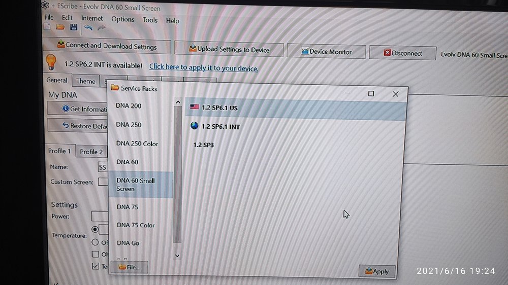

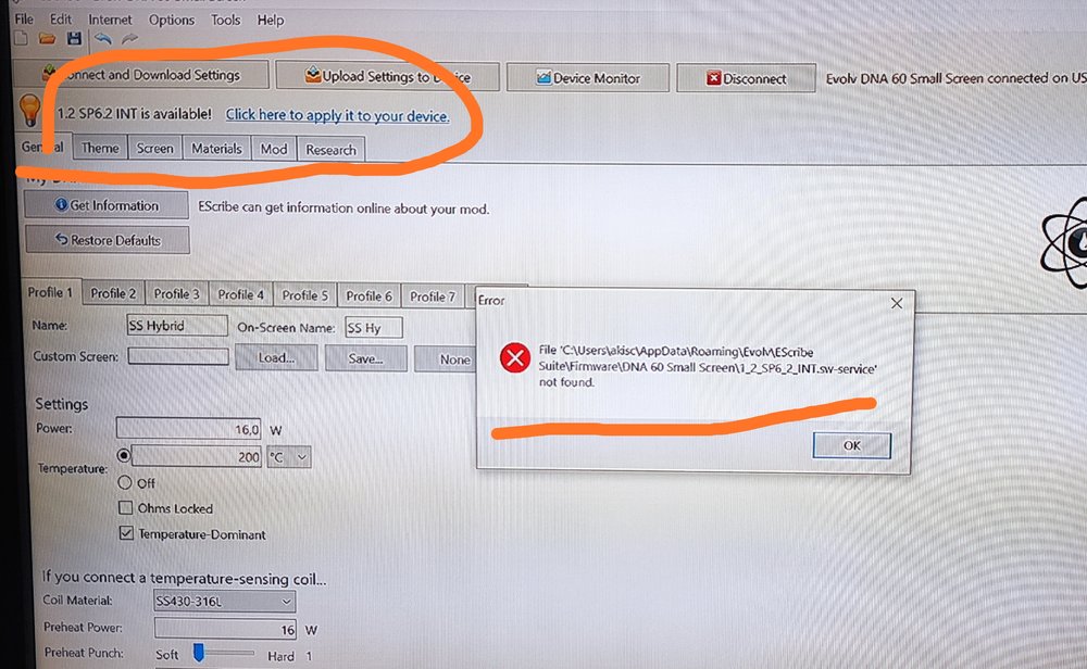

Akis Posted June 18, 2021 Report Posted June 18, 2021 I have the latest version Escribe which should contain the 1_2_SP6_2_INT.sw-service for dna60 small screen, but it doesnt for some reason. 1.I open escribe 2.connect my Iaido Dna60 by Dovpo 3.get the message that a new service pack it availiable 4.when i am going to install it i get an error message that 1_2_SP6_2_INT.sw-service not found i have tried to install it manualy through tools/apply service pack/dna60 small screen but i cant find that file "1_2_SP6_2_INT.sw-service" nowhere in my pc nowhere on the web Can anybody help me please?
dwcraig1 Posted June 18, 2021 Report Posted June 18, 2021 I'm only seeing 1_2_SP6_1 INT as the latest on my PC for either large or small screen DNA60. 1
Akis Posted June 18, 2021 Author Report Posted June 18, 2021 (edited) 18 minutes ago, dwcraig1 είπε: I'm only seeing 1_2_SP6_1 INT as the latest on my PC for either large or small screen DNA60. Me too, but I get a notification that 1_2_SP6_2_INT its availiable for small screen Edited June 18, 2021 by Akis
dwcraig1 Posted June 19, 2021 Report Posted June 19, 2021 I don't have a small screen 60 but I did plug in my big screen 60 to see if it would offer the update and it did not. Ask Evolv here: https://helpdesk.evolvapor.com/index.php?a=add&category=1 1
