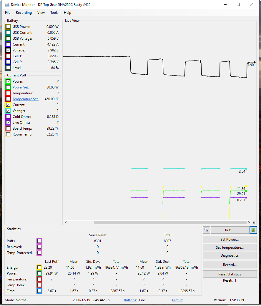

BillW50 Posted February 8, 2021 Report Posted February 8, 2021 Dang, what kind are these tanks? Are you using wattage or TC. Ever used EScribe before to take a screen shot of a few puffs under the Device Manager with live ohms, temperature (if using TC), power, voltage, and current checked. Like this (except this example doesn't have temperature checked since it is in wattage mode).

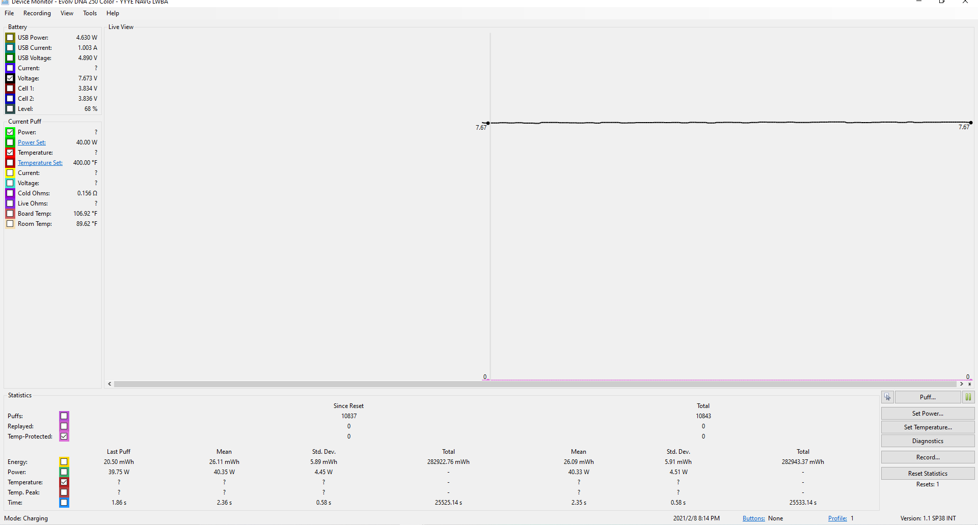

BillW50 Posted February 8, 2021 Report Posted February 8, 2021 Ah yes, I have a few FreeMax Mesh Pro tanks too. Those coils takes a lot to turn them all the way in until it clearly won't turn any further. I wasn't screwing mine in all of the way at first since it is so tight before it bottoms out. But that could be part of the problem. Nice graph, but on the left you need to have voltage, current, and live ohms checked too. You also need to take a few puffs too. That way it will be easy to see what the DNA is having a problem with. It would be really nice to get a graph of the ohms jumping around too.
BillW50 Posted February 8, 2021 Report Posted February 8, 2021 That graph it should be vaping perfectly fine. Ohms is holding steady too.
