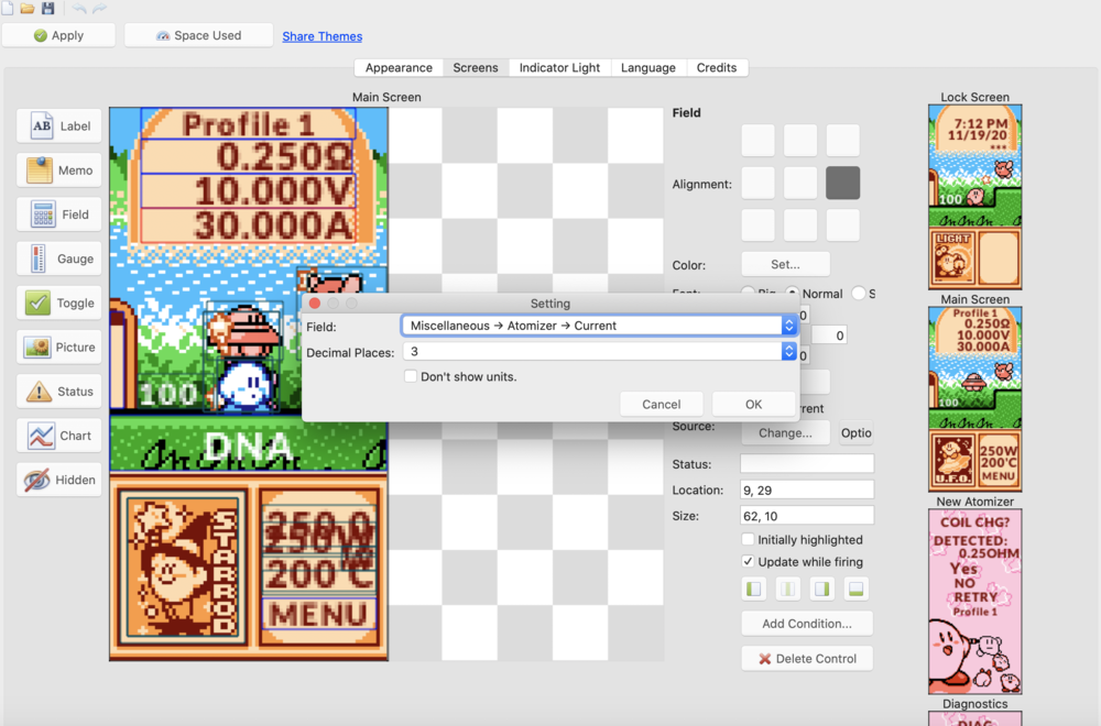

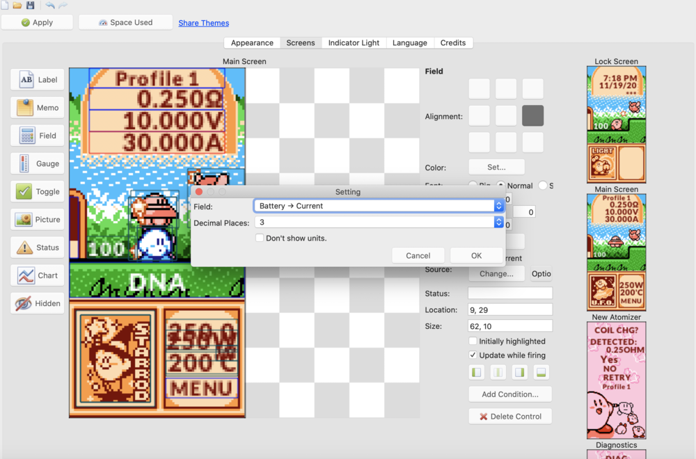

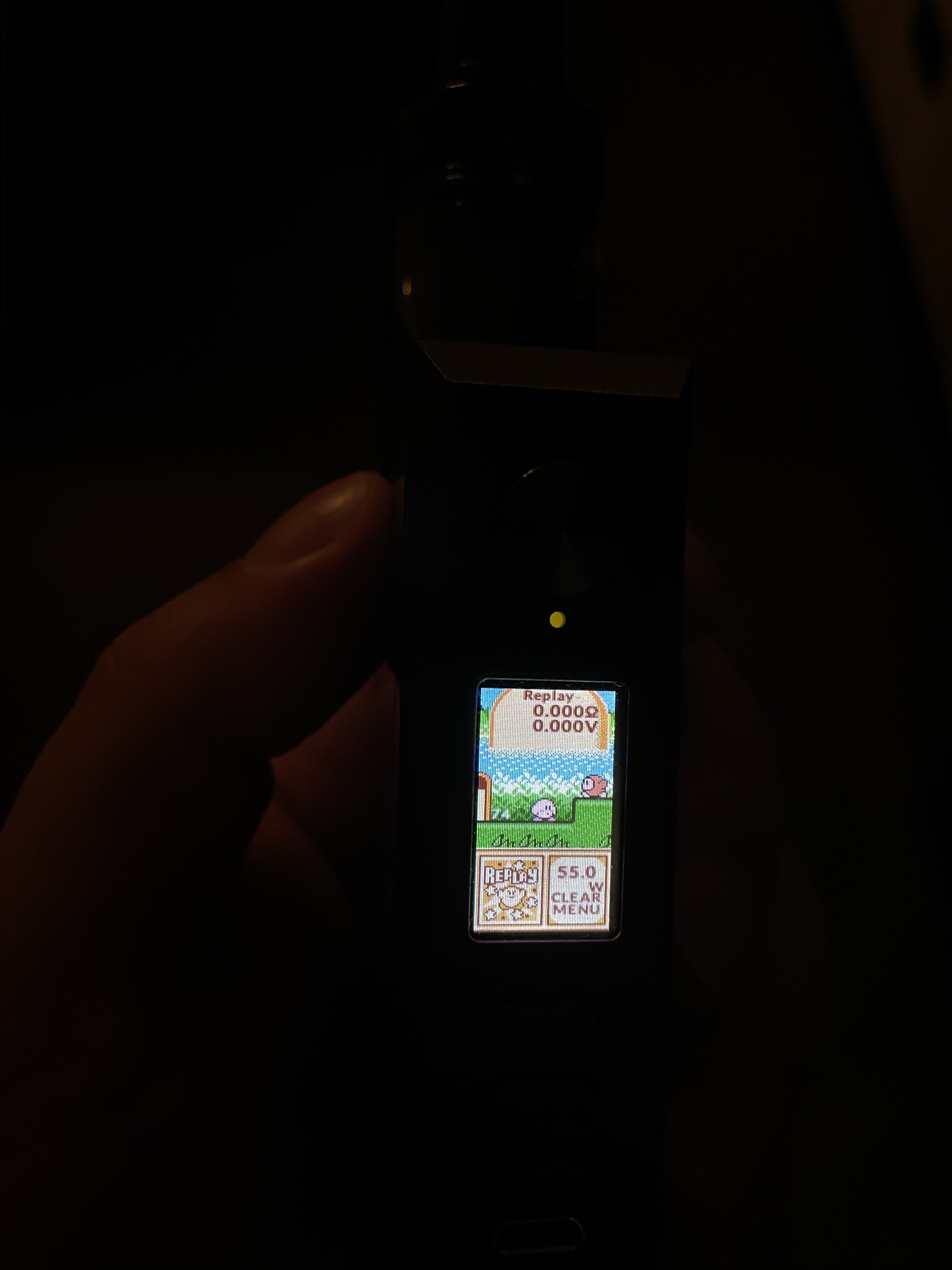

SolarBeaver Posted November 19, 2020 Report Posted November 19, 2020 (edited) Hello, first I'm new to this, so please bear with my newbiness for a while. I've been trying to edit other member theme, Kirby v.1.4, in particular I want to switch "atomizer current" readings to "battery current", but when I do this, the reading I missing before and after the puffs and only showing whenever I press hit button on my mod. I want it to be displaying the battery current after I make a puff and don't disappear instantaneously the moment after the puff ends. Here's the steps I take: I go to theme's designer->screens->main screen->selecting the reading I'm about to edit->in the source tab I press "options" and switch from "miscellaneous-atomizer-current" setting to "battery-current" and then I press apply. I've also tried "initially highlighted" checker to no avail. Can you guys help me out, please? I've attached screenshots, the edited theme and a photo how it looks on the mod itself below. editedkirby.ecigtheme Edited November 19, 2020 by SolarBeaver

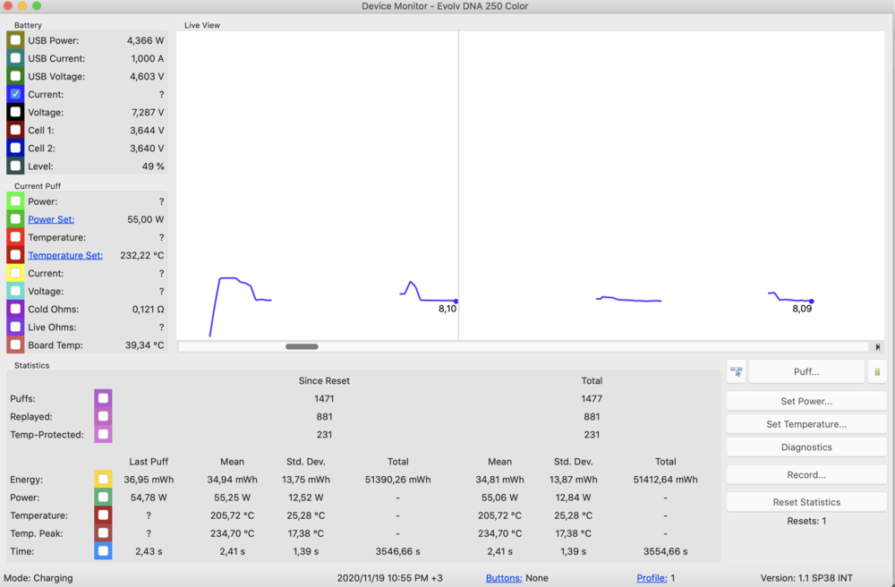

SolarBeaver Posted November 19, 2020 Author Report Posted November 19, 2020 (edited) I think it's not... When I press the fire button it actually shows the current from the battery being drawn (mod is not connected to usb) and it's the same as the one from the device monitor (in the battery section). Below is the screenshot of the reading I mention. Miscellaneous->usb->current is probably the reading you're talking about. Edited November 19, 2020 by SolarBeaver 1

Magigamix Posted March 8, 2022 Report Posted March 8, 2022 You are right, I added a field and assigned as "Source", the Setting "Battery Current" in one of my themes and the "Battery Current" shows nothing when firing the device, while in Device Monitor you can see the values and the correspondent graph.
