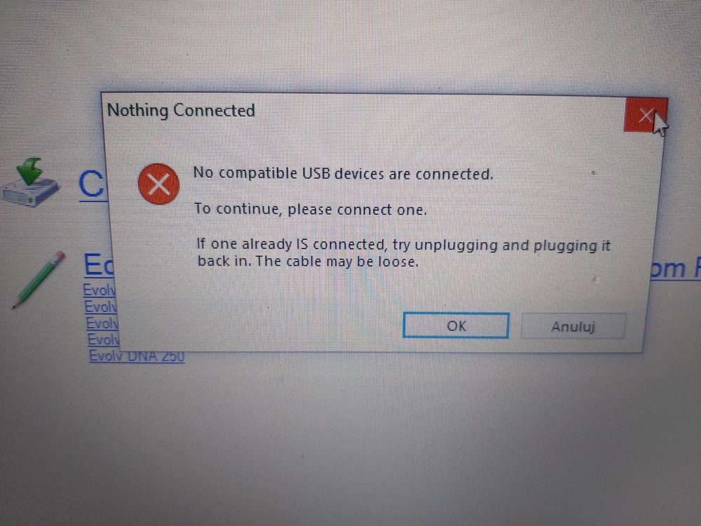

xShaq Posted June 7, 2020 Report Posted June 7, 2020 Hi i have problem with connecting my dna250c with computer.
dwcraig1 Posted June 7, 2020 Report Posted June 7, 2020 First thing to do is to try another cable. Make sure the cable is for data as well as for power. Check the cable with another device, perhaps a phone. If the USB port is USB 3.0 there may be one that is USB 2.0, try that. There have been reports of some USB 3.0 controllers not working with DNA boards.
Wayneo Posted June 7, 2020 Report Posted June 7, 2020 I'd suggest you update your version of escribe first. Link is in my signature for the latest.
