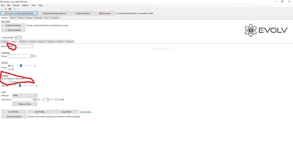

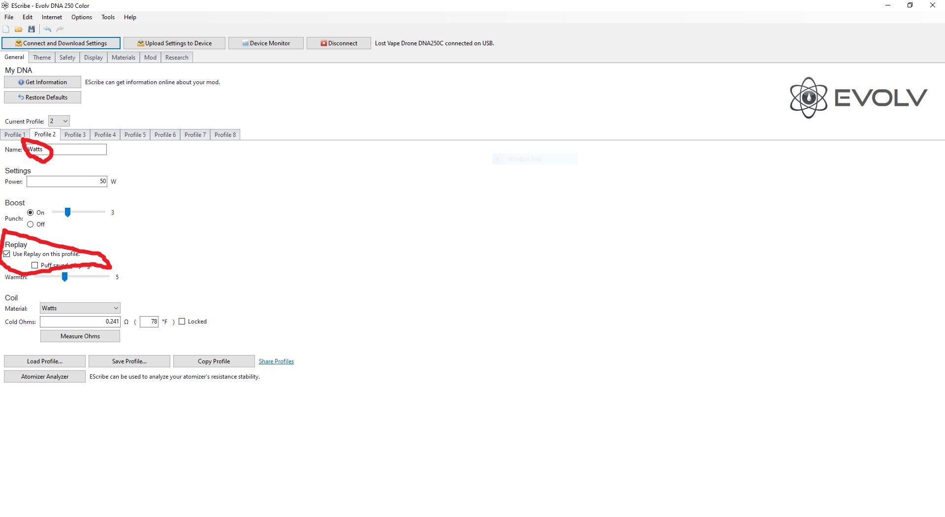

Ewolf Posted January 24, 2020 Report Share Posted January 24, 2020 Hallo Ich habe seit 2 Tagen einen DNA200C. Die Replay-Einstellung/Aktivierung habe ich gefunden. Benutze 2 Wotofo Verdampfer mit original Wotofo-Mesh zusammen mit dem Paranormal250C accuträger. Der eine Verdampfer speichert die Replay-Werte, der andere nicht, zeigt nicht die Speicherfunktion. Auch nicht nach wechseln des Siebes. Was kann ich tun? Grüße aus München Link to comment Share on other sites More sharing options...

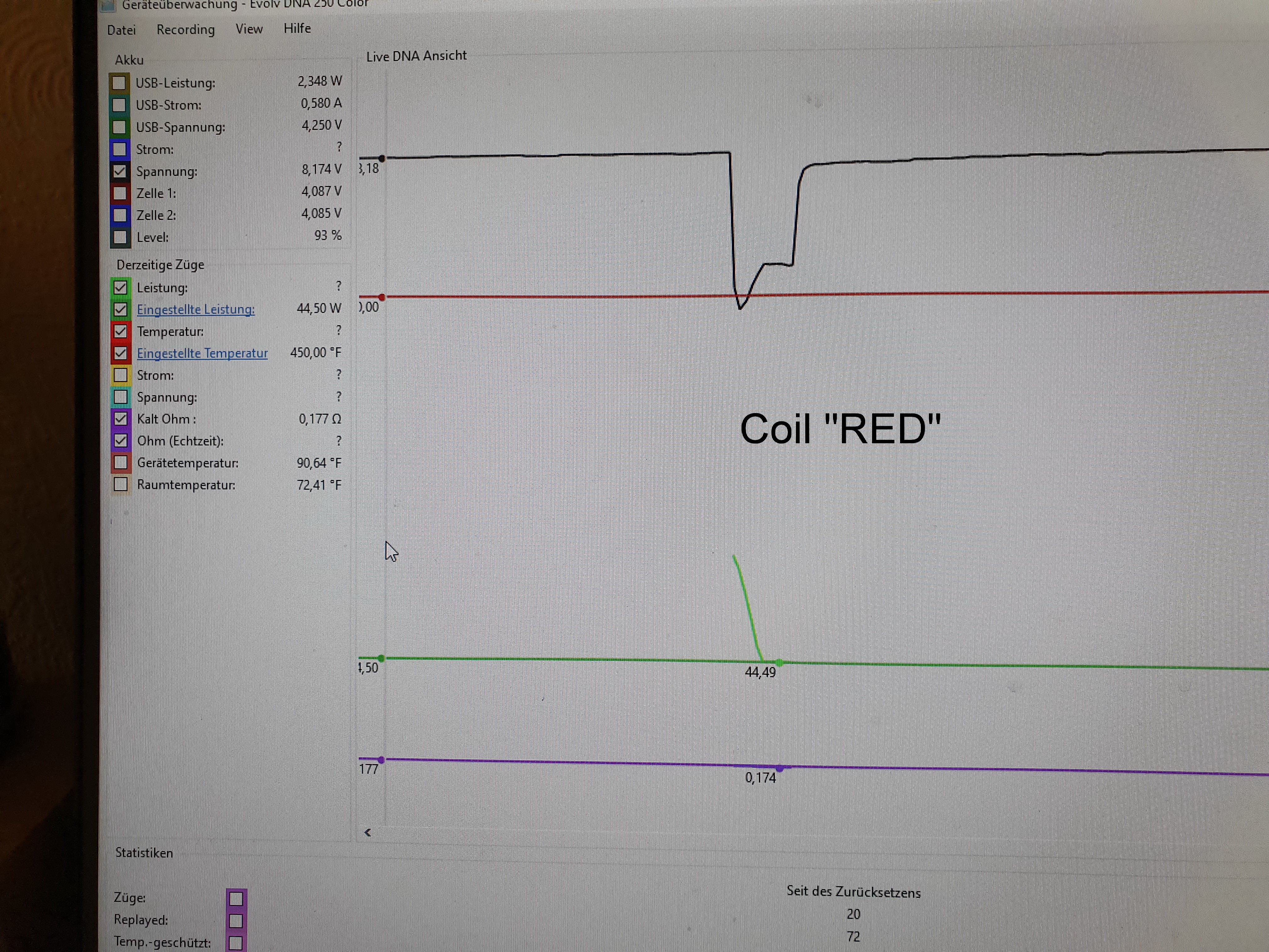

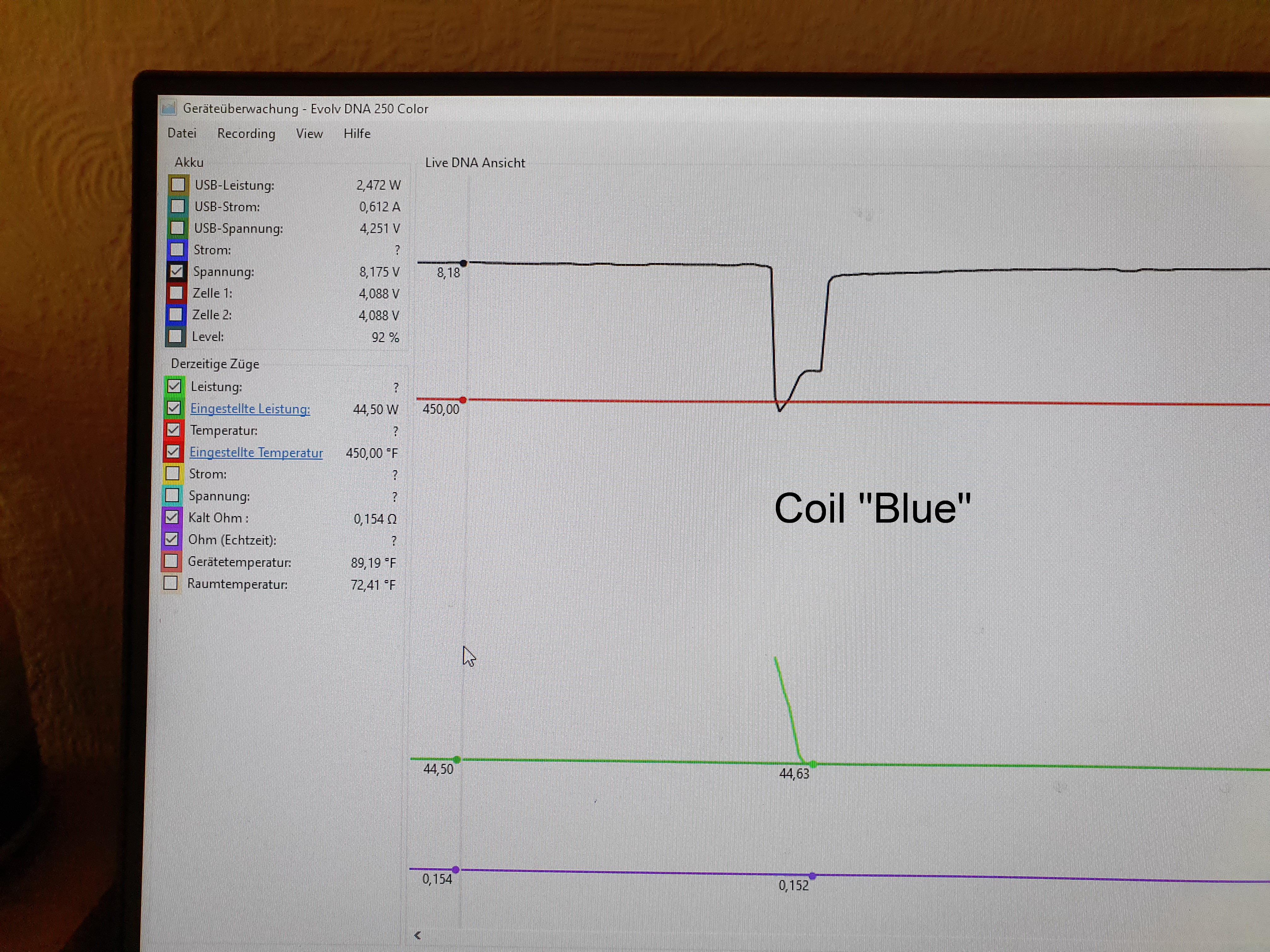

Ewolf Posted January 25, 2020 Author Report Share Posted January 25, 2020 Coil (red) save the settings... Coil (blue) save not the settings... Link to comment Share on other sites More sharing options...
dwcraig1 Posted January 25, 2020 Report Share Posted January 25, 2020 What I see is the coil material isn't changing resistance when heated. It might be Kanthal or Nichrome and that is not TC capable. Sometimes due to poor connections between the board and coil there is enough resistance change to trigger the Save Puff, but this is pretty much by accident and not by design. Try using Stainless Steel mesh/wire. Link to comment Share on other sites More sharing options...

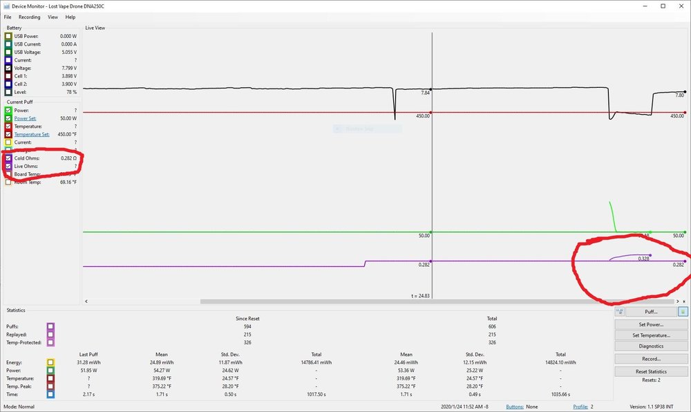

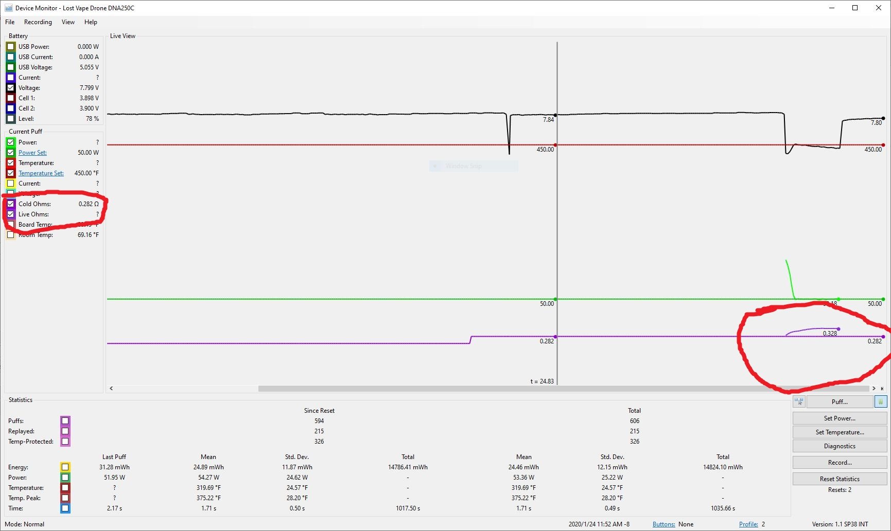

Wayneo Posted January 25, 2020 Report Share Posted January 25, 2020 What is the coil material? I see both coils actually dropping resistance when firing by a couple mΩ's. And you can use a sniping tool for decent printscreen. 1 Link to comment Share on other sites More sharing options...
