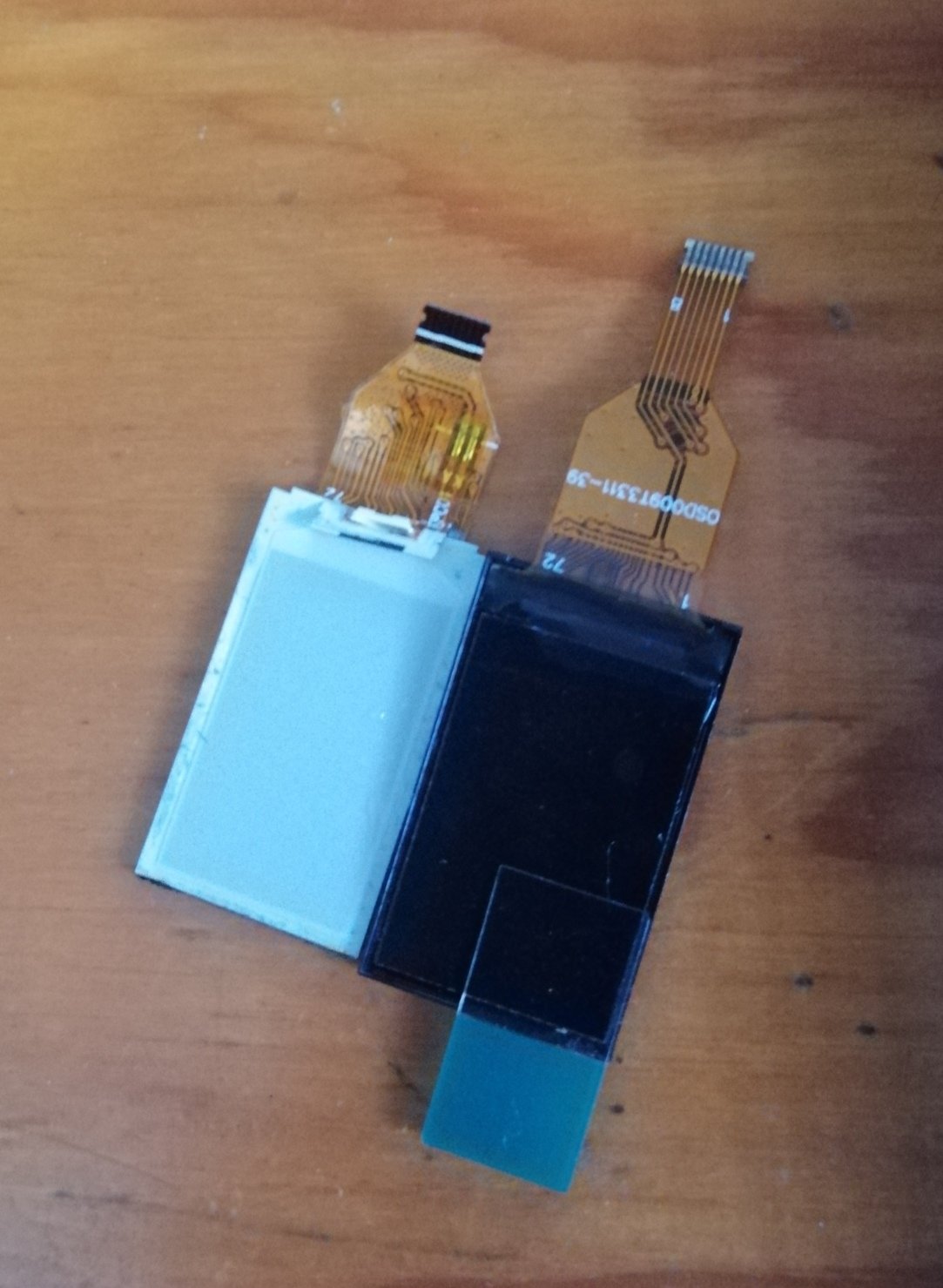

So I just received an screen replacement for my paranormal 250c after the original one broke for no  apparent reason (I literally woke up and it was like that).
The problem is that the flex on the replacement screen is too long and it won't fit, what can I do? :(

See page starting with "Installing the screen".....
https://downloads.evolvapor.com/dna250color.pdf
It starts out like this:
Installing the Screen
The TFT screen connects to the DNA 250C using an 8 pin ZIF socket and a flexible cable to allow for design flexibility. The cable can be bent or folded (once) but care should be taken to not apply tension or strain to the area where the cable attaches to the screen itself. Once the screen is mounted the cable should be tucked up under the screen and not out towards the fire button. Positioning the cable near the fire button can allow the mods fire button to contact the cable when pressed which will cause eventual screen failure. Only insert or remove the screen before the board is powered on.
