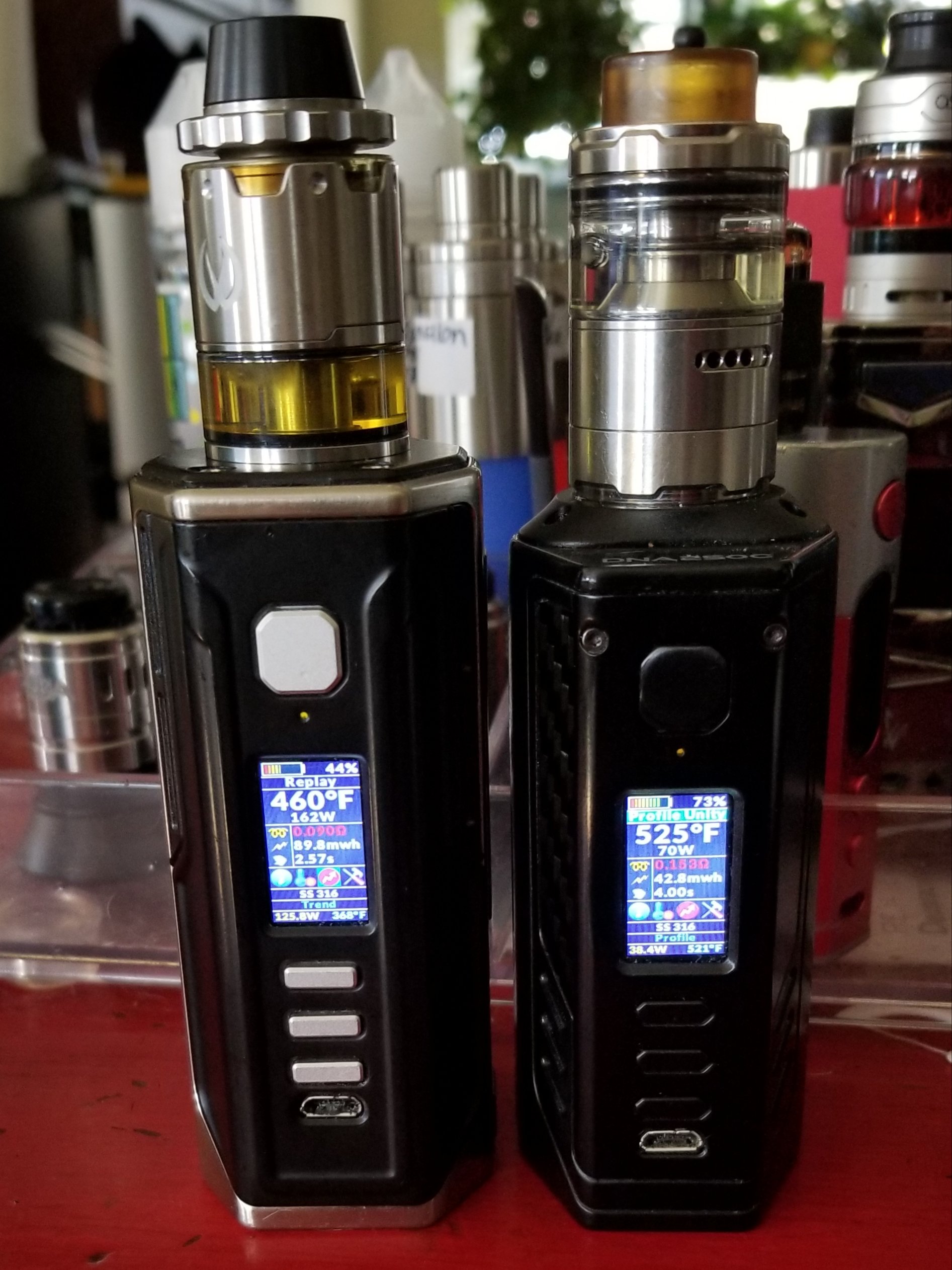

drjohnson61 Posted October 23, 2019 Author Report Posted October 23, 2019 (edited) Hi everybody and thanks for all your helpful insight! I have learned some things. I understood that replay was for TC but apparently not. I wrapped another set of coils, using the same SS316L wire, but I made these 6 wraps - 3mm id and installed them in my VV Pyro V2 RTA. They came out at 0.090 ohms and work great. They are working fine in Replay, or so I thought. After reading your replys, I looked a little closer at the trend. What I found was, that in temp control, using replay, the hit was not consistent at all, really. I switched the settings, as suggested, and its working fine. Thank you all, again, for your help with this. Edited October 23, 2019 by drjohnson61 Added photo
