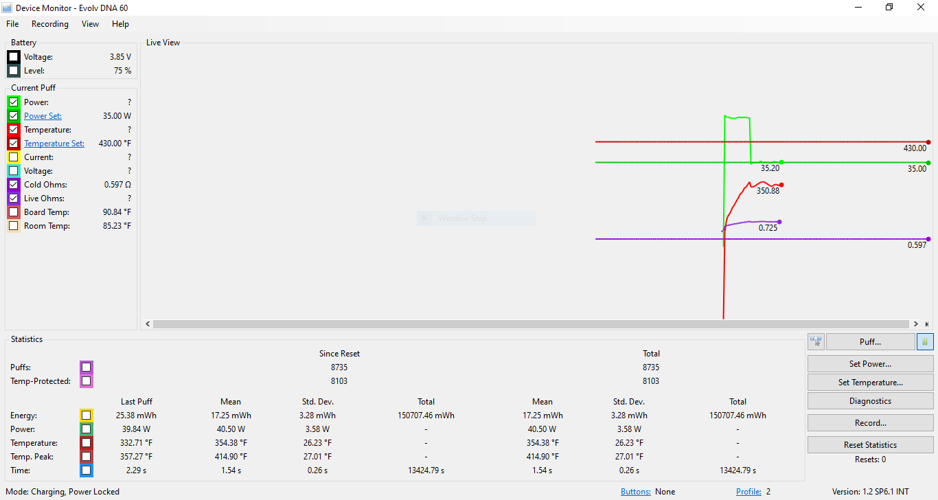

dwcraig1 Posted August 11, 2019 Report Posted August 11, 2019 When connected to EScribe it fires the coil normally? How about posting a screen shot of Device Monitor while firing? Like this one. 1

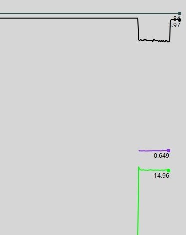

lupinehorror Posted August 11, 2019 Author Report Posted August 11, 2019 57 minutes ago, dwcraig1 said: When connected to EScribe it fires the coil normally? How about posting a screen shot of Device Monitor while firing? Like this one. you look familiar from ecf! thanks for replying. battery left out overnight. nothing changed. here's the screen grab of it firing on escribe

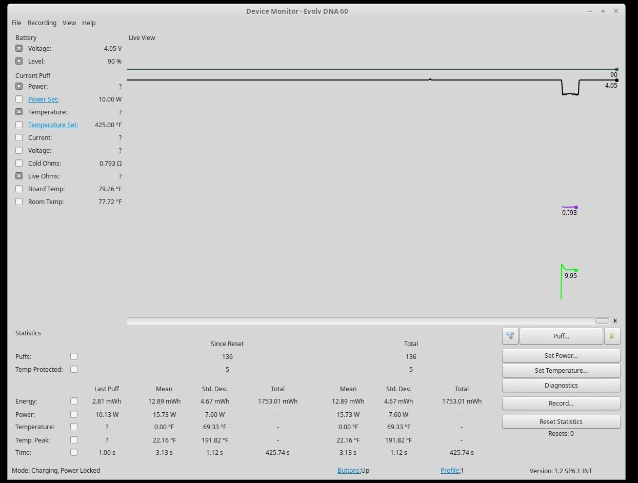

Wayneo Posted August 11, 2019 Report Posted August 11, 2019 5 hours ago, lupinehorror said: ... next time i used it...nothing. it shows the attached or hold up and down buttons to unlock power. After you held down those 2 buttons for a few seconds, could you change the watts? There are 3 different lock modes on the box. If you start with it not working and then plug in and start escribe - device monitor .......... what does it say down at that very last line on the left hand side? Your pic did not show it. DW's pic shows Mode: Charging, Power Locked.
lupinehorror Posted August 11, 2019 Author Report Posted August 11, 2019 34 minutes ago, Wayneo said: After you held down those 2 buttons for a few seconds, could you change the watts? There are 3 different lock modes on the box. If you start with it not working and then plug in and start escribe - device monitor .......... what does it say down at that very last line on the left hand side? Your pic did not show it. DW's pic shows Mode: Charging, Power Locked. hi. buttons do nothing. can't change wattage or anything else. device monitor says 'Mode: Charging'

Wayneo Posted August 11, 2019 Report Posted August 11, 2019 There you go. In your last printscreen, right there in the middle, see it says Buttons: Up. Then you said you set it to 15, but it fired at 29. Now at 60. Seems/sounds like you have a sticky button, at a minimum. All 3 actuators/buttons are external to the board. You'd need to remove the panel over the buttons, and clean it ou if there's any leakage or find what's causing the sticking. Good luck 3

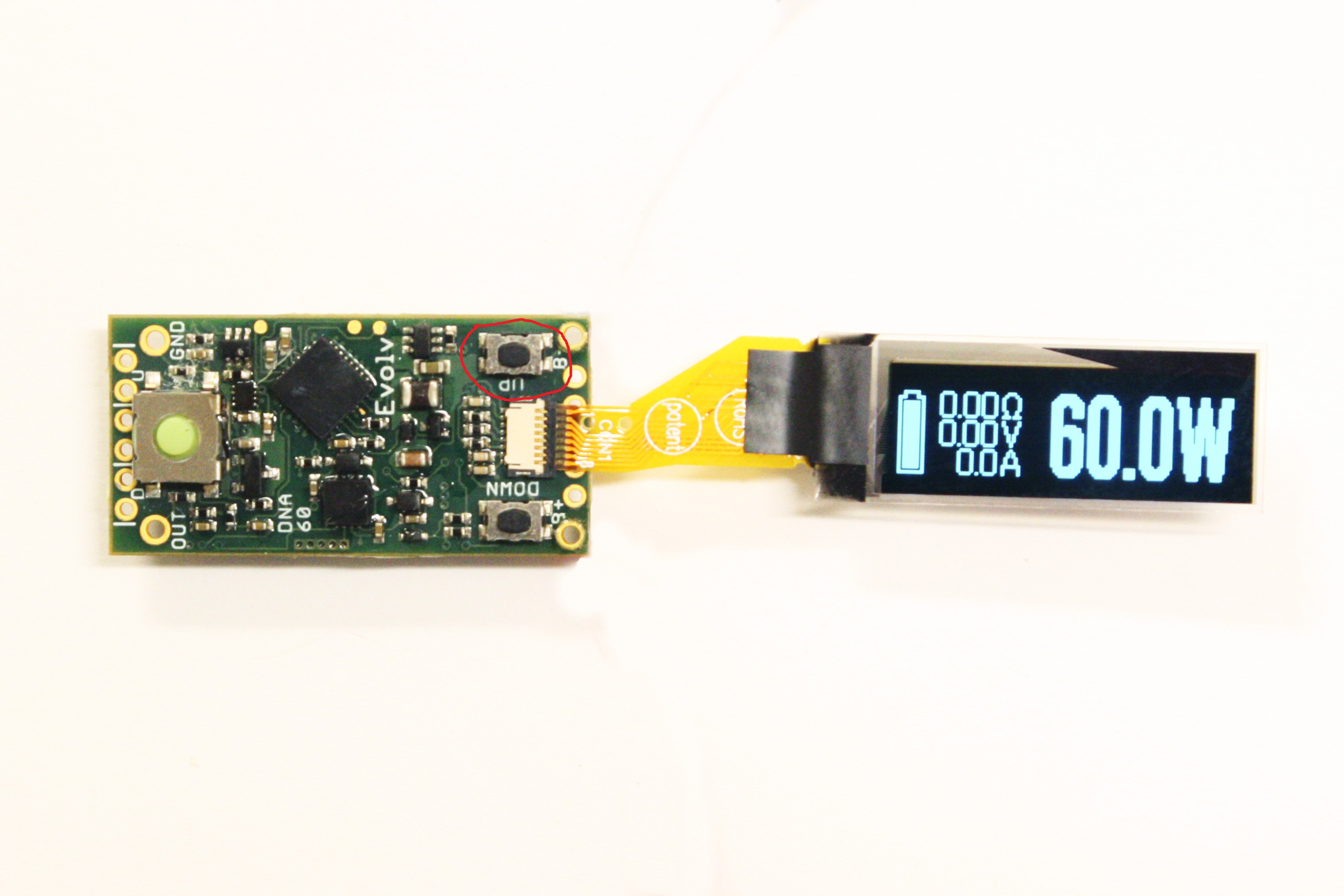

lupinehorror Posted August 12, 2019 Author Report Posted August 12, 2019 On 8/11/2019 at 7:23 PM, Wayneo said: With it apart (panel off), did you plug it in and see if device monitor still shows the button being pressed? The actual board buttons are on the fire button side, and wires are usually routed away from them. sorry for the delay. this is it apart and connected to escribe. evolv have replied to my ticket and i sent them the same file. 'Buttons: Up'. cheers. 1

Wayneo Posted August 12, 2019 Report Posted August 12, 2019 On 8/11/2019 at 2:23 PM, Wayneo said: The actual board buttons are on the fire button side, and wires are usually routed away from them. Did you check the above? DW circled the button for you in red? 1

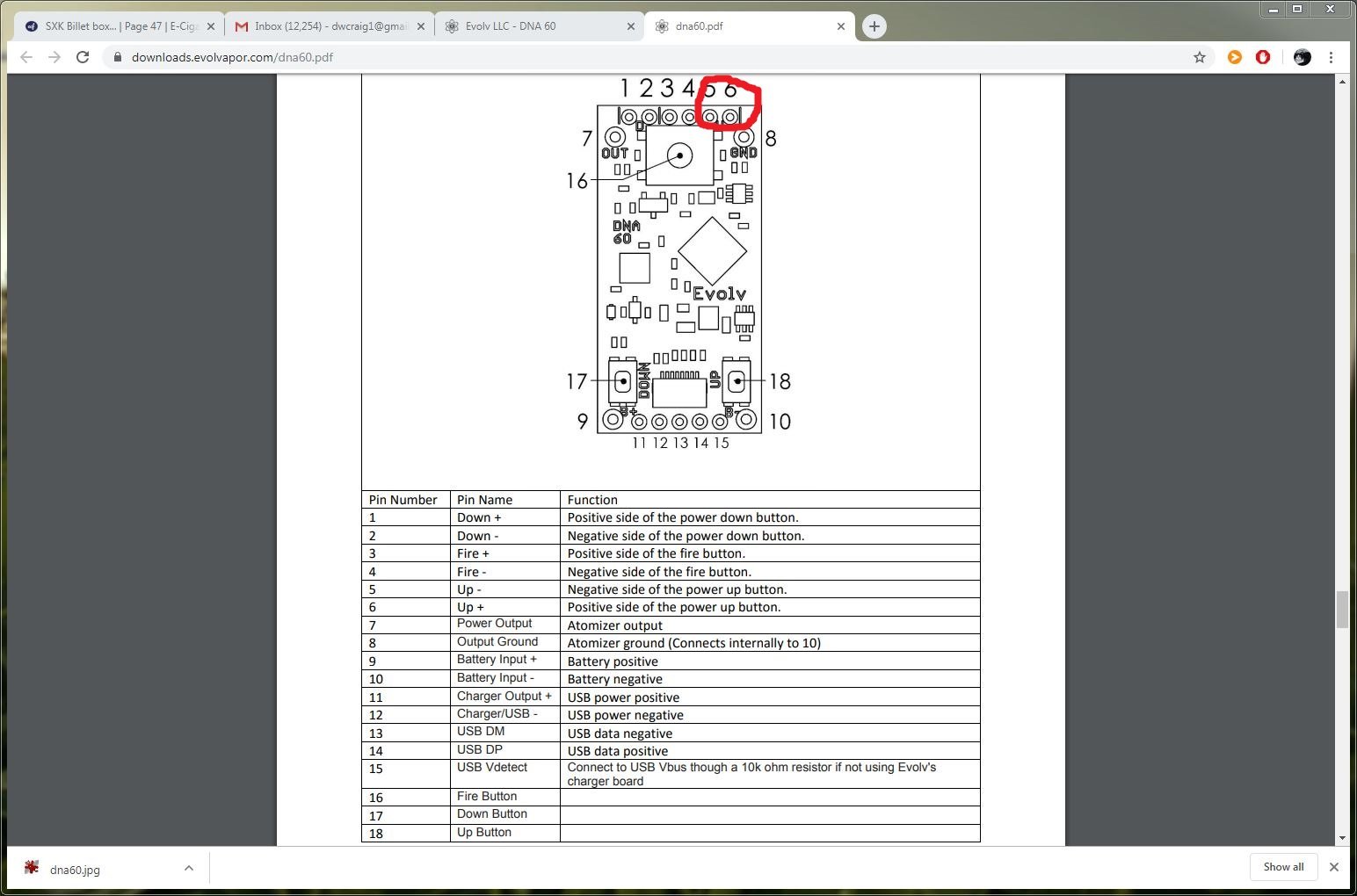

dwcraig1 Posted August 12, 2019 Report Posted August 12, 2019 Check to see if the button on the board is clicky. Look at 5 and 6 for solder bridging them. 1
lupinehorror Posted August 13, 2019 Author Report Posted August 13, 2019 13 hours ago, Wayneo said: Did you check the above? DW circled the button for you in red? i did but as i haven't accessed that board i couldn't do anything about it. please see below 12 hours ago, dwcraig1 said: Check to see if the button on the board is clicky. Look at 5 and 6 for solder bridging them. just got an RMA from evolv so will be taking the mod apart. will check the button when i've got it in bits. if i can fix it that way it'll save them and me some money. thank you both for your help and advice. it's not an area where i have a huge amount of knowledge.
