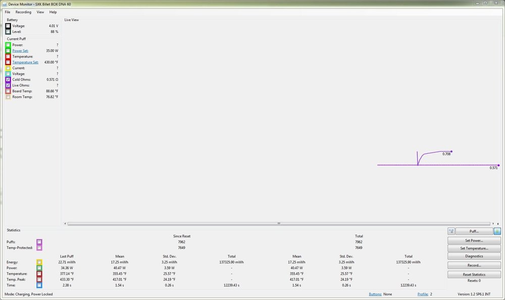

Lucasammy Posted July 29, 2019 Author Report Posted July 29, 2019 its giving me the chages. when i start to heat its starts at 0.080ohms and gets pretty fast to 0.089 something like that. ill give a try for wats material. ill let you know

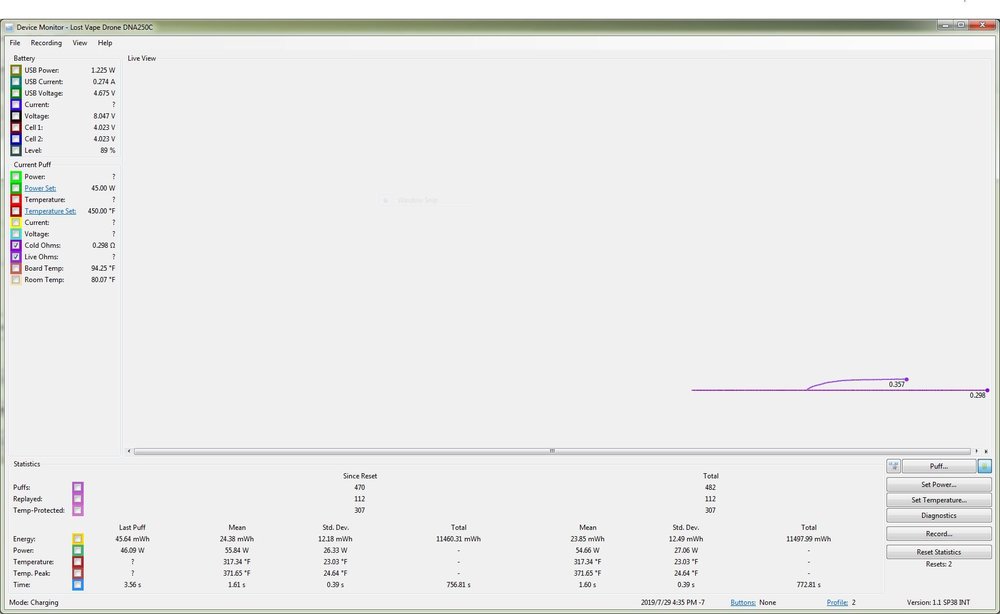

dwcraig1 Posted July 29, 2019 Report Posted July 29, 2019 0.80 to 0.89 is hardly any change, here is mine, while the resistance is much higher than your note the % of change here. You are getting a 12% approx. increase and mine is around 18%, I'm thinking that Replay should work with that. Mine here is with Kanger SS316lL drop in coil heads, I see more of an increase than expected, I'll post a screen using a SS316 Clapton on next post in a couple of minutes.

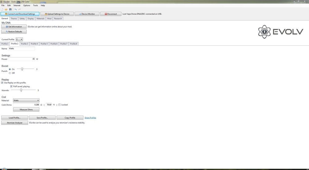

dwcraig1 Posted July 29, 2019 Report Posted July 29, 2019 I thought those Kanger coils had too much resistance change, here is SS316L Clapton on DNA250C. Also included is profile page. Replay is working.

dwcraig1 Posted July 30, 2019 Report Posted July 30, 2019 I decided to try replay in the SS316 profile. So I go into EScribe and check the box for Replay and upload the settings. I then try it out, no choice for Reply. I had checked the box in the wrong profile, That's corrected and Replay is working in the SS316 TC profile. Mistakes are easy.

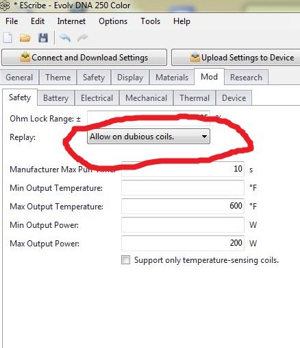

dwcraig1 Posted July 30, 2019 Report Posted July 30, 2019 You might give this setting a try, change to "dubious coils" and upload to device. Easy to try and put back if it doesn't work out.
Lucasammy Posted July 30, 2019 Author Report Posted July 30, 2019 When i put some coils kind a "higher resistance" then that it works! The print i post is of a dual coil 24g x2 wraped with 40g fused clapton ss316l. Using ss316 material on mode "replay" With replay enabled... so now i changed to only one coil and i just wicked. THE SAME COIL. I just remove one of those and re wicked... check it out
Lucasammy Posted July 30, 2019 Author Report Posted July 30, 2019 ive tryed to change to dubious coils! its works but... Why? these is not a dubious one... i think kkkkk
Lucasammy Posted July 30, 2019 Author Report Posted July 30, 2019 with onlt one coil and a little bit of more resistance its works. that should work on only viable coils. i dont should be like that... thats why im very very intrigued with that situation.
