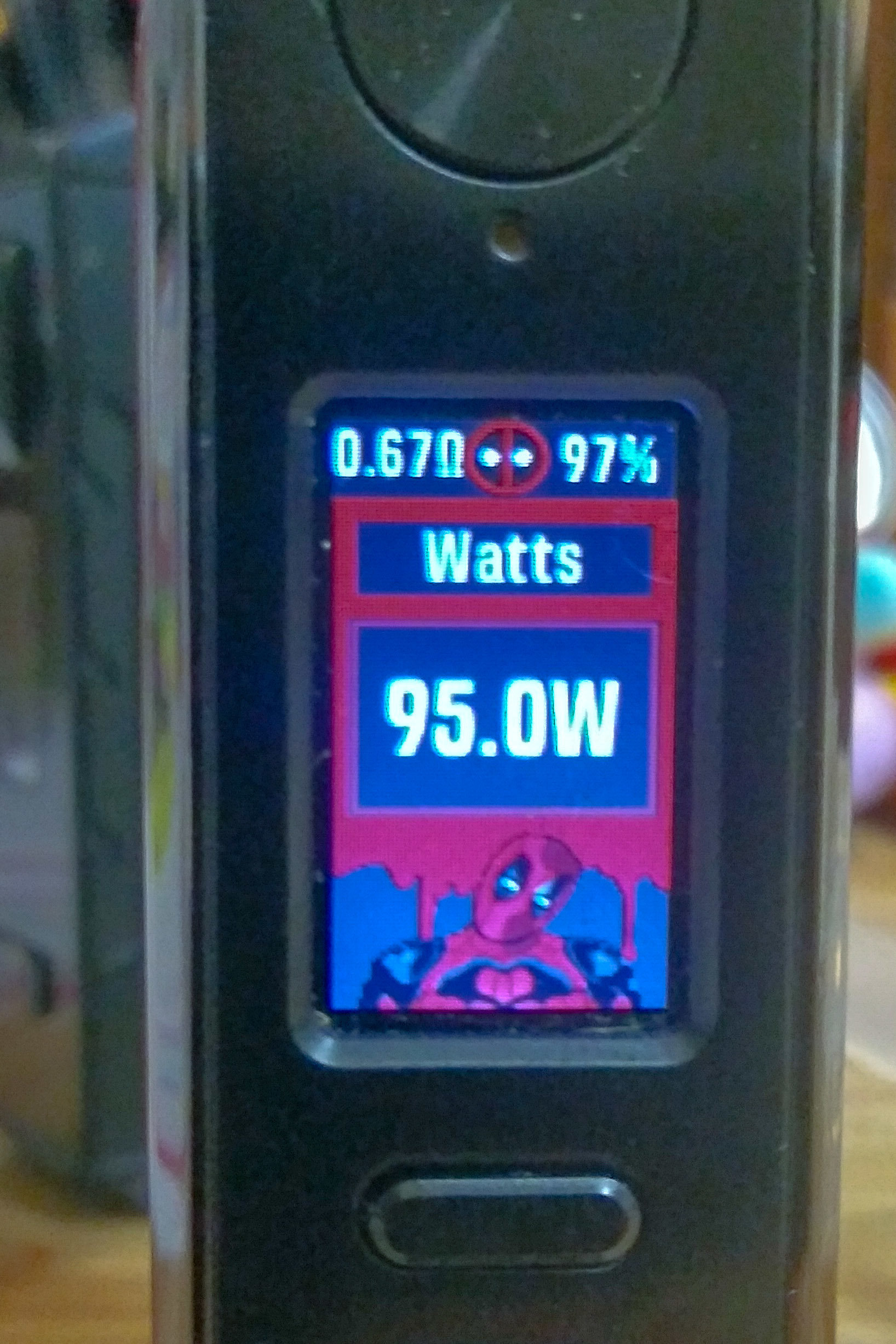

Kirschwilliam Posted June 22, 2019 Report Posted June 22, 2019 I have a paranormal 250c. I've recently noticed when I check my live volts and amps that my mod is not giving me my true wattage (I.e. Set to 95w and calculate to 81.7) if it was a wattage or 2 off I wouldn't mind but it's close to 15 watts difference.

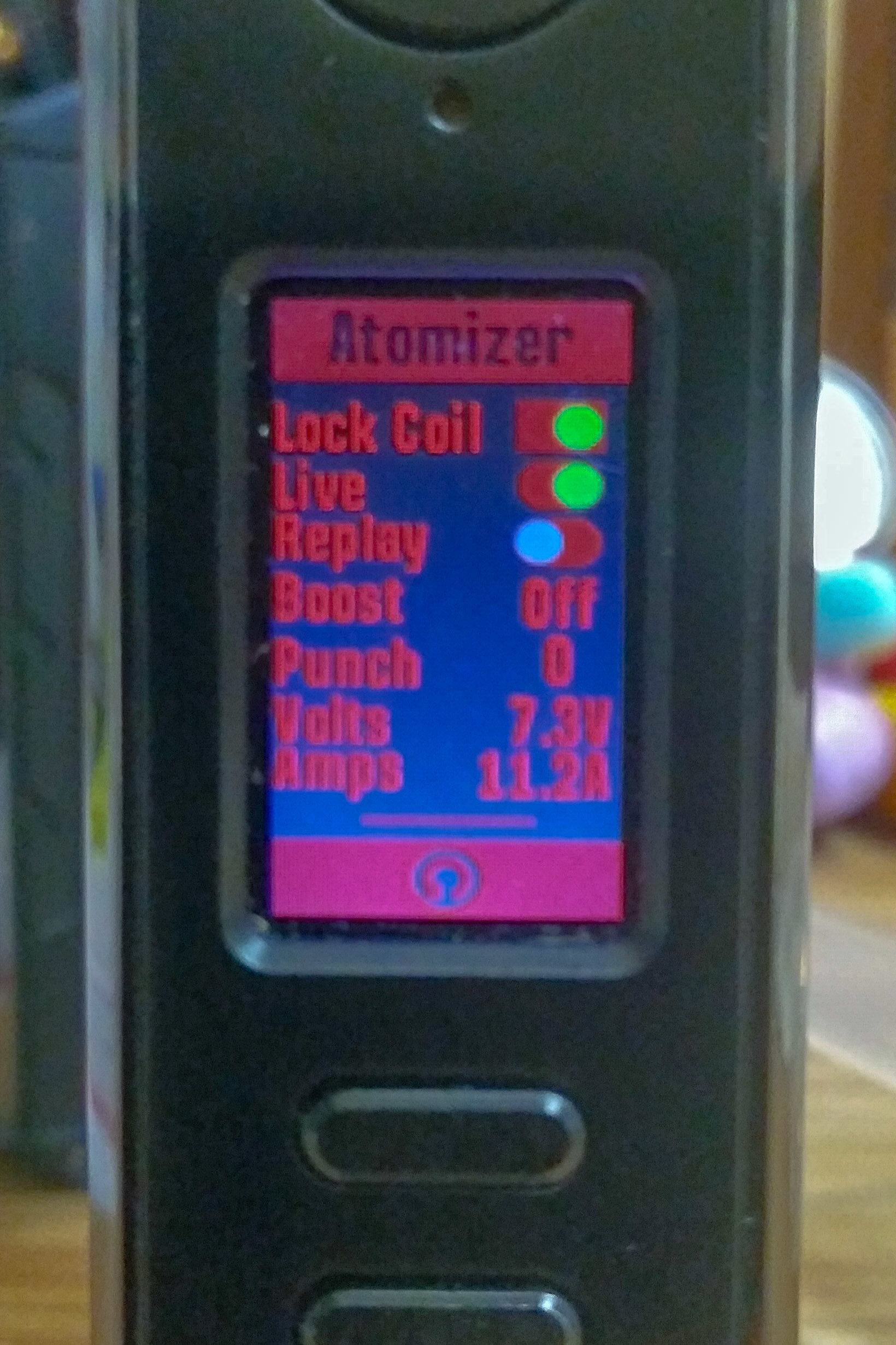

retird Posted June 22, 2019 Report Posted June 22, 2019 Are you vaping in TC or Replay mode, or wattage mode? Can you post a screenshot of Device Monitor (while vaping) so Live readings can bwe seen?
Kirschwilliam Posted June 22, 2019 Author Report Posted June 22, 2019 Regular wattage. No boost or punch. At the time of this picture with vape tool it ended up at 79 watts. Batteries are fully charged Samsung 20s.
VapingBad Posted June 22, 2019 Report Posted June 22, 2019 I think this because it is a 2 battery cell 250C and the resistance is causing it to hit the voltage cut off, the simple answer is use a lower resistance coil if you want 95 W as you can't add battery cells. This board is a step down converter and the data sheet has 10 V as the max output voltage, this would be with 4 battery cells, you only have half that and are getting 7.3 V so it is not a halving of the max, but I would put my money on this being your issue. If you lower the power so the voltage is < 7 V is it accurate then? if so my guess is probably right. ETA lower battery charge will negatively affect this, but it does not need to be an issue if you can lower your resistance enough. 1
Kirschwilliam Posted June 22, 2019 Author Report Posted June 22, 2019 VapingBad that was exactly the problem. I wasn't sure what the dual battery voltage cutoff was. Everything adds up right with 70 watts/ 6.8volts. Thank you and I appreciate the help. 1
