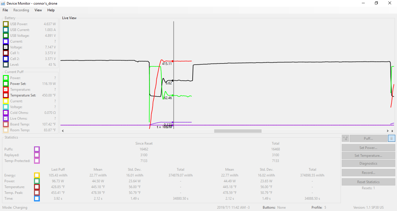

Drughugs Posted July 1, 2019 Author Report Posted July 1, 2019 It seems i'm having the same problem again, where i'm getting very inconsistent performance. Wouldnt work when i went to bed last night, screwed in the atomizer this morning and voila! it works. now, after repositioning the coils and rewicking, im getting extremely hot vapor again. Turned down to 415f and it produces vapor of the temp I like, feels like around 450-480. Is there something else i could be doing? It's all very frustrating because i've experienced how well it works, If only that would happen EVERY time
