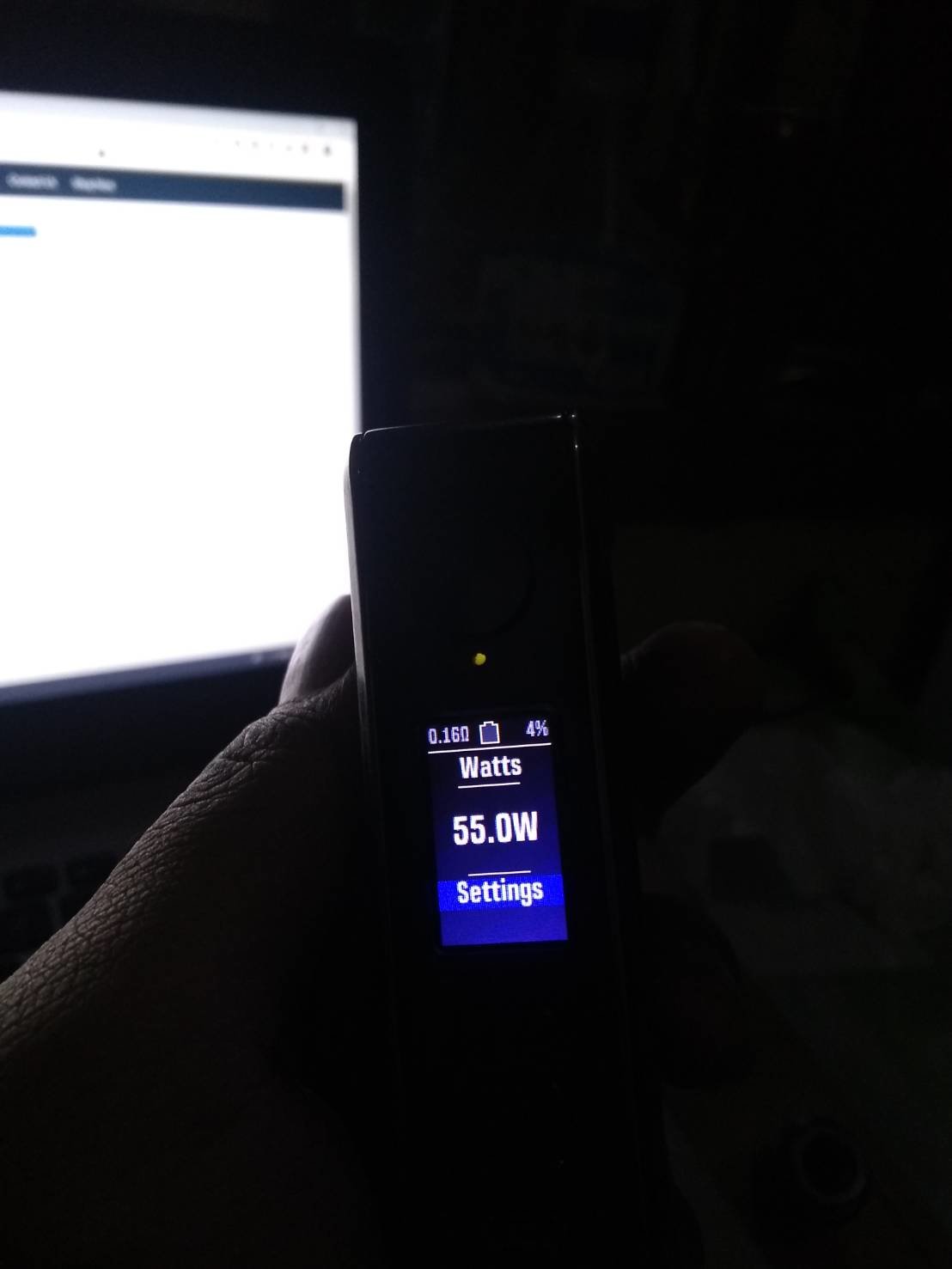

GyBear Posted June 9, 2019 Report Share Posted June 9, 2019 (edited) I've got my Paranormal DNA 250C from a vapeshop near my city. I Bought it at about 6 month ago. I got an issue with my Paranormal DNA 250C My Battery percentage in my device is detected at 4%, but when im check my battery at a charger and other mod, it shows 100%. I have change 4 battery and still, its show 4% on my device. The issue started at about 3-4 days ago, when my battery jump from 100% to 80%, 60% to 40%, 20% to 0%. I try a couple time pull and put it again the battery, it's always show a different percentage (sometimes it 70%, 60% or 40%), even though my battery is 100% (checked from my charger and other mod) Im using Sony VTC 5A Now i cannot vaping Is there any solution for my problem? Video from another user that have a same issue : Video Thanks Edited June 9, 2019 by GyBear Link to comment Share on other sites More sharing options...

GyBear Posted June 9, 2019 Author Report Share Posted June 9, 2019 (edited) On 6/9/2019 at 1:34 PM, dwcraig1 said: What does EScribe Device Monitor show for the voltage of each cell? Expand here you go sir At 1st Picture, its show the battery at 54%, 8V, 4.1V (Cell1), 3.9V (Cell2) After a few minutes, the battry drop to 24%, Cell 1 is stay same, but Voltage and Cell 2 got up and down, but its normal again (8V and 3.9V at Cell2) And the last picture, suddenly the battery goes to 80%, but the Voltage, and the cell remain same Edited June 9, 2019 by GyBear Link to comment Share on other sites More sharing options...

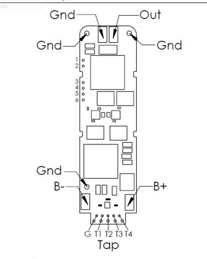

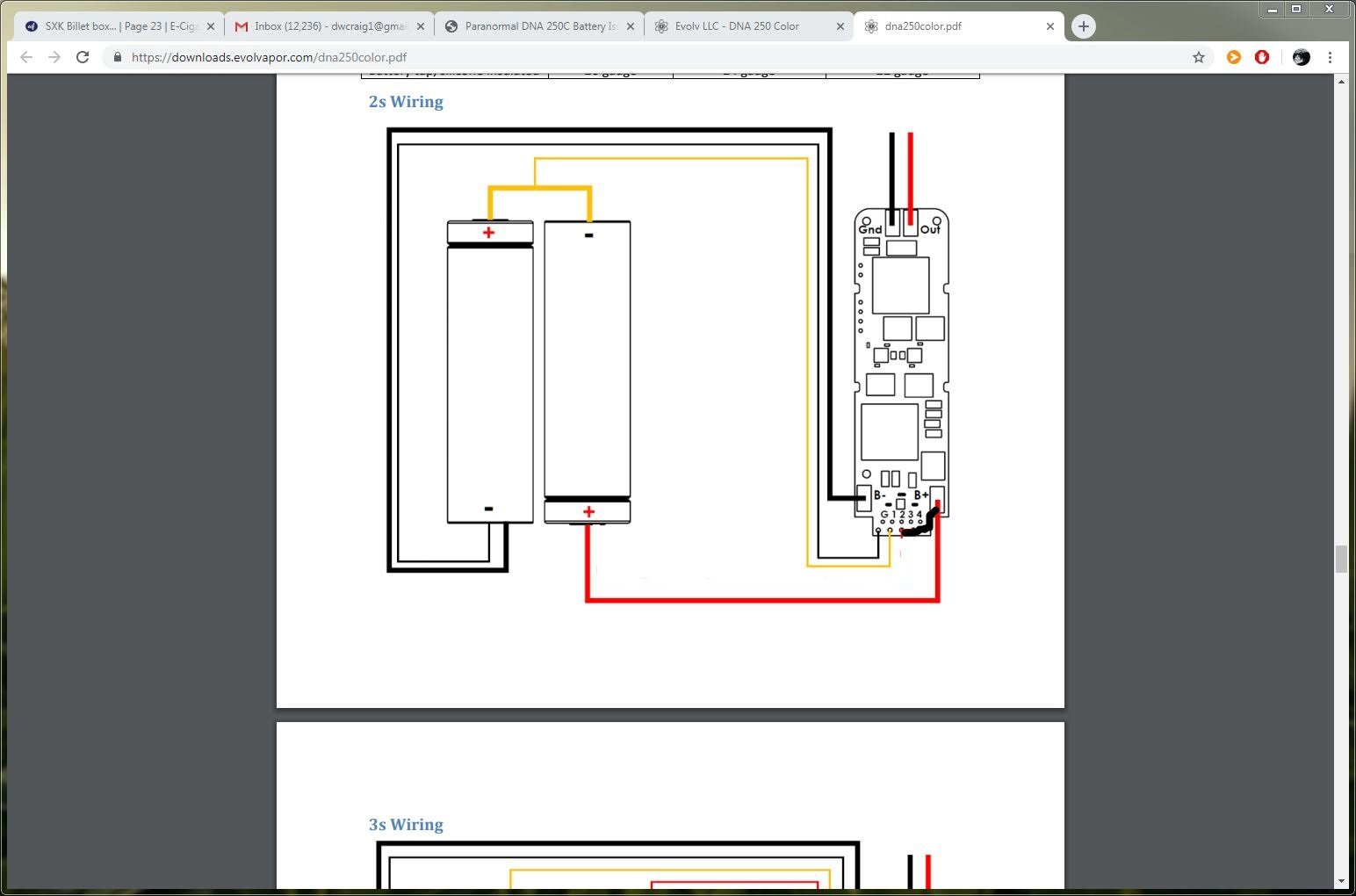

dwcraig1 Posted June 9, 2019 Report Share Posted June 9, 2019 The voltage of the cell are measured via the balance tap at the bottom of the board. Note for 2S #2,3 and 4 are bridged to positive of cell #2, this is the preferred method. I'm not sure how Lost Vape wired theirs. Another way is to bridge batt + with #2.3 and 4, some manufacturers do it this way. I think that you will find your problem with the connection between cell #2 and tap #2 regardless of which way that they wired it. Example would be a poor solder joint, ect. 1 Link to comment Share on other sites More sharing options...
GyBear Posted June 9, 2019 Author Report Share Posted June 9, 2019 (edited) On 6/9/2019 at 2:27 PM, dwcraig1 said: The voltage of the cell are measured via the balance tap at the bottom of the board. Note for 2S #2,3 and 4 are bridged to positive of cell #2, this is the preferred method. I'm not sure how Lost Vape wired theirs. Another way is to bridge batt + with #2.3 and 4, some manufacturers do it this way. I think that you will find your problem with the connection between cell #2 and tap #2 regardless of which way that they wired it. Example would be a poor solder joint, ect. Expand Sorry im bad at english. So maybe the solution is, disassemble the device and check the positive connection/wire of batt 2 to the board, right? Is there any tutorial or video for dissamble the paranormal dna 250c? oh and, where excatly is batt 2 position? (the one that close to the board, with positive in the bottom, or the second one that have positive in the top ? ) Edited June 9, 2019 by GyBear Link to comment Share on other sites More sharing options...
dwcraig1 Posted June 9, 2019 Report Share Posted June 9, 2019 https://downloads.evolvapor.com/dna250color.pdf Another choice would be to send it to Evolv for repair, start here: https://helpdesk.evolvapor.com/index.php?a=add&category=1 Link to comment Share on other sites More sharing options...
