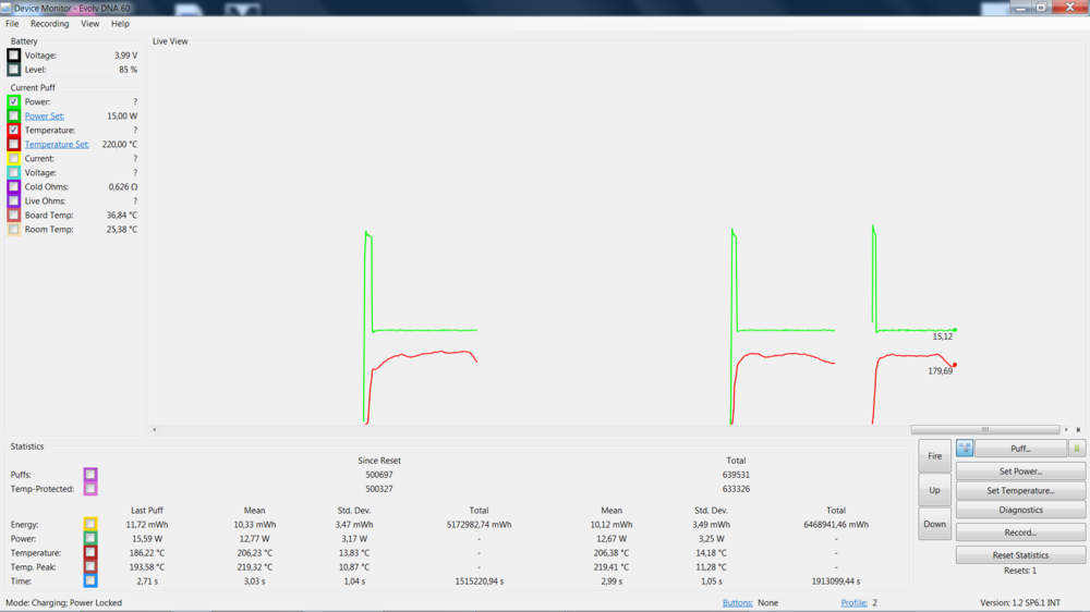

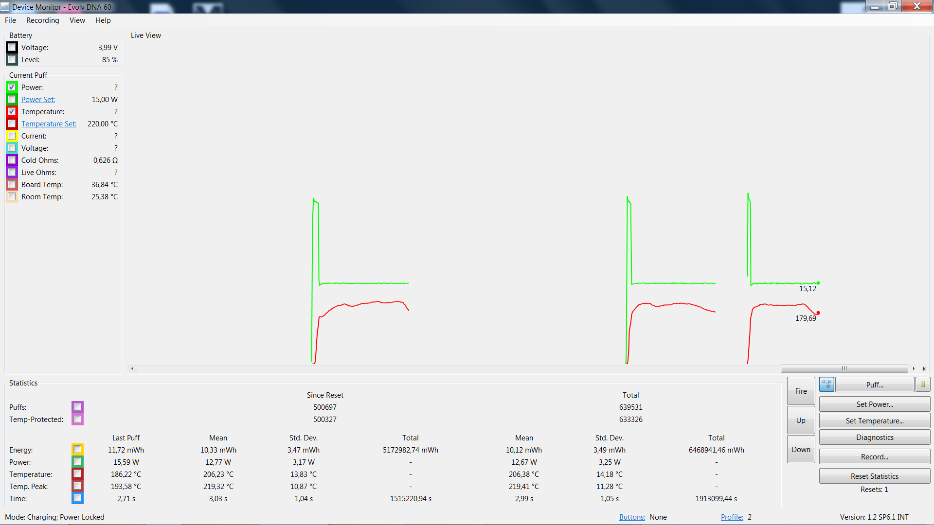

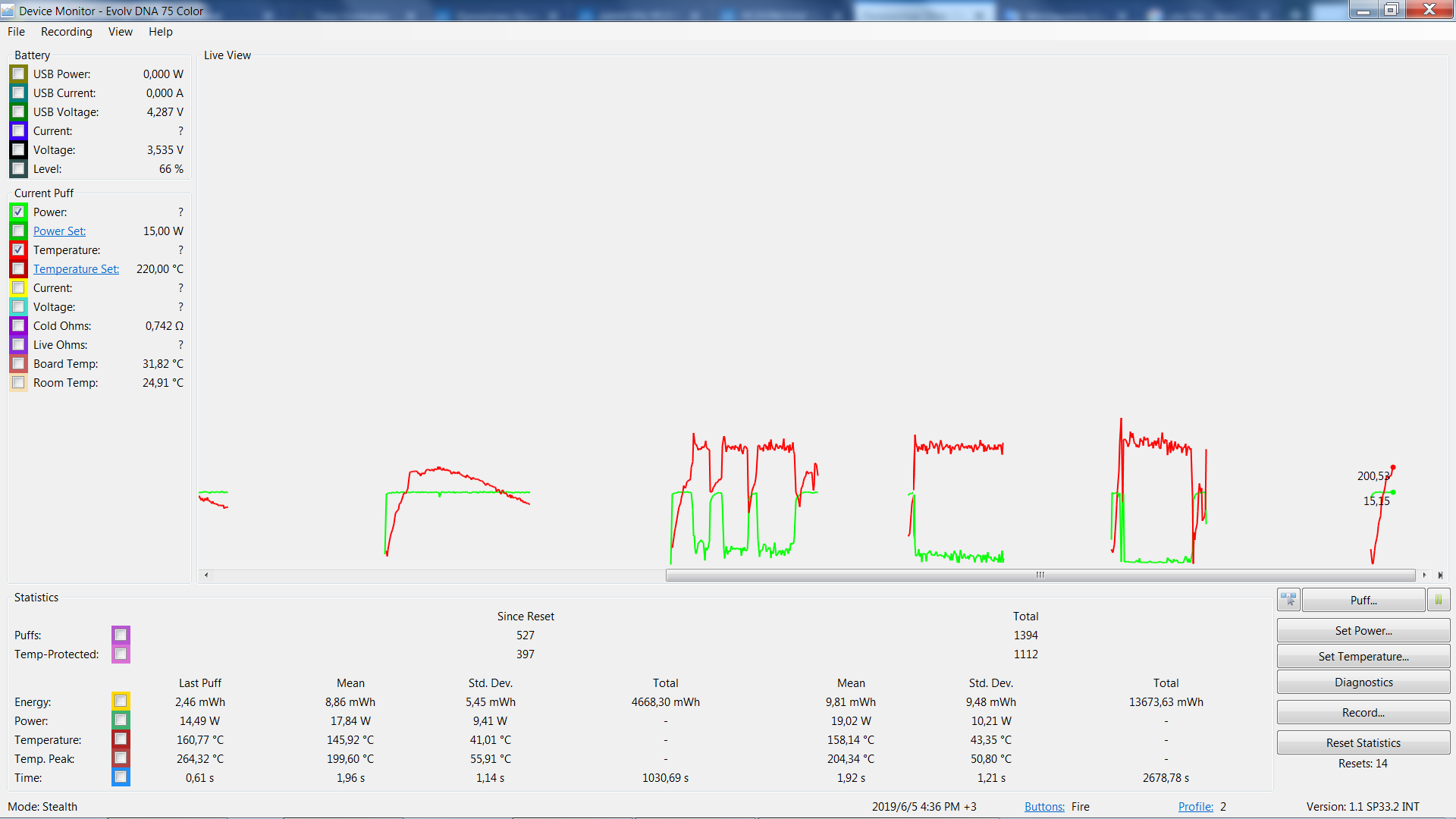

lproliris Posted June 5, 2019 Author Report Posted June 5, 2019 3 ώρες πριν, zark είπε: Я не все понял из дискуссии, но у меня была подобная проблема из за того, что было установлено слишком большое значение мощности нагрева катушки в режиме ТС. При этом в первые моменты нагрева аккумуляторы проваливались по напряжению настолько сильно что мод переставал нагревать катушку( было установлено 250 Ватт, при том что на нагрев катушки использовалось не более 30 Ватт) . По ощущениям было похоже на то, что Вы описываете в своих вопросах. Вы нигде не упомянули про сообщения которые выдает плата в поле Статус. Thank you for your time If I understand correctly, you are asking if I enter high power, if I notice a considerable voltage drop in the battery and what the settings of the mod are. Correct me if I' m wrong I do not think the batteries are draining fast. I have it at 15W but tried 30 and 40 as retird sugested, with no difference in the graphs but with hotter and more steam production. Not burned. This is the DNA 60 Here is DNA75c and what happens when the atomizer is heated. It starts ok, after a few puffs it thinks the coil temperature is high and therefore does not produce steam and finally it cuts off when fire button is pressed This is with the DJLsb Vapes 316L profile. I also use the 316L elite from steam and the standard from the escribe which I read is not good. There are also differences between those profiles, but the big picture is the same. If someone has a stable and correct 316l profile tested to recommend, I would be much obliged. Just to eliminate one parameter. Thank you.
lproliris Posted June 5, 2019 Author Report Posted June 5, 2019 17 ώρες πριν, dwcraig1 είπε: From here I can only guess but it sounds like a connectivity problem with the 510. Use Atomizer Analyzer to get an idea if this is the case. Note when the connection starts to stop getting lower vs how many turns are left till the atty bottoms out onto socket. Compare the two mods perhaps. The desired situation is the connection is stable about a least a turn before bottom. It looks that the problem is this. I have to tighten it well to achieve stability AND lower resistance value. The resistance changes by about 0.1Ω when I start unscrewing. After cleaning, screwing and unscrewing many times I got a number close to the one I wanted and it works well since. (5 hours). Previously, I turned it till bottom, saw the value being stable for a minute and I thought that was it. What was happening afterwards without me realising is that due to some movement or temperature change, the values changed. But I was watching the device monitor. So, the value has to be low as well. Thank you for your help. The problem remains, the mod is unreliable. From now on I will have to have it connected to a pc and play with the 510 in order for it to work? Is there any way to fix it? Buy a new 510 and solder it or something? I'm afraid I will damage the insulation but if necessary, I'll do it. 1
