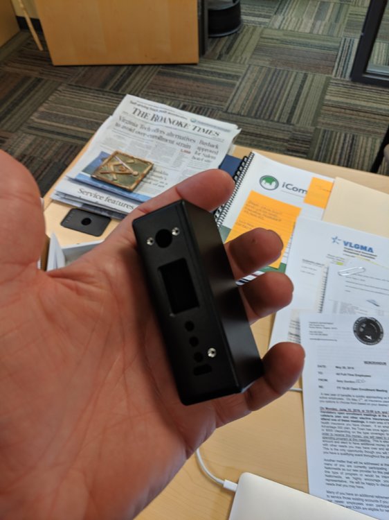

blueridgedog Posted June 2, 2019 Author Report Posted June 2, 2019 Made a nice smallish mod. Going to put a 250 in one with a 3 cell lipo. 1
dwcraig1 Posted June 2, 2019 Report Posted June 2, 2019 A DNA75C with it's up to 100 watt boost (INT firmware) and a 21700 is a pretty capable device. That's a nice one.
