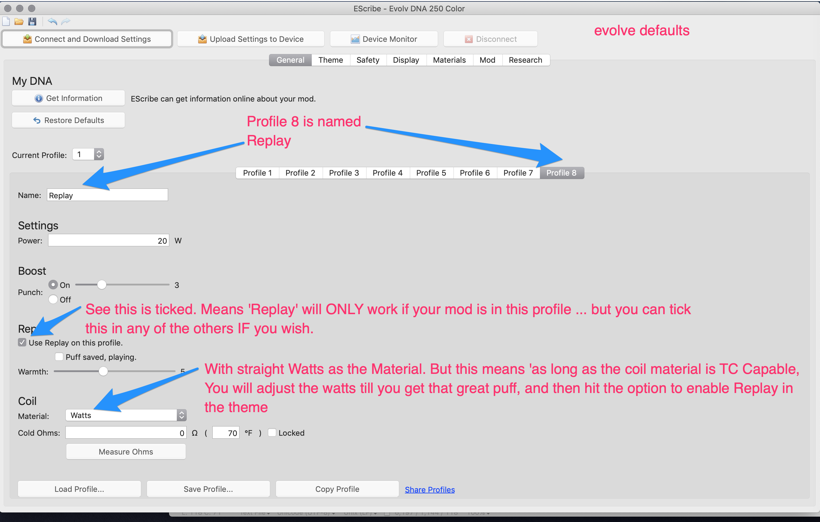

Wayneo Posted May 27, 2019 Report Posted May 27, 2019 Well, let me ask you a few questions, and tell you my assumptions. Do you have any C mod with Replay working at all? And do you want that theme on all your mods? Hopefully my printscreen will get you going with Replay. My assumptions would be; You have both C and non color mods, as well as 75's and 2xx mods. All of mine are setup the same (material or feature wise) except for the few unicorns. I think all you need to do is ensure all your mods are at the latest firmware included in SP19. If you have been jiggying with your Profiles, at least you now know how to set one up. 1

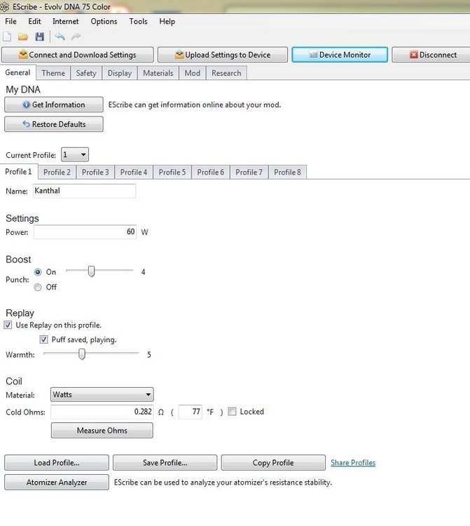

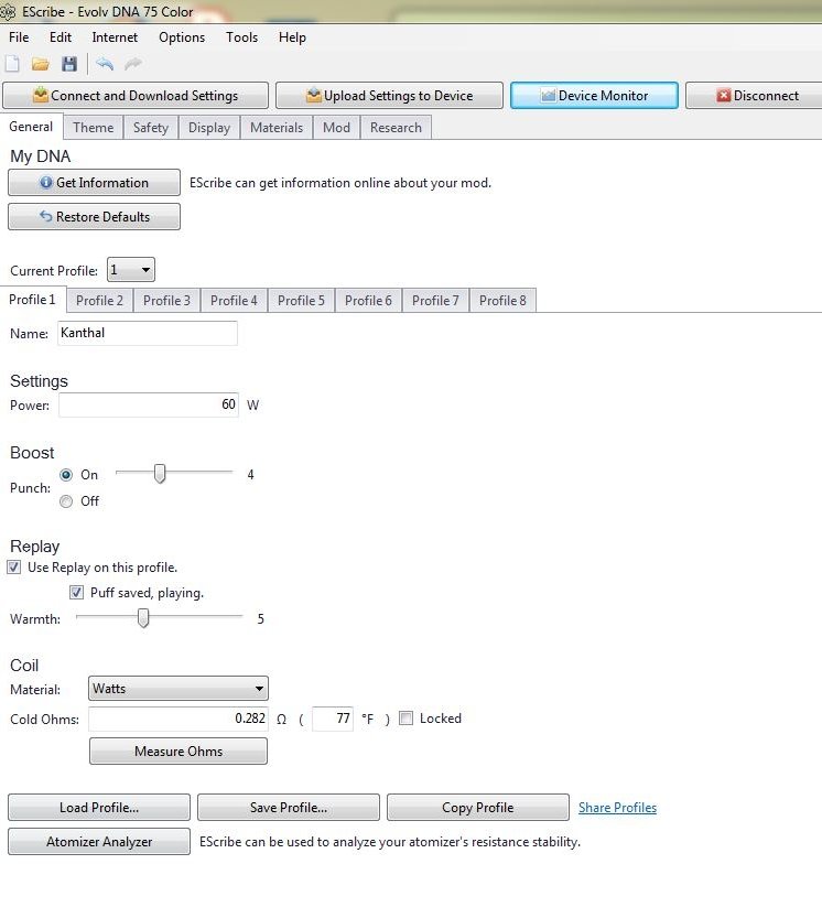

dwcraig1 Posted May 28, 2019 Report Posted May 28, 2019 I would think that either EScribe or your version of firmware is not the required international version. Here is what the page with profiles looks like/

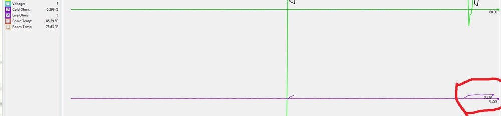

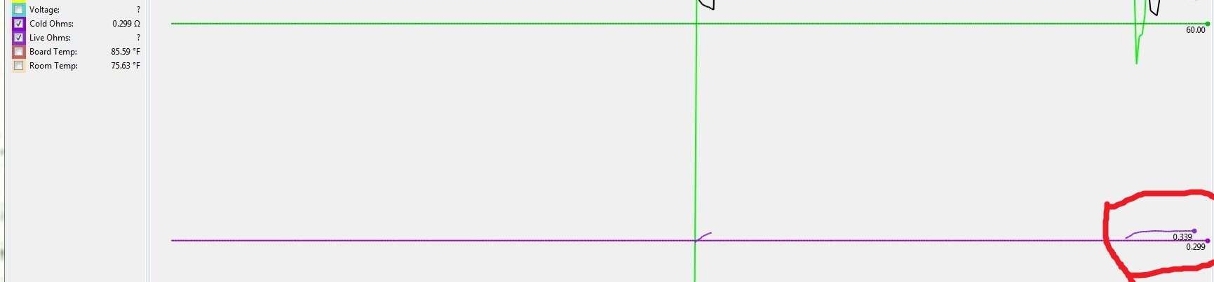

dwcraig1 Posted June 1, 2019 Report Posted June 1, 2019 For the purpose of uploading the theme to this forum just use "Save Theme" on Theme tab page, no need to go into Theme Designer. It should default to the correct file type (ecigtheme), name it what you choose to. Save it to where you can locate it and upload it with your post to this thread. Using Device Monitor with device set on the theme for Replay select cold and live ohms from the tick boxes and fire it. Make sure it is showing an increase in resistance when the coil is heated or Replay won't work. This will establish that your wire is indeed TC capable providing the resistance changes from cold to hot. If there is no change then the wire is Kanthal or Nichrome which will not work for Replay. It looks like from your setting that with a proper wire you should be getting the option to start Replay after firing device.
