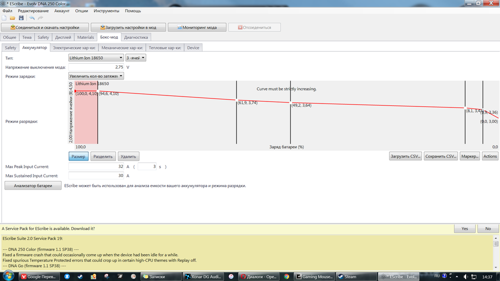

Here is a description of the battery test.
10 минут назад, StrahmNoMore сказал:

Posted
Hi, this is very easily solved, in the setup program on the graph of the batteries, pull the first slider down a little to set the voltage to 4.1, then the charge display will be 100%, but in general this is normal

@Gavnaf
I see your Cell Soft Cutoff is set to 2,75 V.
Mine is set to 2,5 V (using 3x VTC5).
My settings are based on the Sony Konion Datasheet from Mountainprophet (http://www.dampfakkus.de/akku_liste-nach-marke.php).
Based on that database your settings should be:
Cell Soft Cutoff: 2,5 V
Max. Peak Input Current: 24 A
Max. Sustained Input Current: 20 A
Edited by Lanzarotechris
add infos, correct typo
  • Thanks 1
Posted
Lanzarotechris
You are very attentive, but there is a nuance, I launched the program on the standard settings, without the device). Regarding the voltage off: I see no reason to indicate this item, the battery will no longer give me the power I need at a voltage of about 3.3-3.4
Posted
Ok, Just wanted to make shure that your Samsung 25R are not working over the tolerance of what they made for.Lots of people don't make shure to stay within the given limits and end up in the news because their batteries exploded 😉
That gives vaping bad press and we won't that... as there is already too many BS going around from the pharma and tobacco industries.
