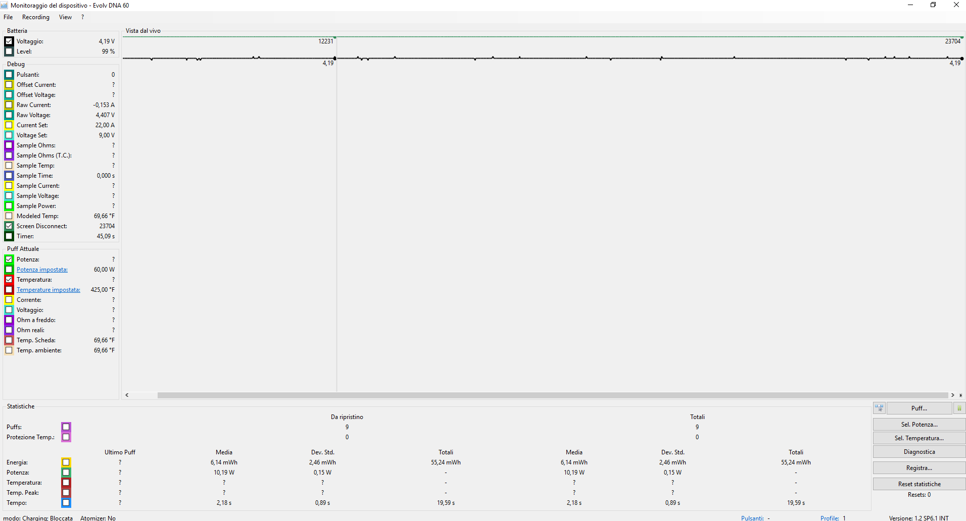

Capobuf Posted February 13, 2019 Report Posted February 13, 2019 Hi! I've 4DNA circuit with similar problem: 1x DNA75 Works but No Screen 1x DNA 250 With "Warranty Service" message and Screen Ok 1x DNA 250 with No Screen But Works 1x DNA 60 with No Screen but works When i say "Works" i mean that with escribe i was able to set te power and vaporize. I read a lot, and i have some electronics skill, i want to fix but the shipment cost from italy it's very high. (Even all circuit come from a branded box like vaporshark and lost vape) So, i want to know a possible troubleshooting way, or a workaround! In escribe, with a good screen connected in the board, i have a big value that increasing (in Monitoring Device with Debug Mode ON). With the board that show "Warranty Service" i see that this value it's 0!

Capobuf Posted February 18, 2019 Author Report Posted February 18, 2019 Here the full printscreen. 22 minuti fa, kingoffoxez ha scritto: Just incase ,have you tried holding down the fire and down buttons at the same time for 5 seconds on all the mods with a screen that is not working? Yep, stealth mode it's the first idea i had, but no luck...
Wayneo Posted February 18, 2019 Report Posted February 18, 2019 @Capobuf Yup, the old screen disconnects value should be zero. The ribbon cable was probably pinched by the fire button. You can put a bend in the new one's or ensure their placement isn't interfering.
