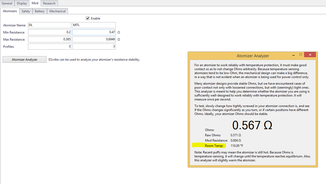

techbearus Posted January 18, 2019 Report Posted January 18, 2019 On my DNA Go, I haven't been having much luck liking the vape on either .5 or .25 pods. It just feels like they have a low ramp up and eventually burn out as I am forced to take longer pulls. Just checked in the Atomizer Analyzer and noticed that the Room Temperature is at 110F, which is completely way off (actual room temp is 70F). I am wondering if this is an issue and maybe causing poor performance. I tried to do hard reset, reboot and soft reboot, but nothing seems to make this temperature go down. Even in the Device monitor the Board temperature is constant around ~122F Anyone who can chime in and let me know what can I do about this.

Wayneo Posted January 20, 2019 Report Posted January 20, 2019 Seeing Room Temperature in Atomizer Analyzer is probably just an artifact/holdover from the more capable boards. It's a pod focused board with Replay. Replay is NOT TC so an accurate room temp is not necessary. Room temp is not even shown in Device Monitor. Boost will certainly decrease the ramp up time for your pod, possibly to the detrement of pod life. You're certainly fine if you want to submit a ticket to Evolv, but I think your mod is fine. Let us know if you get a different answer. 1
techbearus Posted January 20, 2019 Author Report Posted January 20, 2019 4 hours ago, Wayneo said: Seeing Room Temperature in Atomizer Analyzer is probably just an artifact/holdover from the more capable boards. It's a pod focused board with Replay. Replay is NOT TC so an accurate room temp is not necessary. Room temp is not even shown in Device Monitor. Boost will certainly decrease the ramp up time for your pod, possibly to the detrement of pod life. You're certainly fine if you want to submit a ticket to Evolv, but I think your mod is fine. Let us know if you get a different answer. Makes a lot of sense. I realize that Go board is resistance based instead of temperature in Replay. Thank you for your insights.
Wayneo Posted January 20, 2019 Report Posted January 20, 2019 Hey @techbearus Now I actually have a thought/suggestion. Leave all your power settings the way they were, but increase the Max resistance value to 0.73 or 0.74 I don't own an Orion so I'm not sure if the 'Max' refers to the starting cold resistance, or the max it will allow the coil to reach. Lemme know if I'm a quack. Fingers crossed for you.
