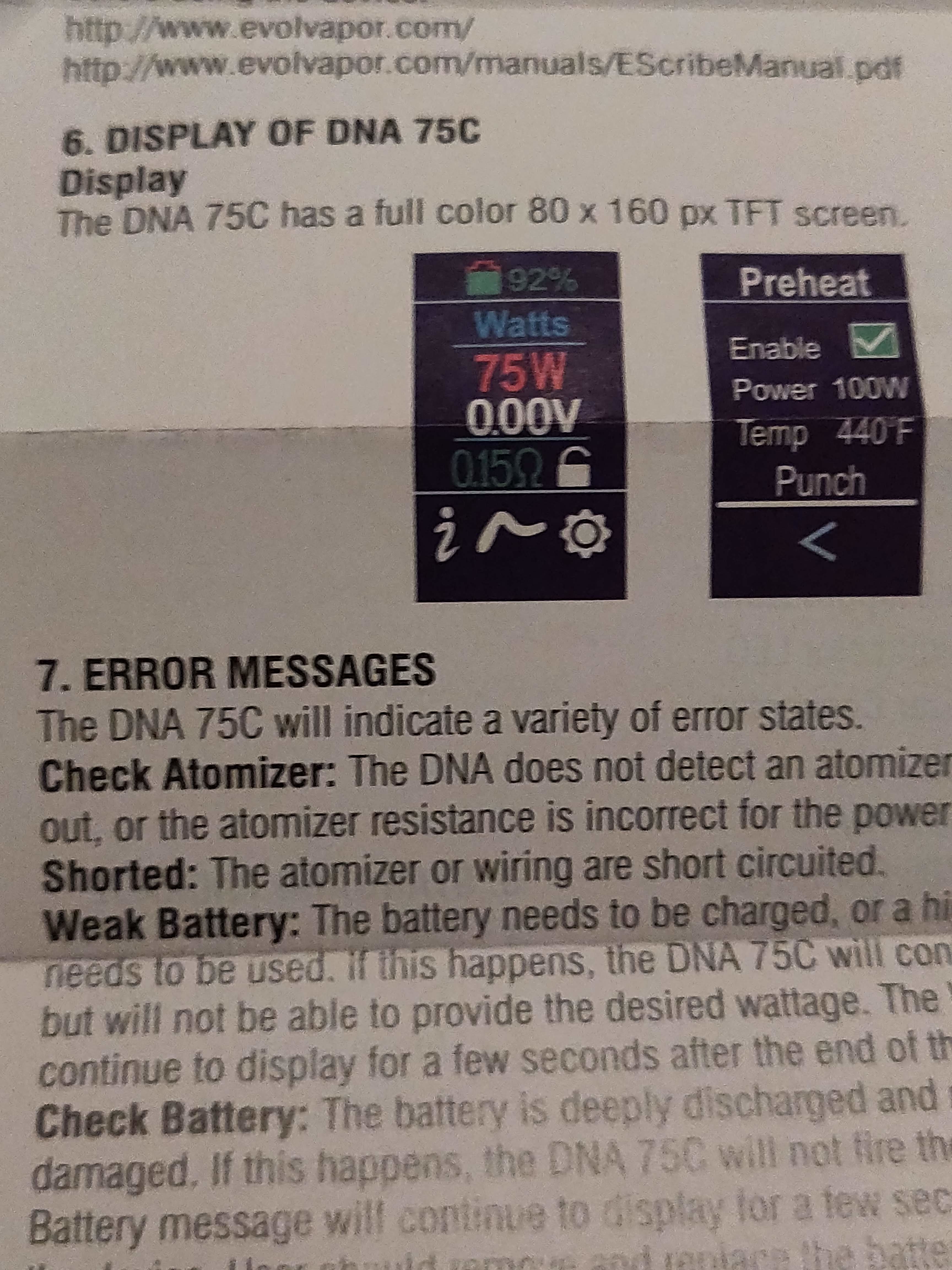

  On 2/9/2019 at 12:11 AM, Ping said:
the menu on the device looks nothing like the picture of the menu in the manual from Lost Vape
Expand
That looks like the djlsb vapes theme. If you're accustomed to the one the Paranormal, so that they both operate the same, you can use theme designer and save the theme you prefer and then load it onto the other mod. You should check some themes here, many have the new Replay feature programmed in.
