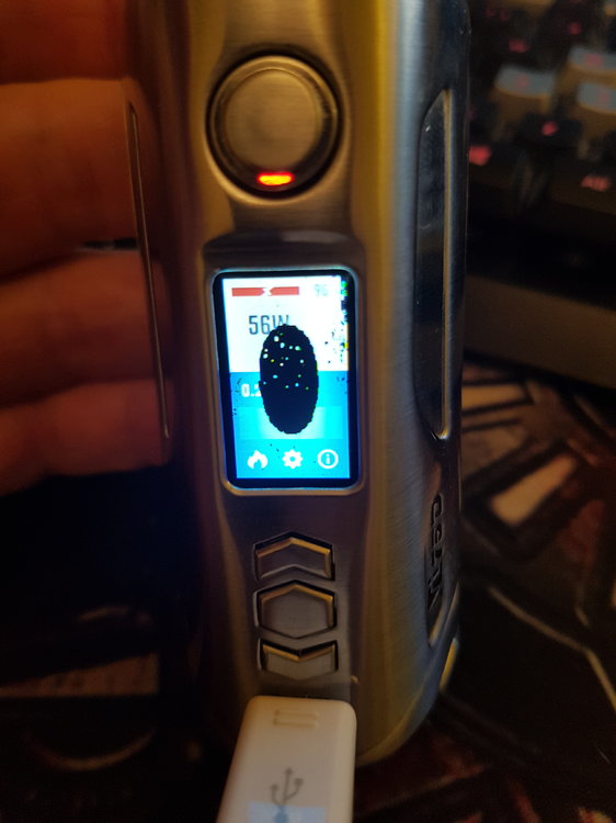

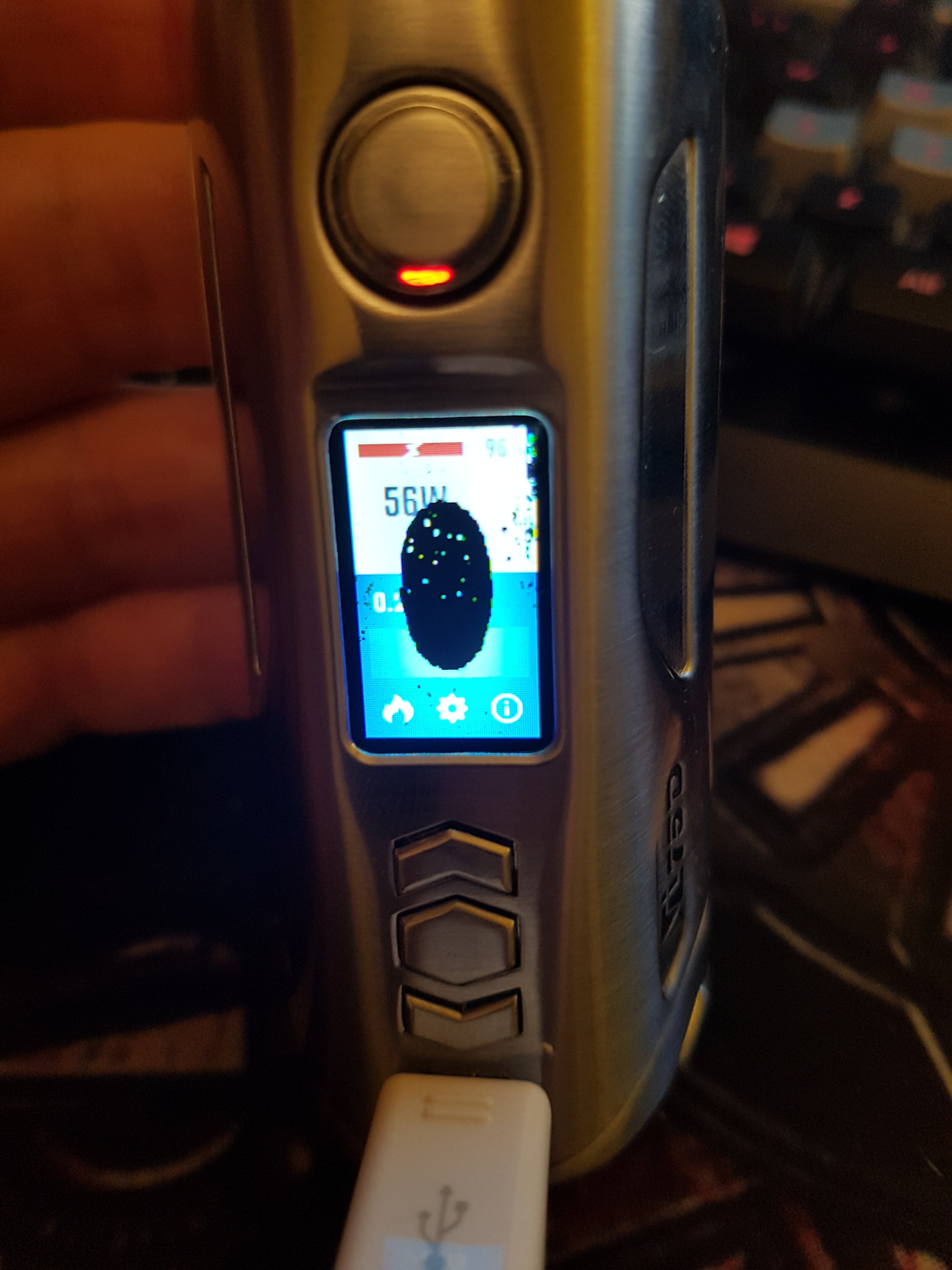

loggo Posted October 9, 2018 Report Posted October 9, 2018 Hi all, I wonder if you experts can help me here? I turned my vt75d on after a month or so only to find this strange black blob on the screen . Could any one shed some light on this and please tell me it's not completey F*%ked!! Any help would be welcome. Thanks.
mjordan79 Posted October 9, 2018 Report Posted October 9, 2018 Yes, it is completely fucked. From the image, it seems that the electrode film inside the display is gone.

loggo Posted October 10, 2018 Author Report Posted October 10, 2018 Last time I buy a hcigar mod! I see the screens aint that exspenisive to buy, so I may as well have a stab at fixing it. Thanks for the imput guys.
mjordan79 Posted October 11, 2018 Report Posted October 11, 2018 (edited) 16 ore fa, loggo ha scritto: Last time I buy a hcigar mod! I see the screens aint that exspenisive to buy, so I may as well have a stab at fixing it. Thanks for the imput guys. HCigar has nothing to do with it, the screen is produced by Evolv. And even here I have some doubts, most likely Evolv buys screens from third parties. Edited October 11, 2018 by mjordan79
Lowbytes Posted October 14, 2018 Report Posted October 14, 2018 Yes - the placement of the 510 connector on the Hcigar VT75D is "suboptimal" ..... if you use an atomizer that may leaks e liquid can easy drop into the mod or the display ...... i had exactly the same problem After opening the mod for the screen replacement i found a some e-liquid inside of the mod!
