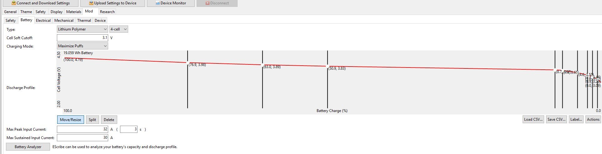

Jackal Posted August 1, 2018 Report Posted August 1, 2018 (edited) Ran battery analyzer with 1600mah 4S cells fully charged. However, the battery curve the analyzer generated sets 0% at 3.9 volts and 100% at 4.18 volts. Should not 0% be closer to 3.2 volts and not at 3.9 volts? Cheers and all help appreciated! Jackal Edited August 1, 2018 by Jackal

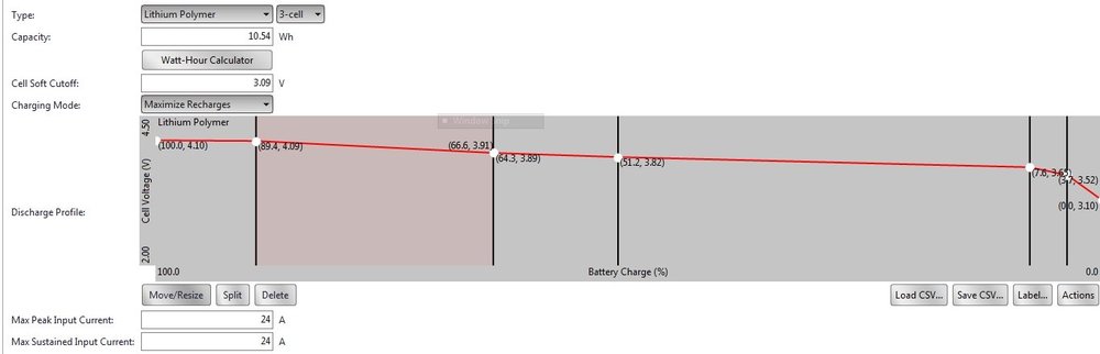

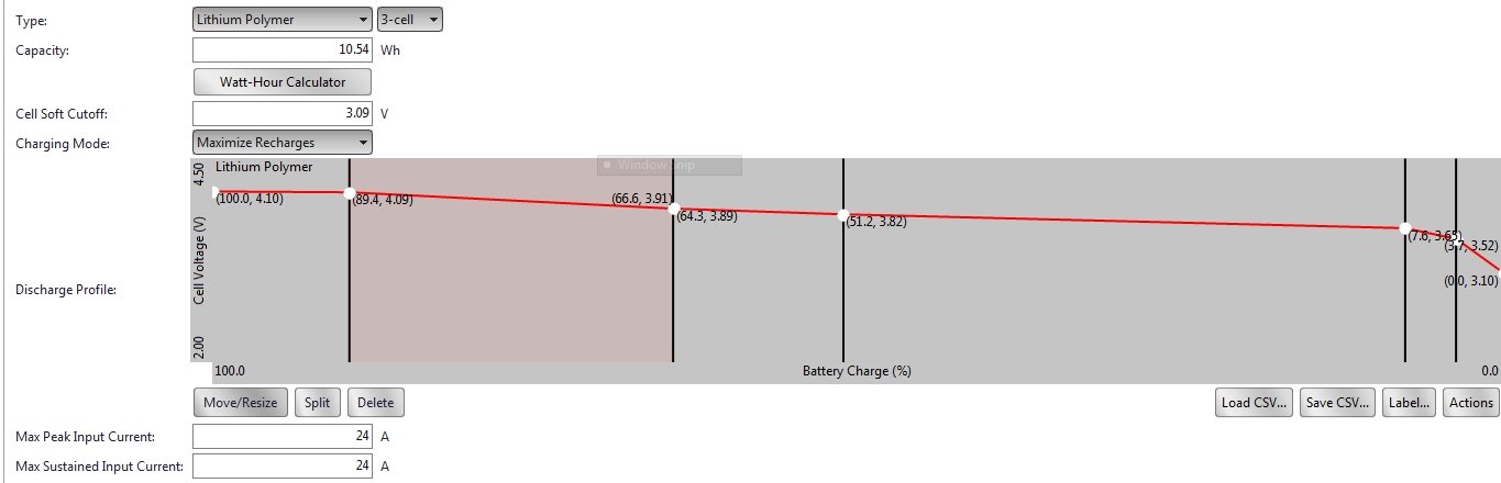

dwcraig1 Posted August 1, 2018 Report Posted August 1, 2018 It should look more like this. Note my charge cutoff is 4.1 volts though (maximum recharges) 1
Jackal Posted August 1, 2018 Author Report Posted August 1, 2018 Thanks, dwcraig1! Will re-run the battery analyzer. Cheers! Jackal
Jackal Posted August 4, 2018 Author Report Posted August 4, 2018 Got it working, thanks for your help! Cheers! Jackal 1
