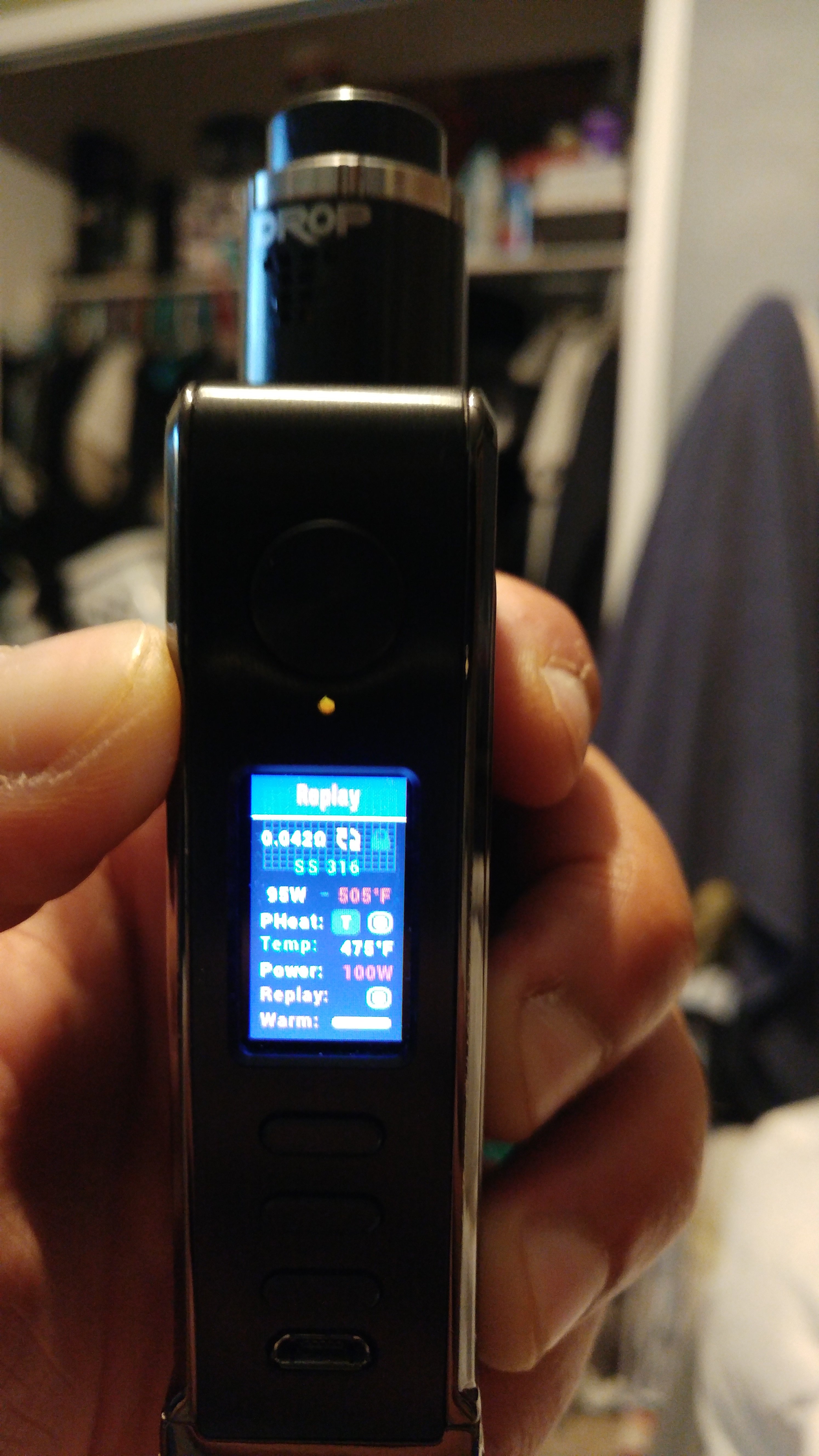

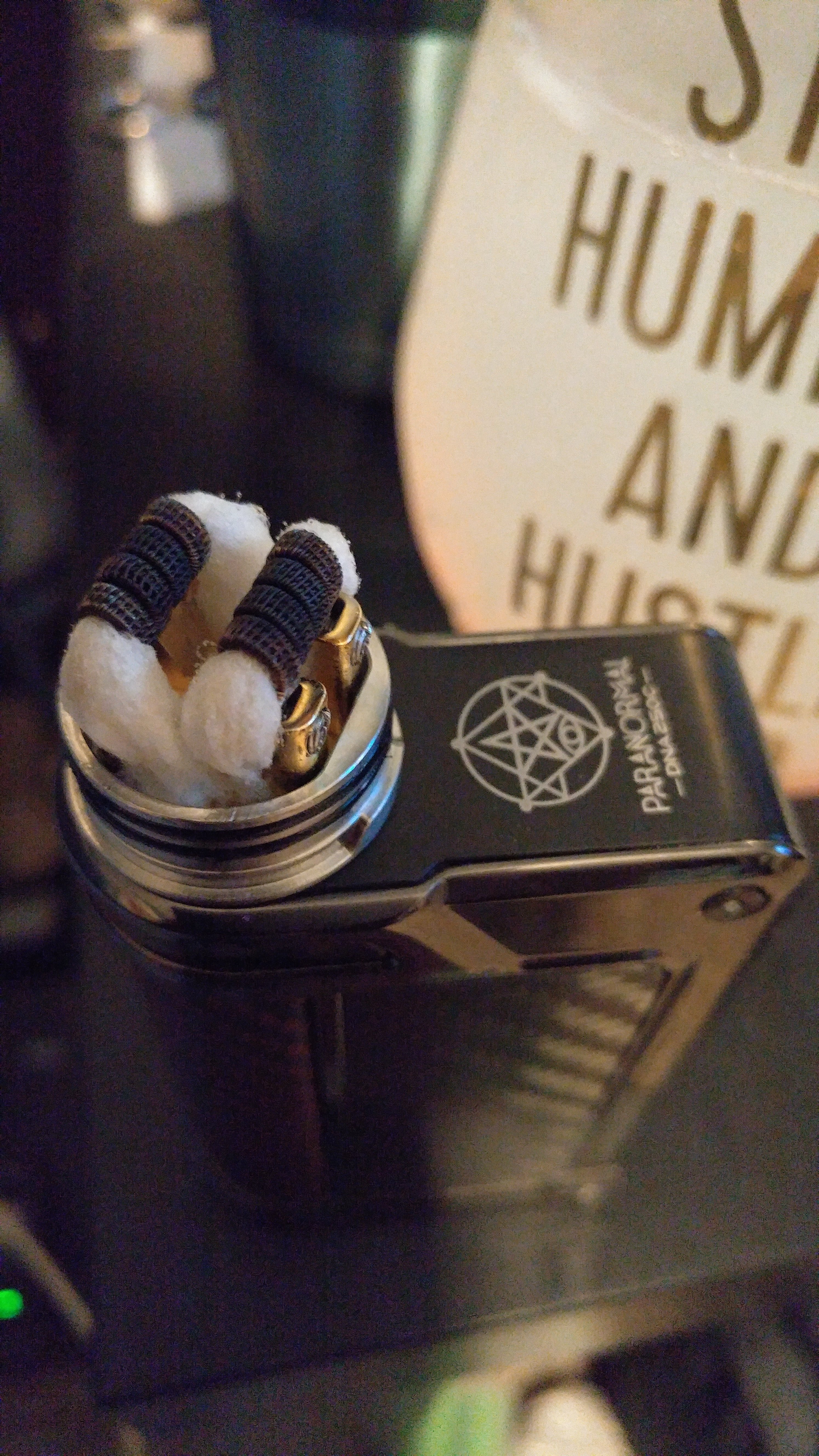

Pphish Posted July 18, 2018 Report Posted July 18, 2018 (edited) 18 hours ago, ParaVapor said: I have it built to .12 ohms, and right now, running 40 watts at 475, with a 525 preheat at 125 watt preheat, with punch at 3 or 4. I'm just getting dry, muted flavor now, when I was running it at like 30-35 watts before, at about 370-390. Dude this is nothing to do with your device. . Look at your settings! You must understand the parameters you're working with in temp control... You are using 125 WATTS(which is way too much to begin with) to pre heat to 525 F->as soon as your coil hits 525->it drops down to only using 40 WATTS(which is way too low for .12 ohms) at temp setting of 475 ( 50 degrees lower than your pre heat... That doesn't work) Try this: Get this: This is with some wire I wrapped myself: SS316L 24g /32g x 3 with 32g-> that's three 24g staggered Clapton cores wrapped by 32g then fused together with another 32g overwrap->for a fused staggered Clapton Edited July 18, 2018 by Pphish
ParaVapor Posted July 18, 2018 Author Report Posted July 18, 2018 7 hours ago, Pphish said: Dude this is nothing to do with your device. . Look at your settings! You must understand the parameters you're working with in temp control... You are using 125 WATTS(which is way too much to begin with) to pre heat to 525 F->as soon as your coil hits 525->it drops down to only using 40 WATTS(which is way too low for .12 ohms) at temp setting of 475 ( 50 degrees lower than your pre heat... That doesn't work) Try this: Get this: This is with some wire I wrapped myself: SS316L 24g /32g x 3 with 32g-> that's three 24g staggered Clapton cores wrapped by 32g then fused together with another 32g overwrap->for a fused staggered Clapton I tried your settings, was a little too hot for my build, but it was better. I lowered everything a few watts and degrees, and it's performing much better. does your mod say .042 ohms? And may I ask what theme you are using. I really like that!
Pphish Posted July 19, 2018 Report Posted July 19, 2018 14 hours ago, ParaVapor said: I tried your settings, was a little too hot for my build, but it was better. I lowered everything a few watts and degrees, and it's performing much better. does your mod say .042 ohms? And may I ask what theme you are using. I really like that! I kind of thought it might be and I thought about adding a disclaimer since you said you were using quad cores which def don't need as many watts or as high of a temp. I would do the set temp between 495-505 with the pre heat temp set to 460_465 I would still give it 80-85 Watts for the set wattage and 95 for pre heat wattage. As a rule of thumb , set the pre heat temp about 20-30 degrees lower than your set temp and set pre heat wattage about 10-20 watts higher than your set wattage... That way there is no sudden dip in vapor production. And yes my coils are beefy...I should have used some N80 or kanthal in my build to bring the ohms up; but I used all SS316 and it does read .042 lol.i do not suggest building this low you can get better performance and flavor with higher ohm builds.
