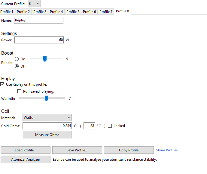

ruckus Posted April 29, 2018 Report Posted April 29, 2018 (edited) Hope your all doing well ! I'm a little confused on what the entire purpose/benefit of replay mode is... I've updated my device and modified my theme. I've followed the advice on a few threads and enabled replay mode on the "wattage" profile. Took a few hits and saved my puff, what exactly is replay mode doing ? I've already set my desired wattage.. so wouldn't the board just replicate that anyway without replay mode in the mix ? Also by using replay mode am I loosing out on temp protection? I noticed you can enable temp protection by changing the material on a profile with replay mode enabled... although does replay mode automatically temp protect or should I also enable temp protection ? How is this any better than the old temp control ? I also noticed that any temp statistic's are also disabled while using replay mode - really wish this wasn't the case so I could at least monitor what the board is doing.. Argh I've got no idea... Edited April 29, 2018 by ruckus

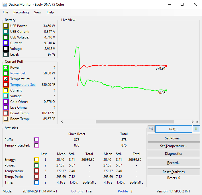

VapingBad Posted April 29, 2018 Report Posted April 29, 2018 It recreates the temp profile of the vape you record, vape while connected to device monitor and you will see it. You can use replay and temp protection together, only really a benefit if you have coils/atties that have unstable resistant. The benefit of replay is you get most of the benefits of temp protection without having to set that up.
ruckus Posted April 29, 2018 Author Report Posted April 29, 2018 9 minutes ago, VapingBad said: It recreates the temp profile of the vape you record, vape while connected to device monitor and you will see it. You can use replay and temp protection together, only really a benefit if you have coils/atties that have unstable resistant. The benefit of replay is you get most of the benefits of temp protection without having to set that up. Right so my cotton won't burn while using replay mode ? I can't see any temp stat's in device monitor am I missing something here ?
VapingBad Posted April 29, 2018 Report Posted April 29, 2018 You have watts selected as the material type, so disabling temp fields, but you should be able to see it is not level power regulation and yes it should give dry hit protection.
VapingBad Posted April 29, 2018 Report Posted April 29, 2018 This is ss in replay with temp protection turned off, but I did record the puff with temp protec on.
