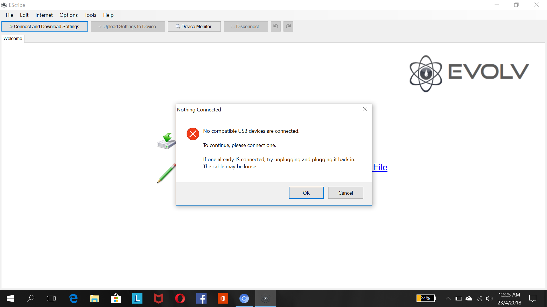

Jose Bamm Posted April 22, 2018 Report Posted April 22, 2018 hello, I've just got an issue with my PARANORMAL DNA250C device. when i plugged on my laptop, its charging but somehow i can't connect it to eScribe. I already tried on 2 laptops with 3 diffrences of USB and its just the same problem. i'm stressed out regarding to this issue.
Wayneo Posted April 22, 2018 Report Posted April 22, 2018 Download the latest version of escribe from the 250C board page. Gotta use www not forum 1
Jose Bamm Posted April 22, 2018 Author Report Posted April 22, 2018 thanks a lot friend! finally!! thank you
Wayneo Posted April 22, 2018 Report Posted April 22, 2018 1 hour ago, Jose Bamm said: thanks a lot friend! finally!! thank you You're welcome. Enjoy your mod 🤙

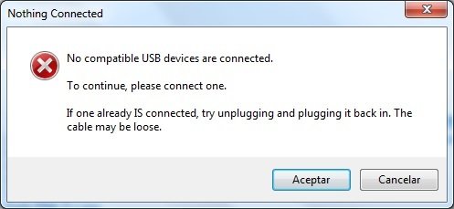

BryanSAP Posted February 5, 2019 Report Posted February 5, 2019 En 22/4/2018 at 14:19 , Wayneo dijo: You're welcome. Enjoy your mod 🤙 Hi guys, i have the same problem ! I also download Escribe from EVOLV official page right now, but it doesn't works! I got a 250c Chip Help me please
BryanSAP Posted February 6, 2019 Report Posted February 6, 2019 En 22/4/2018 at 11:54 , Wayneo dijo: Download the latest version of escribe from the 250C board page. Gotta use www not forum Please Help Me
Wayneo Posted February 6, 2019 Report Posted February 6, 2019 What version did you install? Plugged directly into PC USB2 port? Tried different cables, ports, rebooting?
Xoata Posted March 8, 2019 Report Posted March 8, 2019 I'm having the same issue I have no clue what I'm doing wrong I'm using the cord that came in the box with my paranormal and the escribe is not picking it up windows will but the app will not
Tifflez Posted March 21, 2019 Report Posted March 21, 2019 Had the same problem with device not connecting. Right click on escribe icon and 'run as administrator' solved the issue for me. Hope this helps!
SplashPuddle Posted April 23, 2019 Report Posted April 23, 2019 Some USB cables are "charge only" in which case you'll get that message and be unable to connect to escribe even though the mod is drawing power. Won't happen if you use the cable that came with your device (one for my phone works too).
