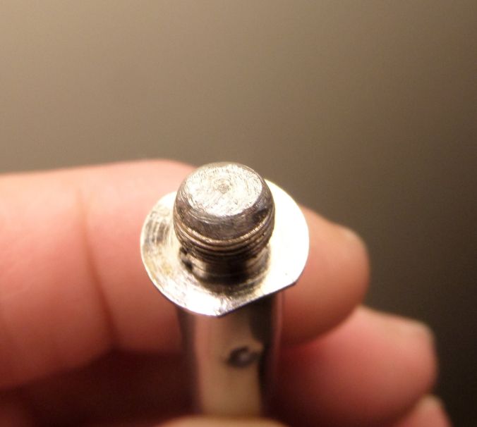

dwcraig1 Posted April 11, 2018 Report Posted April 11, 2018 In my early days of vaping I used cartomizers in a tank, I saved a bunch of them. I think that it was VapingBad that I got the idea from. Simply removed it's internals and soldered the end shut.
retird Posted April 11, 2018 Report Posted April 11, 2018 I use a 510 to 510 adapter and just fill the female end with solder.... Link to cheap adapter... https://www.fasttech.com/product/1563302-510-to-510-adapter-for-e-cigarette
