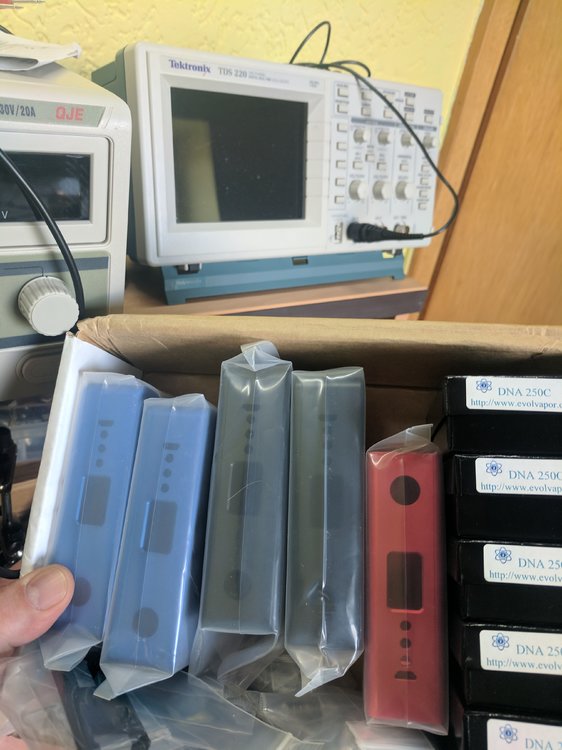

MaDc0w Posted March 31, 2018 Report Share Posted March 31, 2018 On the red box in the attached picture, where the onboard fire button/LED rest I'd like to drill a hole to bring out the onboard LED. Has anyone any proper suggestions to what LED light pipes / plugs to use? Link to comment Share on other sites More sharing options...

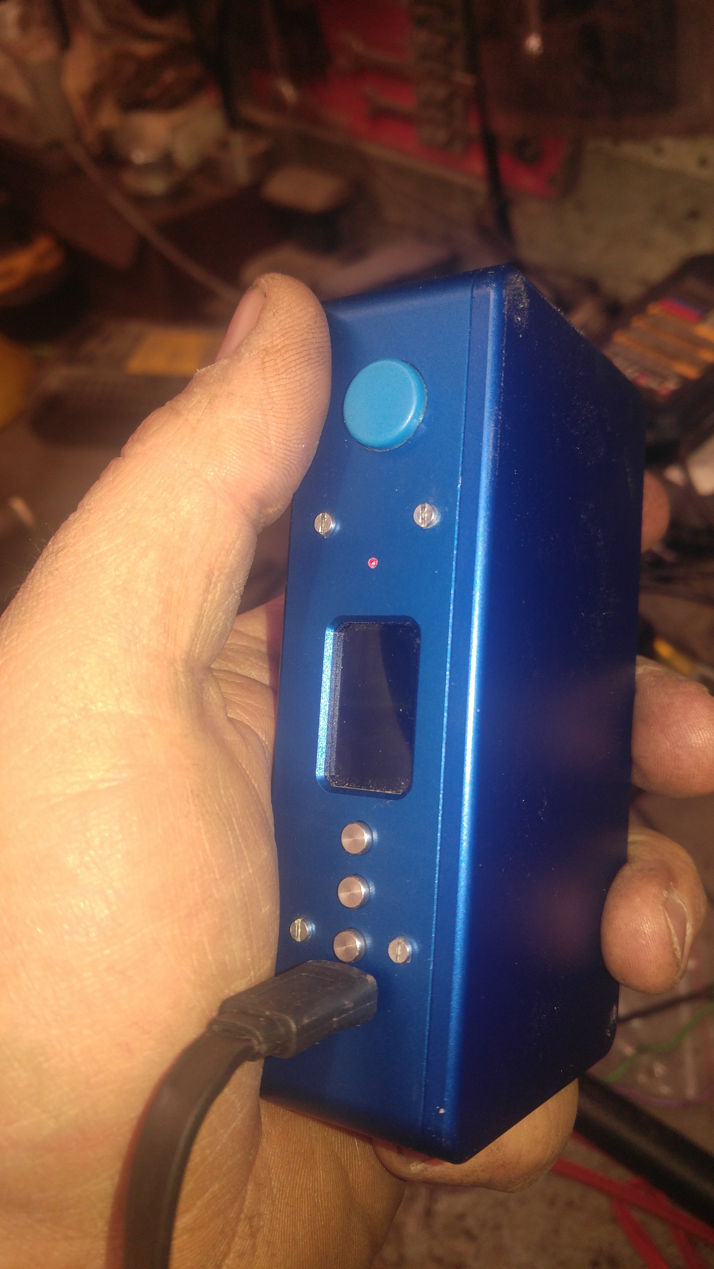

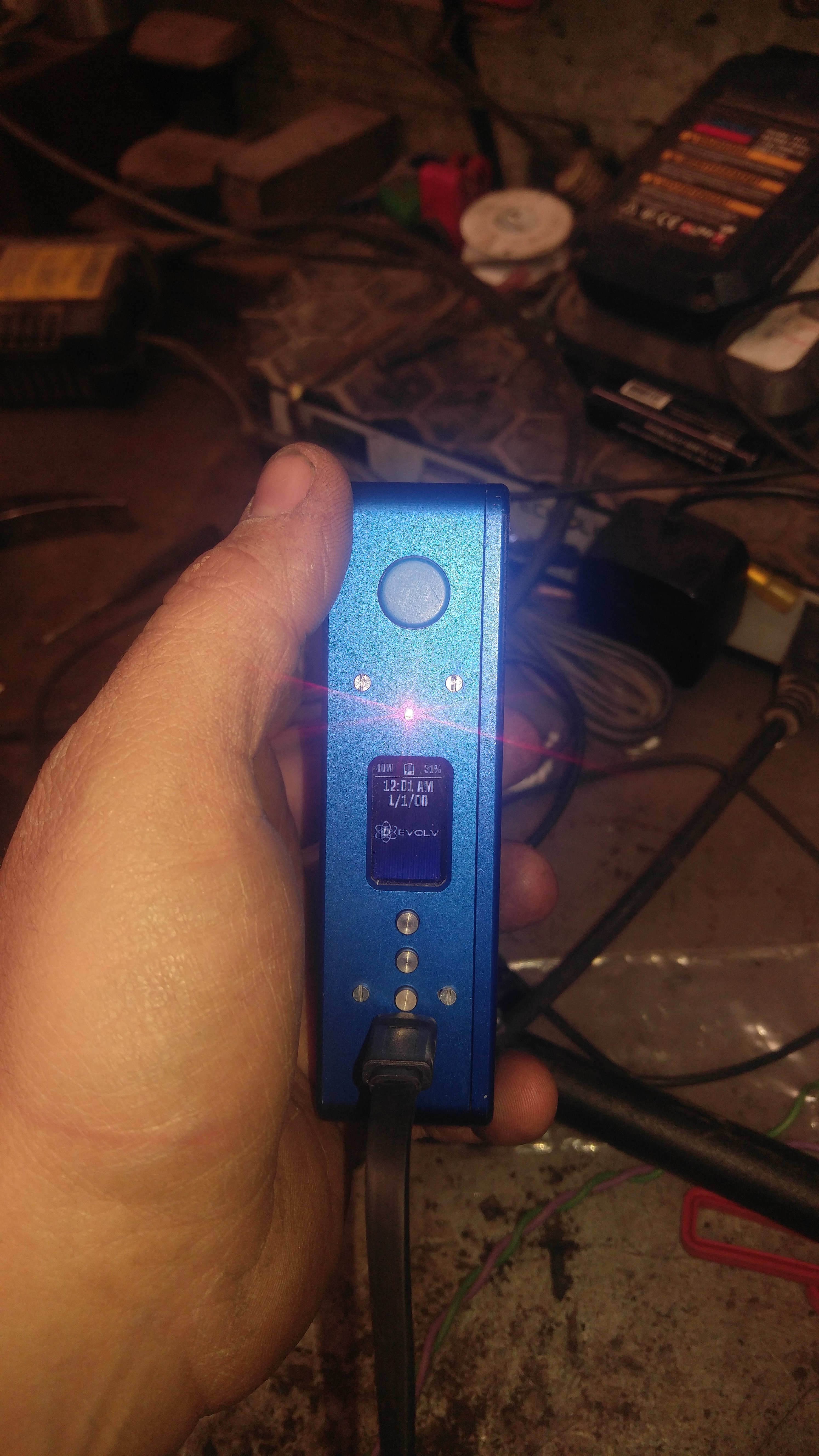

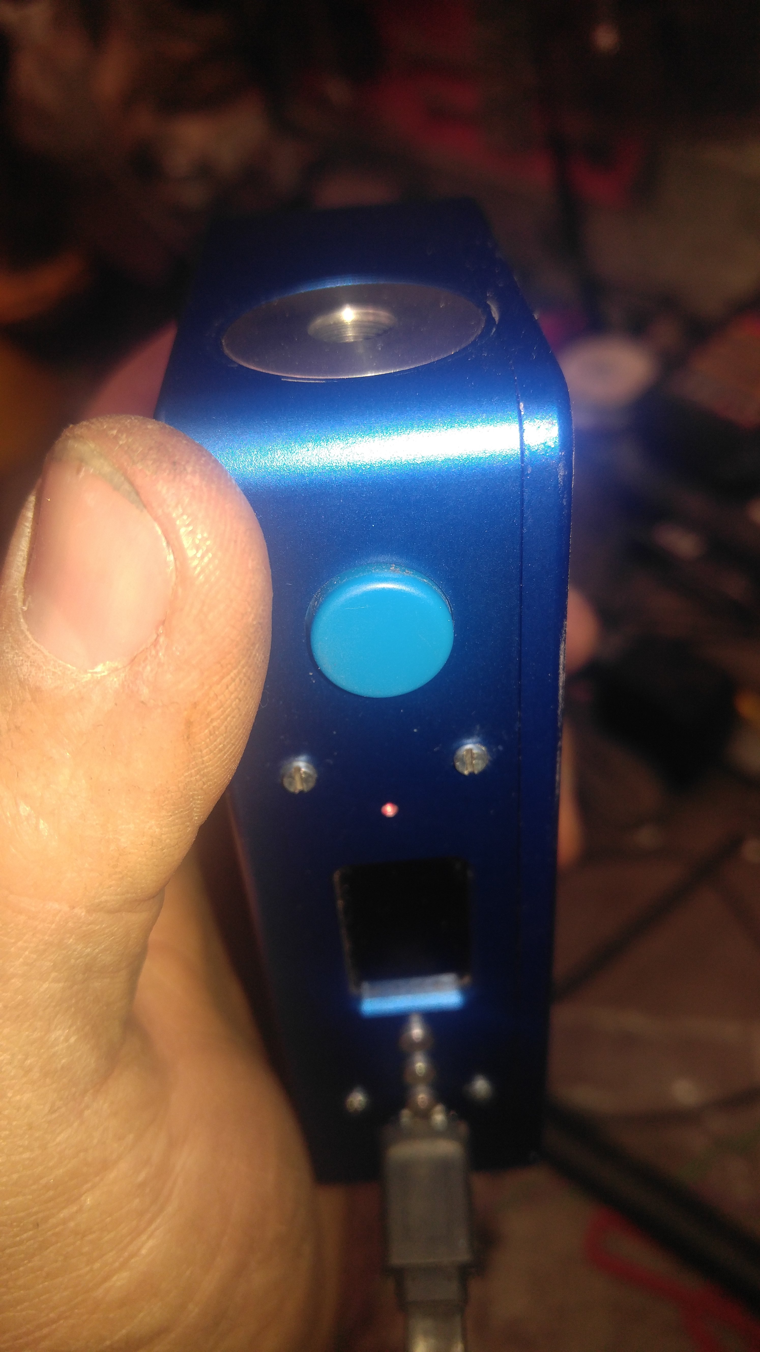

67exec Posted April 2, 2018 Report Share Posted April 2, 2018 (edited) I drilled a hole no epoxy or ca. Took a couple pics Edited April 2, 2018 by 67exec Spelling Link to comment Share on other sites More sharing options...
