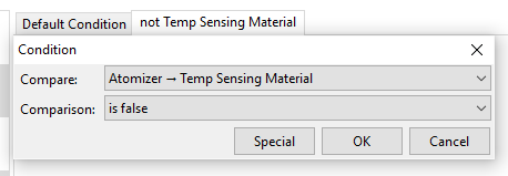

VapingBad Posted March 17, 2018 Report Share Posted March 17, 2018 For the colour screen: You need to add a condition to the field then when that condition it true display one field and another when false, have a look at the default theme to see how it is done, but do come back and ask if you need help. For the 2 colour screens they swap depending on if you are vaping with temp limiting active and if your profile is set to temperature dominant, I will get the rules wrong if I try and explain from memory at this time on a Saturday night, in the UK), have a quick play vaping with every change and you should find it quite quickly. Link to comment Share on other sites More sharing options...

VapingBad Posted March 17, 2018 Report Share Posted March 17, 2018 Look at what is done it the default theme, it should show you what to change on your one re swapping temp for watts, it is just having a condition on the field, say have "Atomizer -> Temp Sensing Material = False" set the field to watts and set it to temp in the default condition. Link to comment Share on other sites More sharing options...

VapingBad Posted March 22, 2018 Report Share Posted March 22, 2018 On 3/22/2018 at 3:03 PM, iambyrdman said: That has nothing to do with changing layers... or does it? I'm new.... Expand Conditions sort of swap which field is displayed or how it is displayed depending one the conditions, you can chain 8 IIRC, they take up the same screen area as the element you attach them to which is why I said sort of swap. Link to comment Share on other sites More sharing options...
