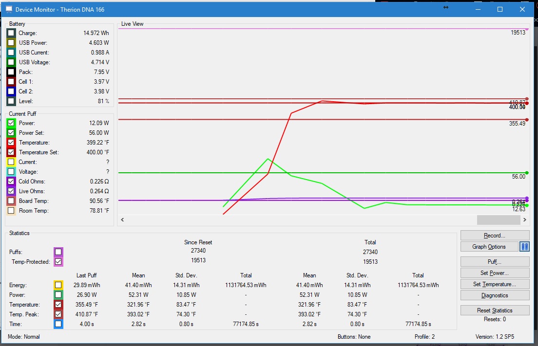

giz_60 Posted January 12, 2018 Report Posted January 12, 2018 (edited) At only .01 - .02 rise in resistance from a cold coil to hot, it would seem that you are not getting enough of a rise in resistance. If the board doesn't see enough rise in resistance in the first second or so, it will drop out of TC. For instance, my current SS316L coil is .178 cold & rises to .210 - .211 after firing. Have you tried spacing your coils? What kind of atty? Can you post a screen shot of Device Monitor while firing, with the following fields checked...Power, Power Set, Temperature, Temperature Set, Cold Ohms & Live Ohms... Edited January 12, 2018 by giz_60

TorturedZen Posted January 14, 2018 Author Report Posted January 14, 2018 Here's my screenshot. Atty is Augvape Boreas V2, spaced SS 316L dual fused claptons...
dwcraig1 Posted January 14, 2018 Report Posted January 14, 2018 My guess on this is the wick isn't keeping up with the coil, you might try dripping a bit of juice through the drip tip /top to prove/disprove this.

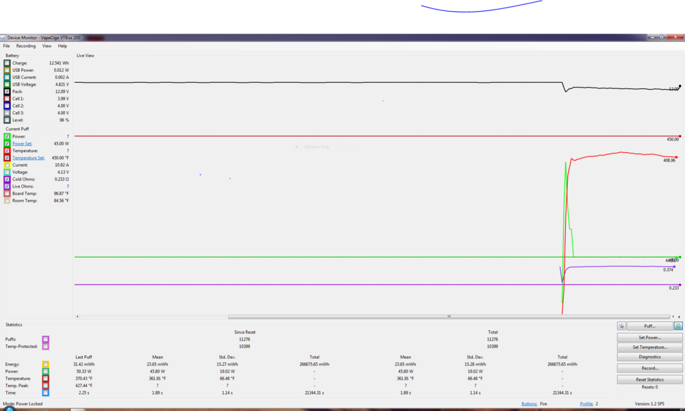

dwcraig1 Posted January 14, 2018 Report Posted January 14, 2018 This isn't SS316 but here is a screen with 120 watts for 0.5 seconds preheat and 45 watts after. No air, just holding the fire button down.
