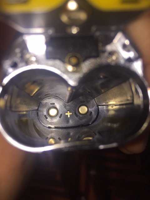

emoro Posted February 15, 2019 Report Posted February 15, 2019 Can you tell me what pins you are talking about? I'm sending you a couple of photos so you can tell me which ones should be sanded. Thanks!
vaperneto Posted February 15, 2019 Report Posted February 15, 2019 (edited) that ones in red Edited February 15, 2019 by vaperneto
