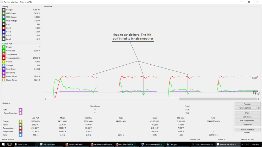

Wayneo Posted January 1, 2018 Report Posted January 1, 2018 On 1/1/2018 at 4:46 AM, TonyMcD said: ..... and 24ga titanium coils built to ~0.20 ohms. I generally keep the wattage at 60 and the temp between 200 and 300 depending on the coil. Expand I've found Titanium coils loosen up in some atty's, so you ought to check for loose coonections (no comment on Smok). This 200 and 300, is that °F or °C? On 1/1/2018 at 4:46 AM, TonyMcD said: Also, the temperature reading on the mod never went over temp. Even when at 1 watt it wouldn't go down, it just hovered around the max temp. Expand I don't understand this at all. Did you see this in 'Device Monitor', and Max temp is the temp you set it for? A printscreen of Device Monitor while firing would help. On 1/1/2018 at 4:46 AM, TonyMcD said: However, the most interesting thing I noticed though was if I increase the temperature to about 350 or higher, it works fine. But unfortunately that temp produced way to much vapor to be usable. If I used wattage mode, that continued to work as normal Expand OK, looks like you're talking °F, and I don't usually get any vapor at that low temp. So now you're just using straight watts with that Titanium wire? On 1/1/2018 at 4:46 AM, TonyMcD said: The understanding that I have is it would way over power the coil causing it to go way over temp (although the screen never indicated it was over temp), and then the mod would try to fix itself by going down to 1 watt Expand I DO NOT have this understanding.
TonyMcD Posted January 1, 2018 Author Report Posted January 1, 2018 (edited) On 1/1/2018 at 4:41 PM, Wayneo said: I've found Titanium coils loosen up in some atty's, so you ought to check for loose coonections (no comment on Smok). This 200 and 300, is that °F or °C? Expand Sorry, all temps I stated have been in F and all temps will be in F. I have tried different mods, all cleaned with alcohol and wire brush, all brand new coils for each mod. I used nickel, nichrome, ss316, a ss316 mesh, and two separate rolls of titanium. So at this point I am certain it is not the atty, or the coil. Quote Quote Also, the temperature reading on the mod never went over temp. Even when at 1 watt it wouldn't go down, it just hovered around the max temp. Expand I don't understand this at all. Did you see this in 'Device Monitor', and Max temp is the temp you set it for? A printscreen of Device Monitor while firing would help. Expand Max Temp is the temp I set it for (I've been referring to it as working temp). The temp reading I am talking about is the reading displayed on the mod (which will be referred to as temperature reading, or "temperature"). I have it set to display ohms, profile, and "temperature" (that is the exact name off the setting, the same as "Temperature" in device monitor). When I take a hit at around 20watts, "temperature" will start at like 100F using the full 20w and slowly rise up to my working temp of 250F. Once "temperature" reaches 250F the wattage will drop to between 10-15 and the "temperature"will stay around 250F (This is how it is supposed to work and always has) At higher watts like 50, "temperature" will almost immediately rise up to my working temp and then just hover around there, even while the wattage drops down to 1. A couple seconds later the wattage will jump back to 50 for a half second then back down to 1, all the while "temperature" hovers around 250F. Sorry for the wordiness, but I tried to be as clear as possible. Also I can not get a screen shot of the device monitor because like I said, the issue has since resolved itself This whole episode only lasted maybe 13 hours, and I took maybe about 150-300 puffs since the issue began. P.S. By "hover" around 250F, I mean that the "temperature" reading would fluctuate anywhere from 248F to 252F. And just to be clear again, It would still jump to and stay at 1 watt even if the "temperature" reading stayed at 249F or lower. Quote OK, looks like you're talking °F, and I don't usually get any vapor at that low temp. So now you're just using straight watts with that Titanium wire? Expand Yes, everything is F. My titanium coils are usually between 0.15 and 0.28. The temp I would need to get vapor would be between 200F and 350F depending on the resistance of that coil. And yes i was using it in temp control mode, and I am certain it was in temp control mode. I have the display settings arranged differently so I always know if it switches on me for some reason. Quote Quote The understanding that I have is it would way over power the coil causing it to go way over temp (although the screen never indicated it was over temp), and then the mod would try to fix itself by going down to 1 watt Expand I DO NOT have this understanding. Expand Well what do you think is going on then? That is the only the way it makes any sense to me. That is one off the reasons I bought the DNA250, hoping that this wouldn't be a problem. And it has been a dream with only this one exception. Other mods I have used would do this all the time, although not nearly to the severity that the DNA250 freaked out too. I am going to take a screenshot of device monitor now. Remember though, this screenshot will not display the problem I was having, only how it is behaving now. Which is perfectly normal as far as I can tell. I will also include my current settings profile, just to be through. FYI if you load my profile, TI - 0.20 is the default titanium setting just renamed. The TI - 0.10 and TI - 0.30 are basically placeholders. I loaded some test settings to play around with, but they are not usable as they currently stand. Working Profile.ecigFetching info... Edited January 1, 2018 by TonyMcD
Wayneo Posted January 1, 2018 Report Posted January 1, 2018 If it was a one off, I wouldn't worry about it. And like you mentioned, that printscreen looks fine. Using Ti, with my single battery DNA's I'll turn off all preheat settings, but with multi battery I can blast it full and not encounter this 1 watt issue. Where do you keep seeing 1 watt? If you move your pointer over any area of Device Monitor, it will display the values at that time (like over on the right at the end of the puff) As far as your .ecig file 'watts' is showing you have it set as tc sensing with full blown curves. You shouldn't need multiple profiles for Ti like .1, .2, .3, as TC is wire specific. Your printscreen (Profile 6) you 'lock' the ohms (is that because it's that Smok atty) ?

TonyMcD Posted January 1, 2018 Author Report Posted January 1, 2018 (edited) On 1/1/2018 at 9:14 PM, Wayneo said: If it was a one off, I wouldn't worry about it. And like you mentioned, that printscreen looks fine. Expand I still want to know why this happened. If I could have attributed it to a bad coil or tank or anything then I wouldn't worry about it. But as of right now, it seems to me that it was some problem with the mod itself. And if it happened once, it will happen again. Like i said though, it's not a rush. Quote Using Ti, with my single battery DNA's I'll turn off all preheat settings, but with multi battery I can blast it full and not encounter this 1 watt issue. Where do you keep seeing 1 watt? If you move your pointer over any area of Device Monitor, it will display the values at that time (like over on the right at the end of the puff) Expand I explained this already... Whenever I went above a certain threshold of wattage (dependent on the resistance and temp setting) it would have the problem. It would heat up very fas, produce vapor and then within 1 second drop down to 1 watt and stop producing any vapor. Then two or three seconds later it would heat up very fast again and produce vapor. Again, within a second, back down to 1 watt and no vapor. The whole process repeats. There were also temp protection warnings sometimes, but not always. If I lowered the wattage enough, it would work like normal. It would run at specified wattage until up to temp and then drop down to whatever was needed to keep producing vapor. However, the wattage had to be lowered to the point where it would take 5 sometimes 9 or 10 seconds each time to get to warm enough to produce vapor. Example, Titanium 0.20 - 250F. Anything above 20watts creates the 1 watt drop issue. at 20watts, it takes 5-7 seconds to reach 250F and start producing vapor. Once it reaches 250F the wattage dropped to about 15 and it kept the temp up and vapor steady. But it is unrealistic to have to wait that long to take a hit. Also, I did mess around with preheat, set it to max, set it to low, changed many other settings, nothing effected it. Well actually, lowering the preheat made it take even longer to warm up... Quote As far as your .ecig file 'watts' is showing you have it set as tc sensing with full blown curves. You shouldn't need multiple profiles for Ti like .1, .2, .3, as TC is wire specific. Your printscreen (Profile 6) you 'lock' the ohms (is that because it's that Smok atty) ? Expand Thanks for catching the watts settings, i just messed with it, and the watts and Ti - 0.10 tend to sometimes revert back to defaults when I mess with other settings. I had to manually swap all the values on them because there was no other way to move watts on top of the titaniums (you can't delete or move the original titanium or nickel value). The reason I have multiple settings for my titanium TC is because I prefer the lower temps. I don't want to have to put the temp up past 300 ideally. Better taste. And yes, the lock is because I am using the Smok atty. I plan on upgrading soon to the Kayfun V5, if its ever in stock. Until then, I like the Smok because it's large, simple, super easy to use, and (other than the resistance) works decent enough. Quote OK, just put my .18 Ti coil to 220F at 70watts, no preheat. Similar to you it dropped to 4 watts, no vape. On 1/1/2018 at 4:41 PM, Wayneo said: OK, looks like you're talking °F, and I don't usually get any vapor at that low temp. Expand Back up to ~400F, and there it was ....... vapor. Expand My .15 Ti coil at 215F at 50 watts (or anything higher) works fine. It does preheat, and then the wattage drops to about 15, which produces the exact amount of vapor I want. If I set it to 400F, it crackles and bubbles and burns, it's way too much power. And it's not like I'm taking weak hits, it clouds as good as anybody else. I tend to take stronger hits than most people tbh. Also, the problem I had was never 4 watts. It was always specifically 1 watt, never 2 or 3, always 1. If it drops down to 2 or 4 or whatever, the temp just needs to be increased. My issue is a completely different thing. But thank you for the help so far! Also, thanks for reading all of this too. I tend to put a little to much detail. Edited January 1, 2018 by TonyMcD
