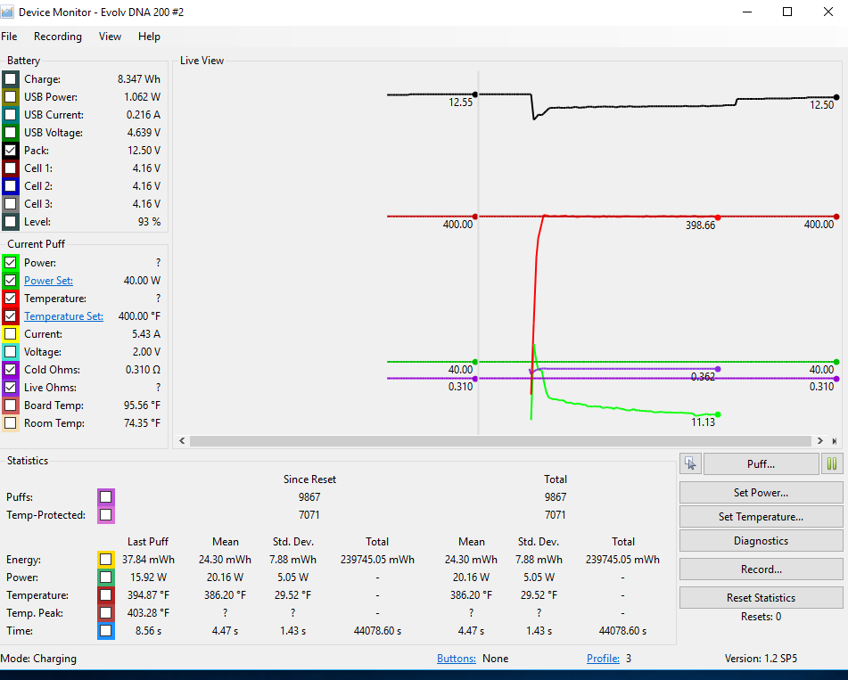

Using Device Monitor you can see cold and live ohms, temp setting reached, wattage used, and much more... here is an example... the live data (while vaping) shown is the items you check on the left side if the screen...
