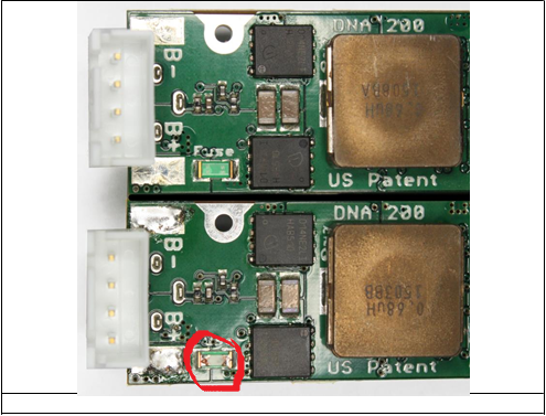

giz_60 Posted November 13, 2017 Report Posted November 13, 2017 Sounds like the on board fuse may be blown. The 200 board doesn't have reverse polarity protection, so if you inadvertently inserted a cell backwards....If the fuse is blown & you want to replace it yourself, the info on the fuse is in the DNA 200 datasheet...dna200.pdf
