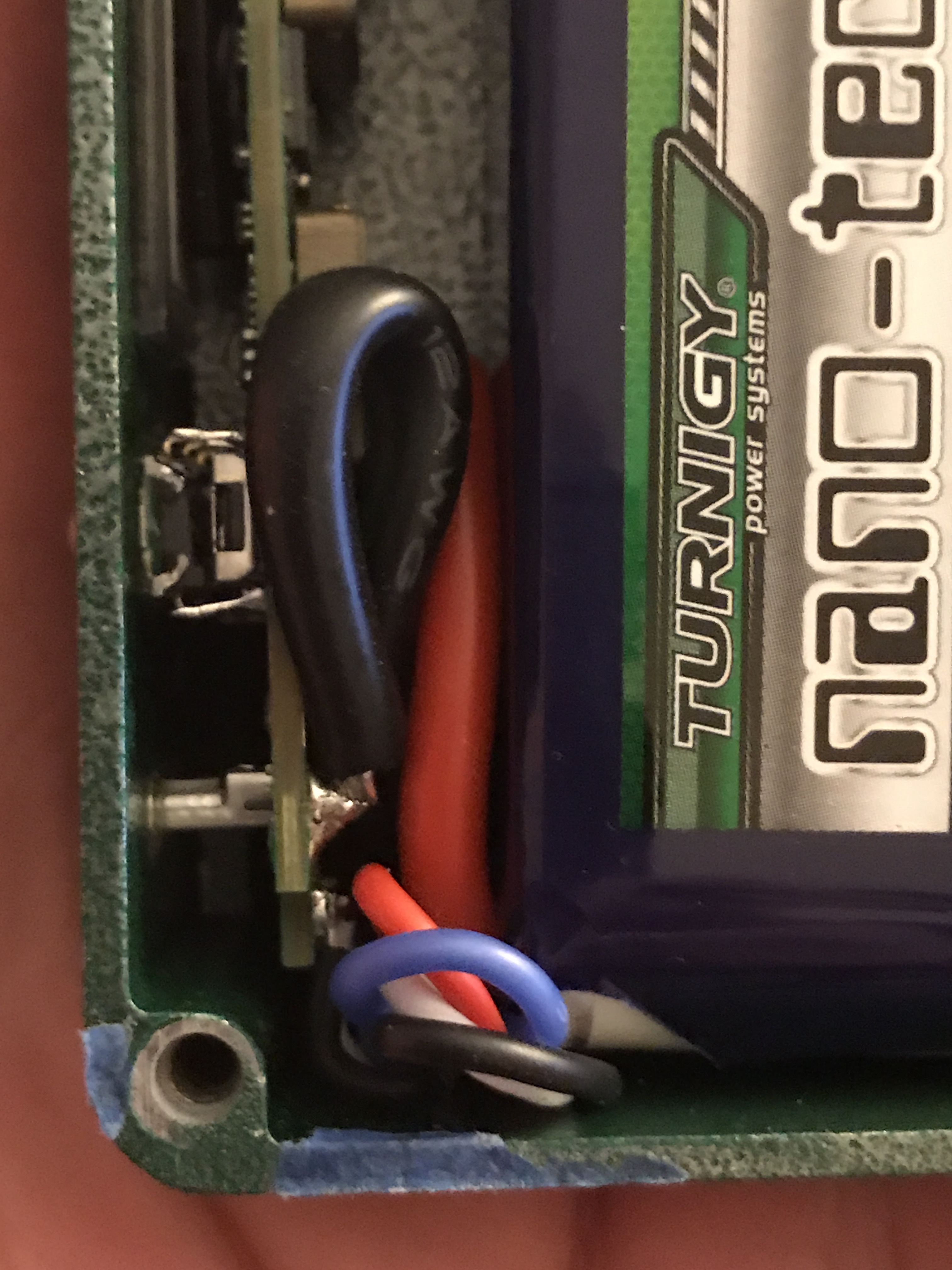

TinyBeardedMan Posted November 6, 2017 Author Report Posted November 6, 2017 this is the inside of my box.
Wayneo Posted November 7, 2017 Report Posted November 7, 2017 (edited) See those thinner wires (Black/white/blue) are they plugged into the board in between the thick red and black coming from the battery? You might be able to lift out the battery carefully which has either been soldered directly to the board or there will be a connector Looking carefully, he appears to have cutoff the connectors and wired directly to the board, due to space. Edited November 7, 2017 by Wayneo Looked closer
TinyBeardedMan Posted November 7, 2017 Author Report Posted November 7, 2017 They look like they are attached.
Wayneo Posted November 7, 2017 Report Posted November 7, 2017 Yeah, so you have a few options. The RC hobby guys are familiar with Lipo's and tight soldering. They might see an issue with the sollder joints/wire. Your battery you can find at hobbyking. You could see if they're willing to to replace it for you, but it's obviously more work than just plugging in 2 connectors. It'll take them more time to clean up what's there, than the new soldering required. It looked to be a tight fit so maybe there was no room for connectors, blah blah blah. For a builder to do it, you could check/ask at your local vape store. Do you remember what the nonsense message was? All I've said was how to replace the battery. 1
