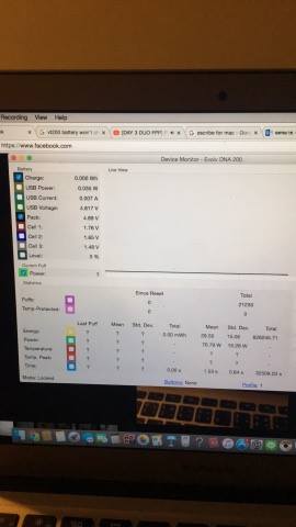

Spector NS5 RD Posted October 24, 2017 Report Posted October 24, 2017 @Anusit it appears your lipo is on it's way out or dead. You can try USB Recovery but i'm not sure if it works below 2 volts a cell. Either way, with a lipo that far over-drained it is best to replace it with new. ONE OPTION>>>>> https://www.ebay.com/itm/UPGRADE-LIPO-BATTERY-1300mAh-3S-11-1V-EFUSION-VAPECIGE-CUSTOM-EVOLV-DNA-200-250/272517143930?hash=item3f73499d7a:m:maVwXKjZiS5g_nUNSbq71Sw 1
