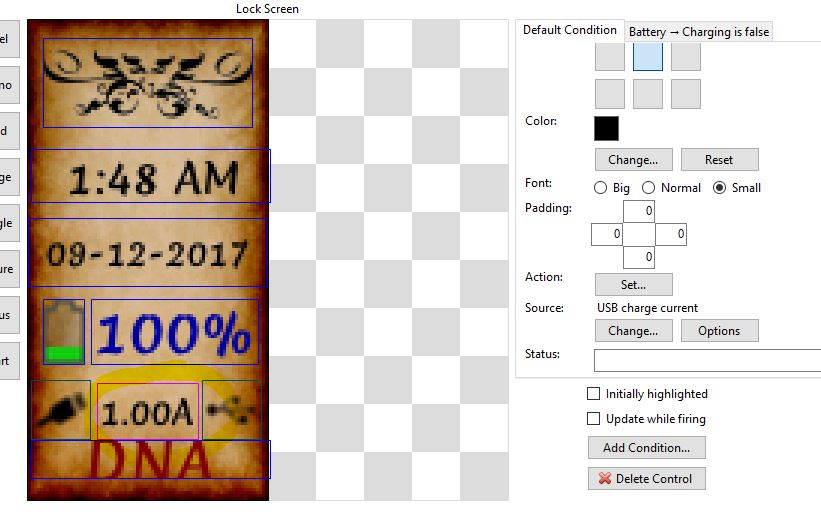

ClintMaas Posted September 12, 2017 Report Share Posted September 12, 2017 Is there a way to show the charging current when not connected to your PC? I added the charge current which works fine when plugged into the PC but not when charging via wall wart. I'm only about three hours in of owning a "75C". Just messing with current themes before trying my own. Link to comment Share on other sites More sharing options...

ClintMaas Posted September 14, 2017 Author Report Share Posted September 14, 2017 Thanks for your inputs. I always have three wallwarts at my desk and the one I was using just happened to not show anything. The other two do show a charge current (a Samsung and Apple). I do notice the charge rate doesn't show the full 1 amp like you said James but it works at least. I sometimes have issues with my car charge part and on the old boards, I always had the rate visible...just to show it's actually charging. But to whoever was involved with the screen development, well done! I do industrial HMI development for a living and I am impressed. Even caught myself editing themes on one screen while doing my "job" on the others yesterday. Link to comment Share on other sites More sharing options...
ClintMaas Posted September 14, 2017 Author Report Share Posted September 14, 2017 Now to stop editing other's themes and make my own. ..the overlaps are the batt/charge fields. I do see how it can be done another way now. <---NOOB Link to comment Share on other sites More sharing options...
