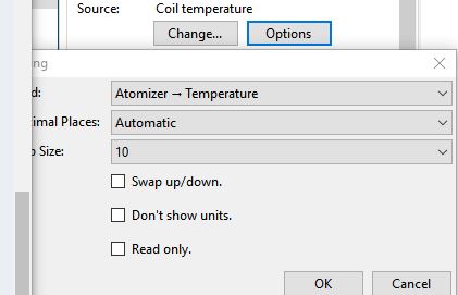

2 hours ago, Jasonvillamil said:
You can use the theme editor to select the wattage text field. Modify it and you can then change the increment.
I changed it to 10 and it still moves at 0.1 not sure if I'm doing something wrong or is it my vapedroid.
Be sure that the field Source is Coil Temperature. Click Options, and set the Step Size to the desired increment:
Hit OK, and be sure to Apply the theme, and upload the changes to your mod.

Seems like it may have been an option in the VapeDroid firmware I changed themes and it worked right away. Thanks for all the help though really was annoying going from 70w down to 5w lol way faster now.
