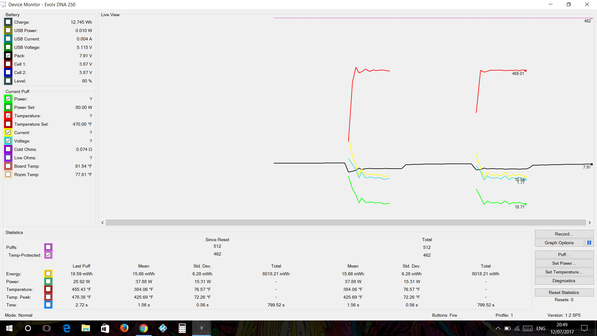

cmpvaz Posted July 12, 2017 Author Report Posted July 12, 2017 I made a print screen with single coil NI200 @ 0,11 ohms. I don't have any experience in escribe. You see anything wrong?
retird Posted July 12, 2017 Report Posted July 12, 2017 That screen looks normal and is achieving the set temperature... The preheat is letting the coil reach set temp quickly and at set temp it is regulating to maintain the set temp....
Wayneo Posted July 12, 2017 Report Posted July 12, 2017 Looks good to me, it IS tracking according to the material profile. How about another great printscreen of your Material tab, with your NI200 highlighted on the right hand side, and your Profile 1 tab
