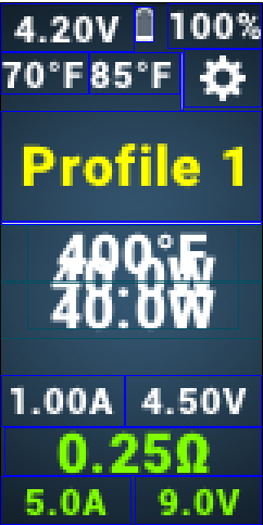

Flog Posted July 22, 2017 Report Posted July 22, 2017 (edited) The latest rev of the firmware, EARLY SERVICE PACK (all devices) EScribe Suite 2.0 SP4.2 fixes the current prob. found at the sites Early Firmware and EScribe Suite The white 1.00A works now. Edited July 22, 2017 by Flog double images
