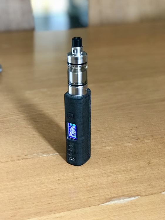

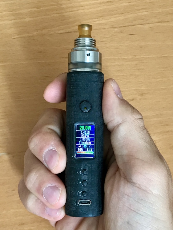

SHALE84 Posted August 9, 2017 Report Posted August 9, 2017 On 7/30/2017 at 6:22 PM, znapr said: Here's my 3D printed DNA75C. It needs more finer sanding and in the next version I will make the secondary buttons larger. However, it feels rock solid in the hand and more importantly very comfortable! Expand beautiful little mod,I wish I have 3d printer...
shugg1967 Posted August 24, 2017 Report Posted August 24, 2017 On 7/29/2017 at 6:07 PM, David247 said: Expand nice mod
marion Posted September 4, 2017 Report Posted September 4, 2017 On 7/30/2017 at 6:22 PM, znapr said: Here's my 3D printed DNA75C. It needs more finer sanding and in the next version I will make the secondary buttons larger. However, it feels rock solid in the hand and more importantly very comfortable! Expand I find your mod really nice and it looks very small ! Bravo I've printed a box for my DNA75c with my boyfriend, but it is much bigger ! Are the files public, in thingiverse or elsewhere ? If not, would you be ok to share it ?

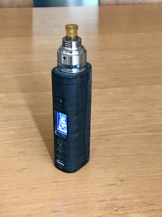

SHALE84 Posted January 27, 2018 Report Posted January 27, 2018 Remixed some dna 75 mod I have found on thingiverse 1

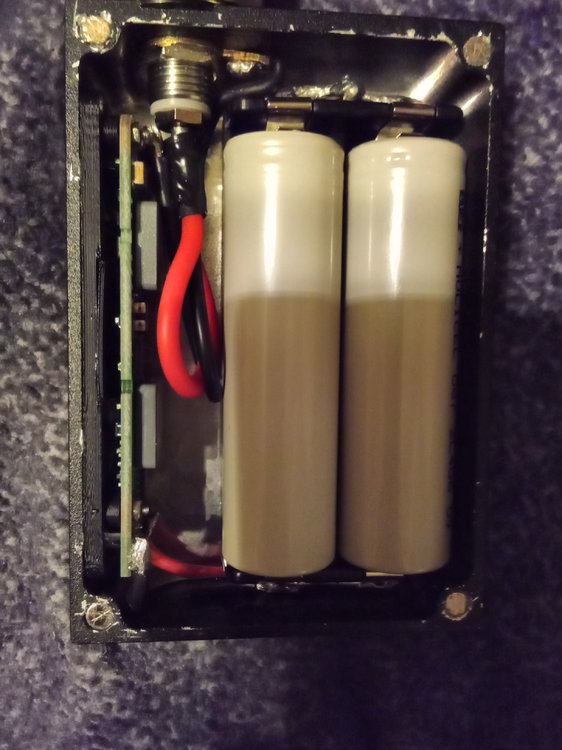

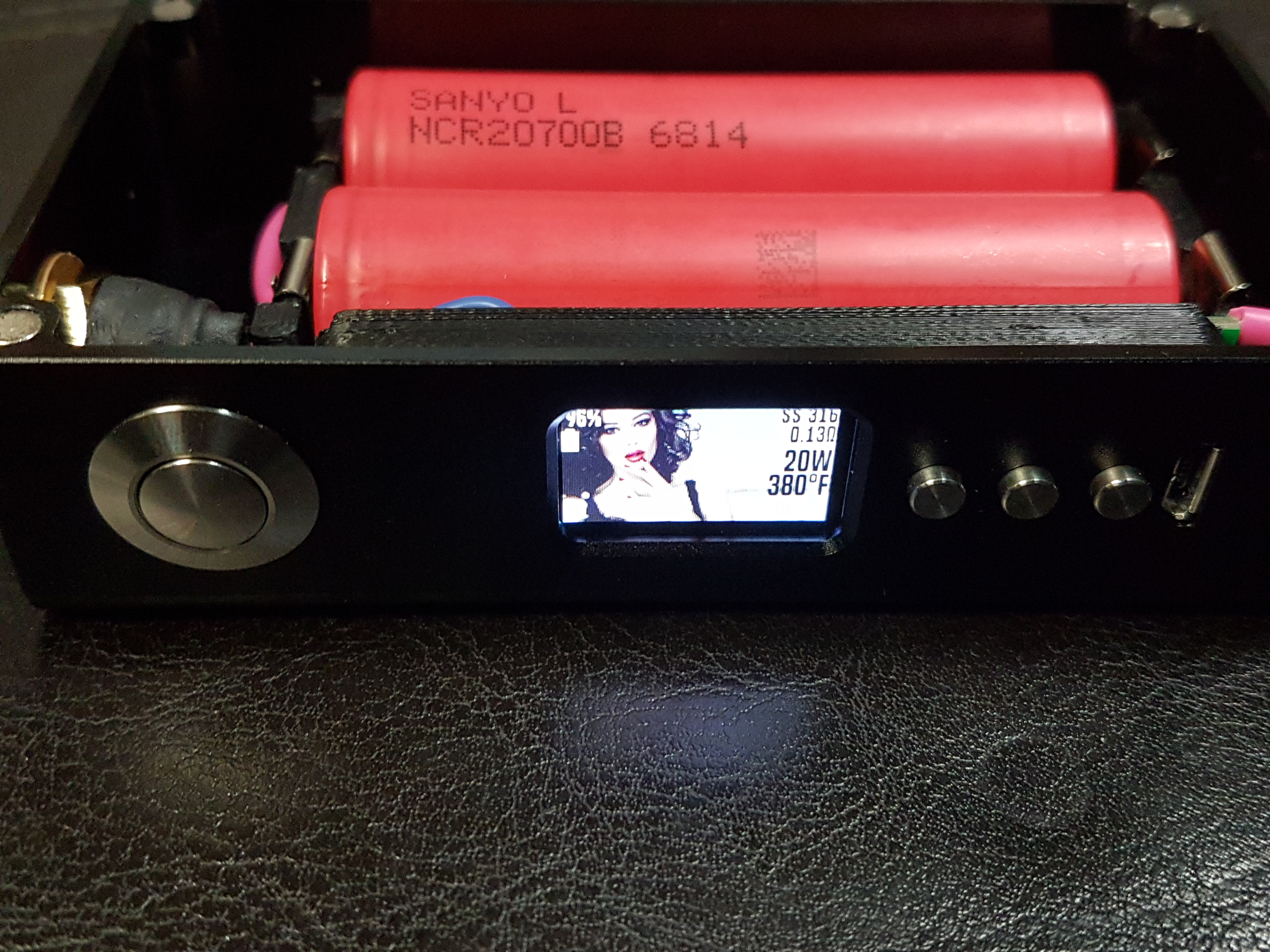

adski Posted February 22, 2018 Author Report Posted February 22, 2018 Here’s my latest. 75c twin 20700 Sanyo 4250mah. Wideboy case from Modmaker uk, fascia, buttons and source 510 from Stealthvape. Batteries soldered into a pack, (no weak battery message here) fascia and lid epoxied shut. Absolutly solid mod, not a rattle in sight. Sorry I forgot to take picture of inside before I glued it. 2

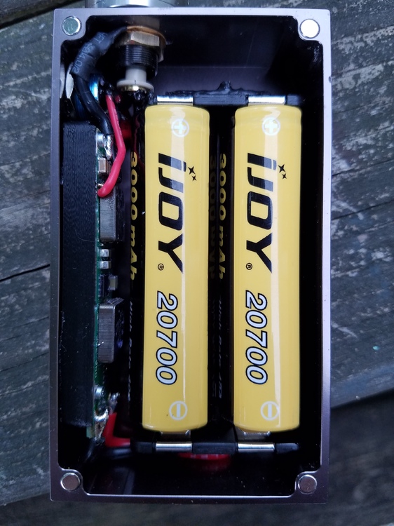

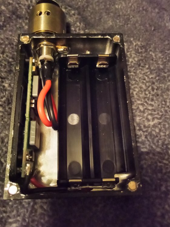

DkPatriots Posted July 30, 2018 Report Posted July 30, 2018 On 7/2/2017 at 12:58 PM, antyac2108 said: Alpinetech GXL Dual 20700 I just built this today I really like it. It went together fairly easy. I used a varitube V2 510 but I think I'm going to order a Cisco 510 and replace it. I don't like The varitube V2. Also I love this board. I really hope they come out with a 250C. Expand @antyac2108 I stumbled upon this post you made and have a question for you! I see that you used an AlpineTech GXL2 box in your build, along with the MosMax 2x700 dual 21700/20700 sled. I'm planning on doing the same thing in a DNA250C build I plan to do in the next week or so. My question is... can you fit two 21700 batteries in there? Toward the "top" of the mod it appears that you have enough room between the edge of the left hand battery and the chip on the board to fit the extra 2mm width of two 21700 batteries. There is a chip coming off the board lower down in the picture, and it isn't clear if a 21700 can fit without touch that chip. Lastly, you don't want the side of the battery to touch the positive lead you have on the board, because if the wrap gets damaged (or melted) you'll have a short. So the shorter version of my question is... Can you fit 21700 into there without touching the chips on the board or the positive and negative leads from the bottom of the board?
antyac2108 Posted August 12, 2018 Report Posted August 12, 2018 I think they would fit I replaced the 510 with the Cisco 510 and moved the battery tray over a little more since I took this picture. I don't have 21700 batteries at the moment or I would tell you if they fit or not. Sorry took so long to answer.

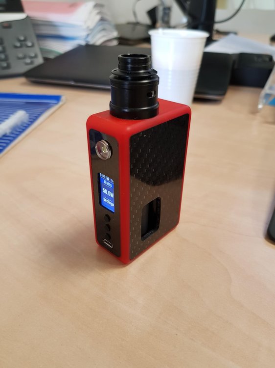

dsw67 Posted August 4, 2022 Report Posted August 4, 2022 Here is my 75c this is my second diy mod i really enjoy making my own. 1
