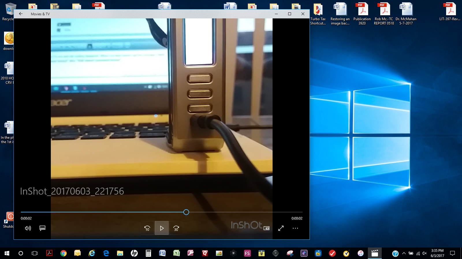

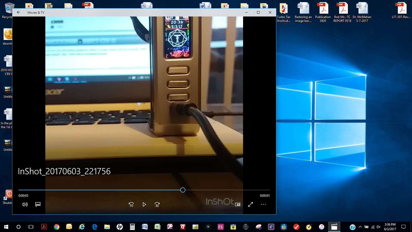

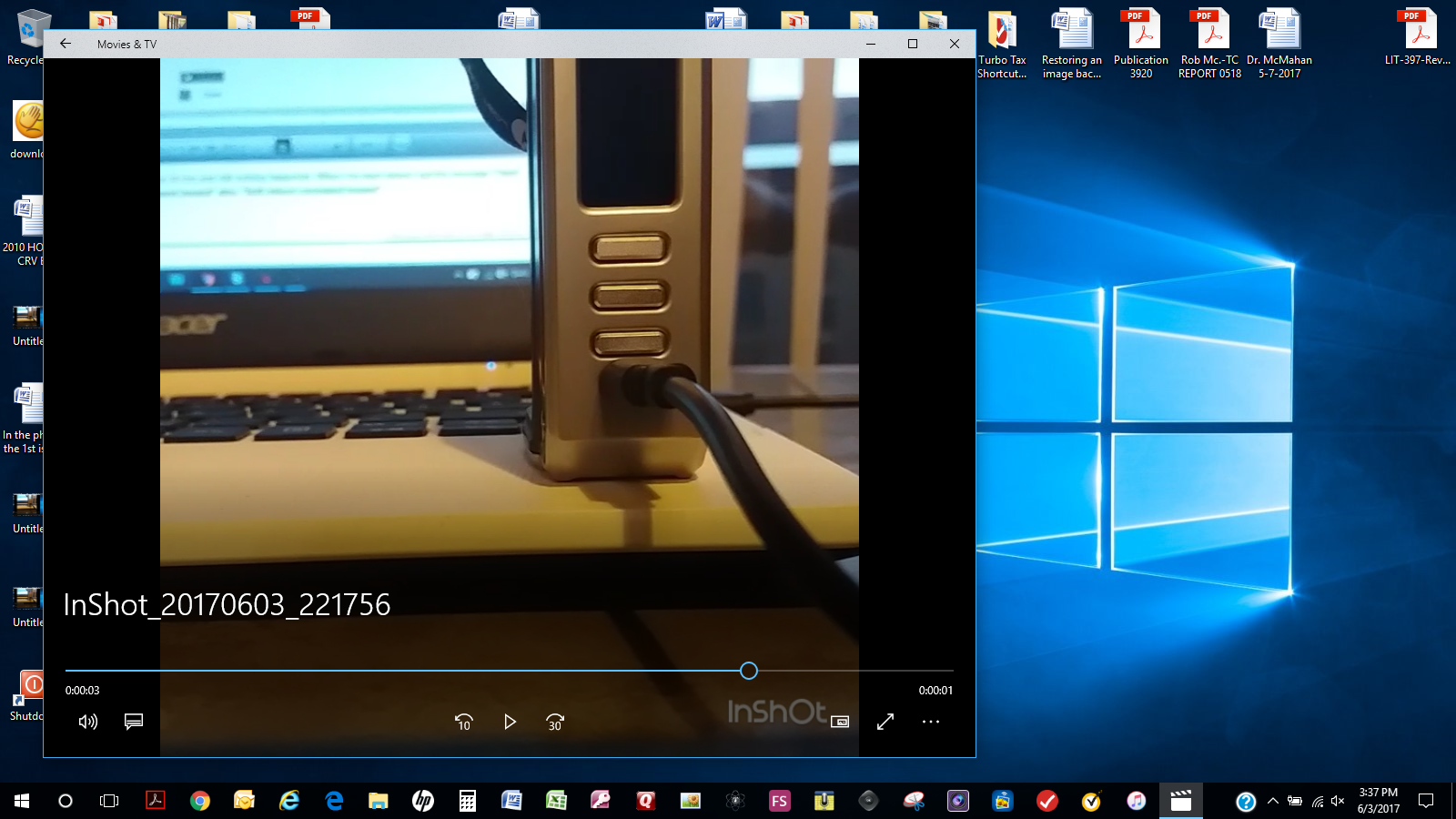

retird Posted June 3, 2017 Report Share Posted June 3, 2017 I took a few screenshots of your video.... It starts with black screen then gets white screen (picture 1) then gives an error message (picture 2) then gives theme screen (picture 3) then black screen (picture 4) if this helps James... Link to comment Share on other sites More sharing options...

James Posted June 4, 2017 Report Share Posted June 4, 2017 Interesting! "Error Press Up" seems to go away very fast. Are you pressing Up? If so, instead of pressing Up, could you download the settings when it is at that screen, and send me them? It looks like it is crashing. I'd like to find out what settings could cause that. Also, what Service Pack are you running? Link to comment Share on other sites More sharing options...
