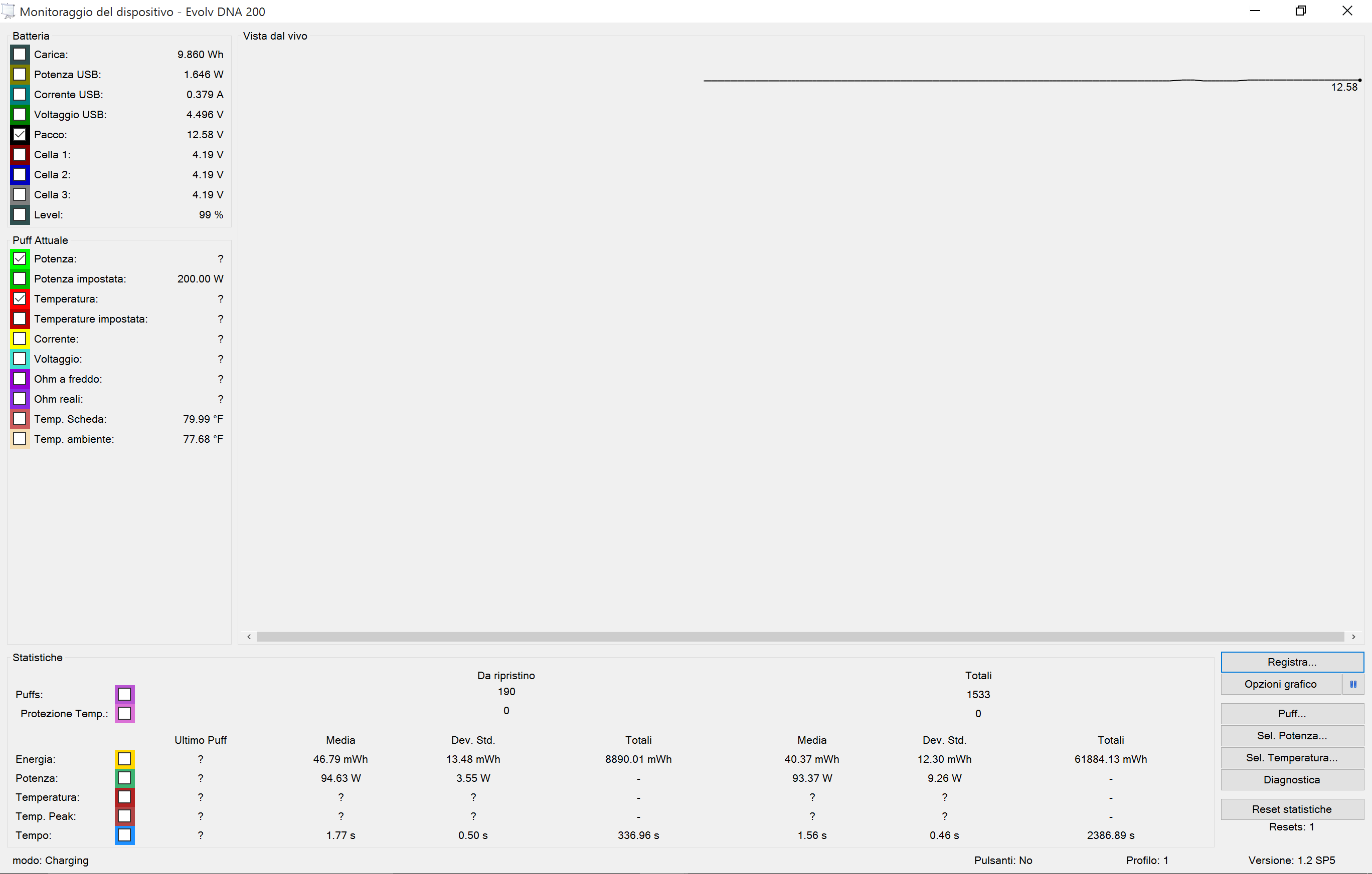

Vape_ON Posted May 30, 2017 Author Report Share Posted May 30, 2017 Exactly, when i make the update to dna 250 the program says that i must plug and unplugged the usb. It is impossible because before the program reads correctly my box. I send you the screenshot. Link to comment Share on other sites More sharing options...
retird Posted May 30, 2017 Report Share Posted May 30, 2017 That screenshot says you have connected a DNA200 not a 250 device. Device monitor is recognizing the board you have in your device that you connected.. Questions again: 1. Did you change the original DNA 200 board out and put in a new DNA250 board in the tugboat? 2. What do you see when you click on "Get Information" under the My DNA section of the General Tab? Post a screenshot of what you see.... 1 Link to comment Share on other sites More sharing options...
giz_60 Posted May 30, 2017 Report Share Posted May 30, 2017 On 5/29/2017 at 9:37 AM, Vape_ON said: Hi, i have a problem with the tugboat. I'm trying to upgrade from dna 200 to dna 250 but I can not make it. Although I tried to install the dna 250 service pack I can not install it. Someone has already done so? thank you The 200 cannot be upgraded to a 250 by a software/firmware upgrade...the 250 is a completely different board! 3 Link to comment Share on other sites More sharing options...
