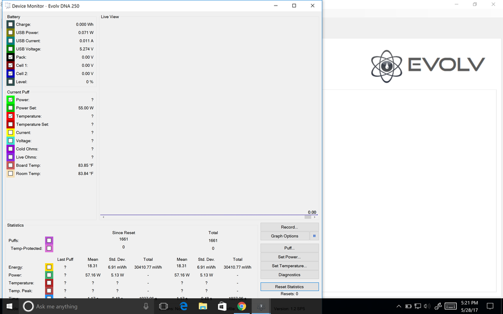

evilkaos Posted May 28, 2017 Report Posted May 28, 2017 Hey I just got a new Therion DNA166 about a week ago. And suddenly today it won't turn on. I have tried with different batteries to no avail. When I plug in the power cord I see a very dimly lit screen. I plugged it into EScribe because I saw another post that said to change it from 3-cell to 2-cell but that didn't help. It was working amazingly until today
retird Posted May 28, 2017 Report Posted May 28, 2017 What does the "Pack" and "Cell" voltages say in Device Monitor?
evilkaos Posted May 28, 2017 Author Report Posted May 28, 2017 7 minutes ago, retird said: What does the "Pack" and "Cell" voltages say in Device Monitor? They all say 0.00 V
