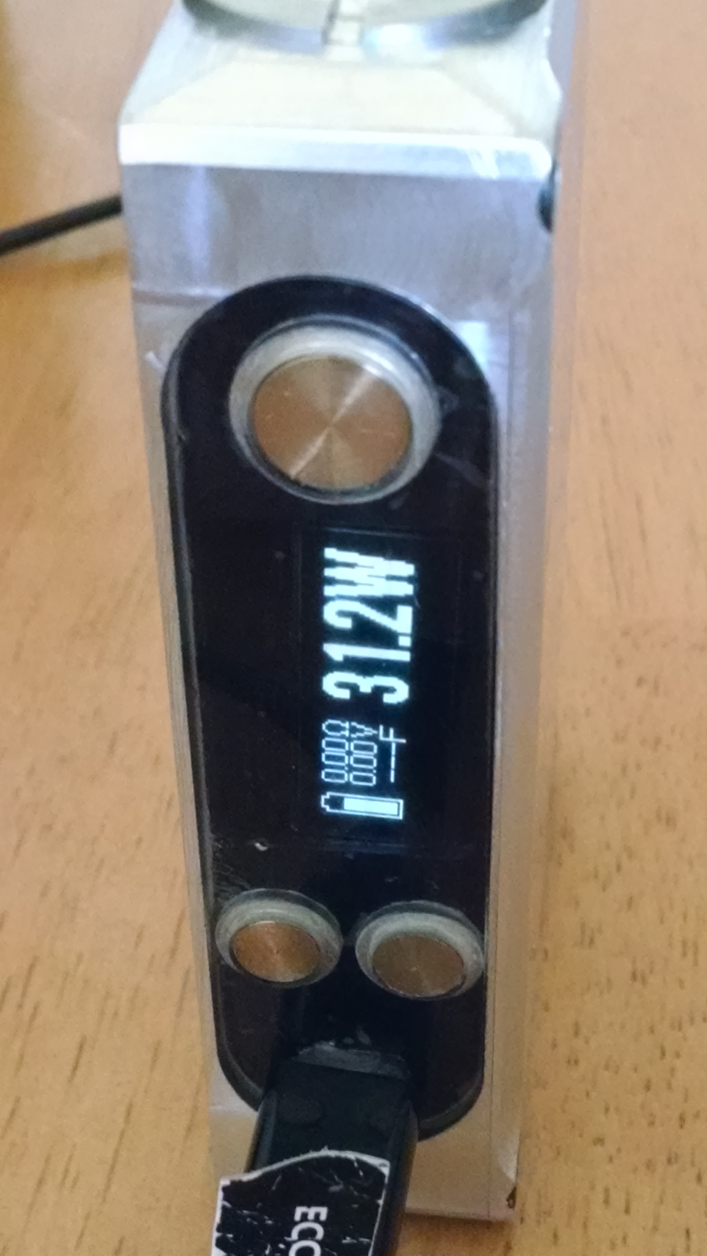

Bern18462 Posted July 19, 2015 Report Posted July 19, 2015 Mine is doing the same everything is tight and still dont change over I'm out of ideas ... How do I restart the board
retird Posted July 19, 2015 Report Posted July 19, 2015 Did you run Atomizer Analyzer? What was the results?
VapingBad Posted July 19, 2015 Report Posted July 19, 2015 You restart form EScribe Tools menu, these problems are almost always connectivity or less often poor battery connection.
Bern18462 Posted July 19, 2015 Report Posted July 19, 2015 Idk what that is .... And the ohms are always at 0 ...

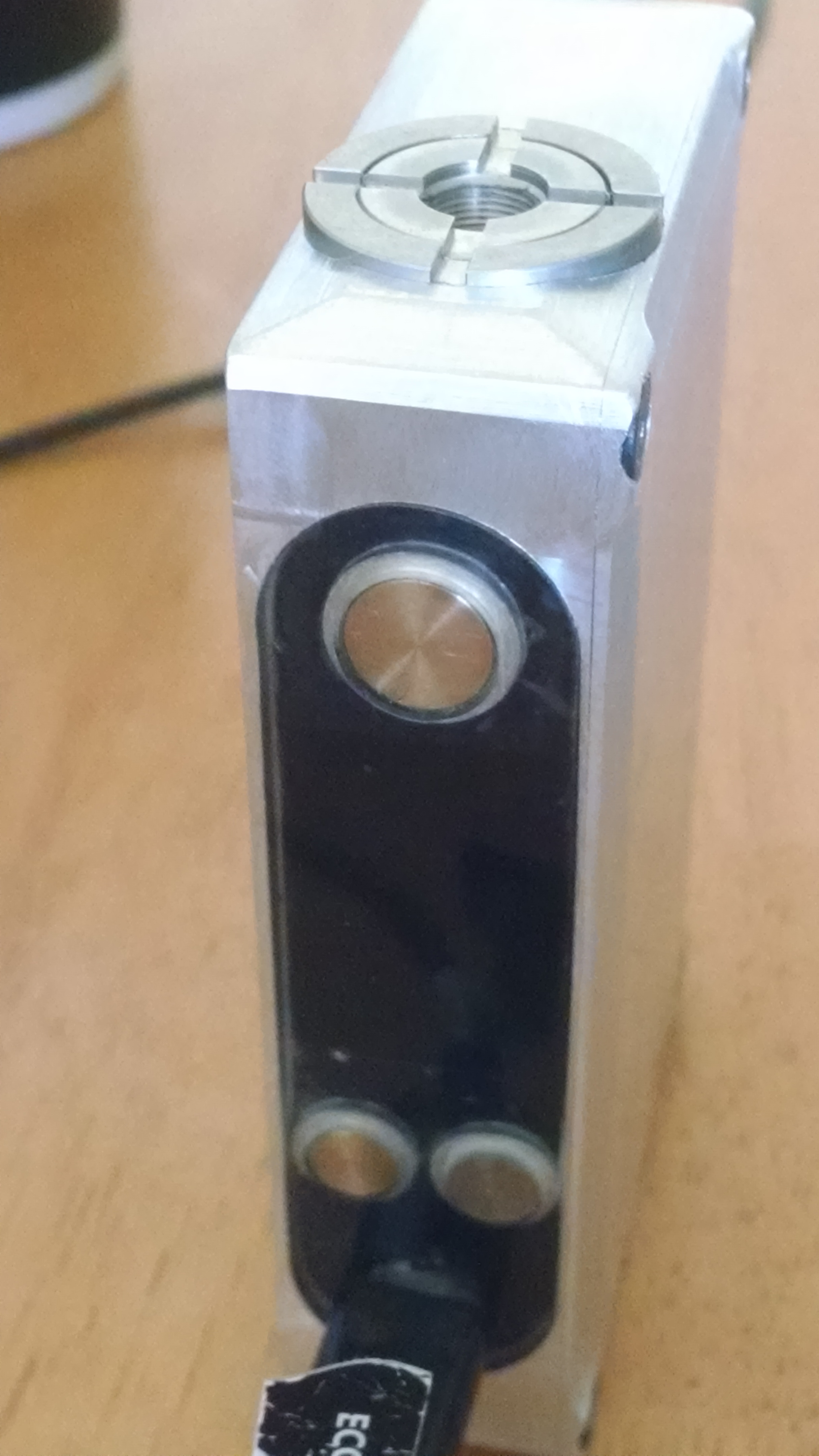

Bern18462 Posted July 19, 2015 Report Posted July 19, 2015 Everything is soldered solid but then again I didn attach the board to box with the bolt location ..... Is that a thing I should do?
VapingBad Posted July 19, 2015 Report Posted July 19, 2015 If the ohms are a 0 then you have a short, if I were you I would try another atomiser.
Bern18462 Posted July 19, 2015 Report Posted July 19, 2015 I did that and both are the same ... The lock is off for the ohms and it still fires the coil but with no ohms on screen..
retird Posted July 19, 2015 Report Posted July 19, 2015 Bern18462 said:I did that and both are the same ... The lock is off for the ohms and it still fires the coil but with no ohms on screen..Are you running the latest version of EScribe and firmware update and have you looked at Device Monitor for anything unusual while device is connected to EScribe?

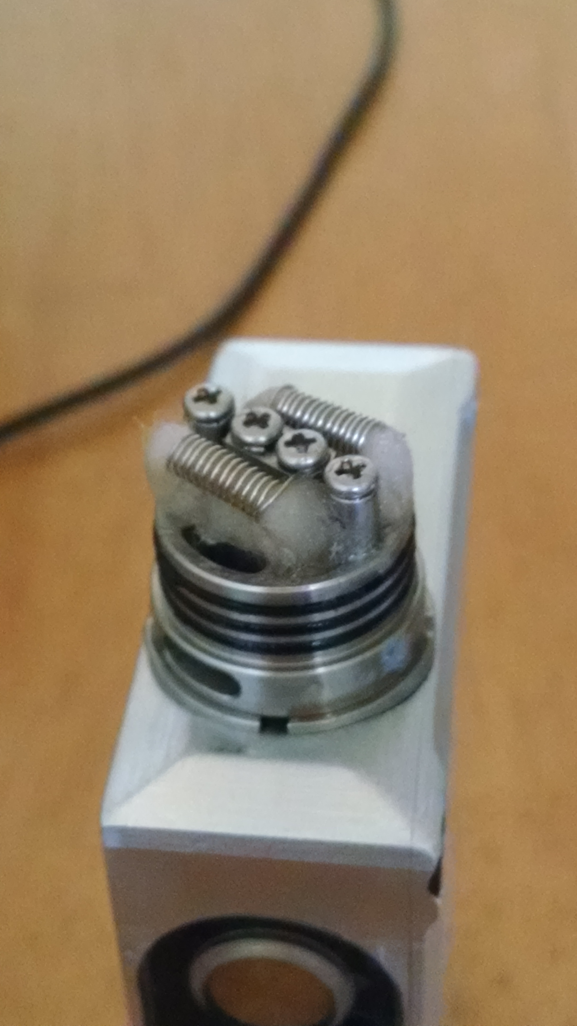

John Posted July 19, 2015 Report Posted July 19, 2015 Has your DNA 200 mod recognized other coils properly? That certainly looks properly built.
Bern18462 Posted July 19, 2015 Report Posted July 19, 2015 No never recognize it I have to change it manually and still I put it to 320° and it barley smokes
Bern18462 Posted July 19, 2015 Report Posted July 19, 2015 On the atomizer analyzer it says kanthal ... But I have ni200 in there
VapingBad Posted July 19, 2015 Report Posted July 19, 2015 the atomizer analyzer has both kanthal and nickel, you can tell it has picked up nickel by the temp showing as the last of the 3 fields on the dna screen.
Bern18462 Posted July 19, 2015 Report Posted July 19, 2015 It don't even ask if I change atomizers I changed 3 different ones so its probably a screw up on my side idk ... And I can go to 600° in temp mode and barly any vapor
VapingBad Posted July 19, 2015 Report Posted July 19, 2015 It wont ask if the resistances are close to each other, 25% is the default value it can be changed in the Mod tab - Thermal - Ohm Lock Range
Bern18462 Posted July 19, 2015 Report Posted July 19, 2015 I put it to 5% and went from a .06 build to a .64 amddidn ask .. Am I just messing up on something .... Does the board NEED to be grounded with the 3 1.7 mm bolts?
VapingBad Posted July 19, 2015 Report Posted July 19, 2015 I think the grounding has to be very good with these and I would think a poor contact with common ground or a dry solder joint would give you problems like you describe.
Bern18462 Posted July 19, 2015 Report Posted July 19, 2015 So me not having it bolded in may cause these problems? I'll double check solders and make a different box
