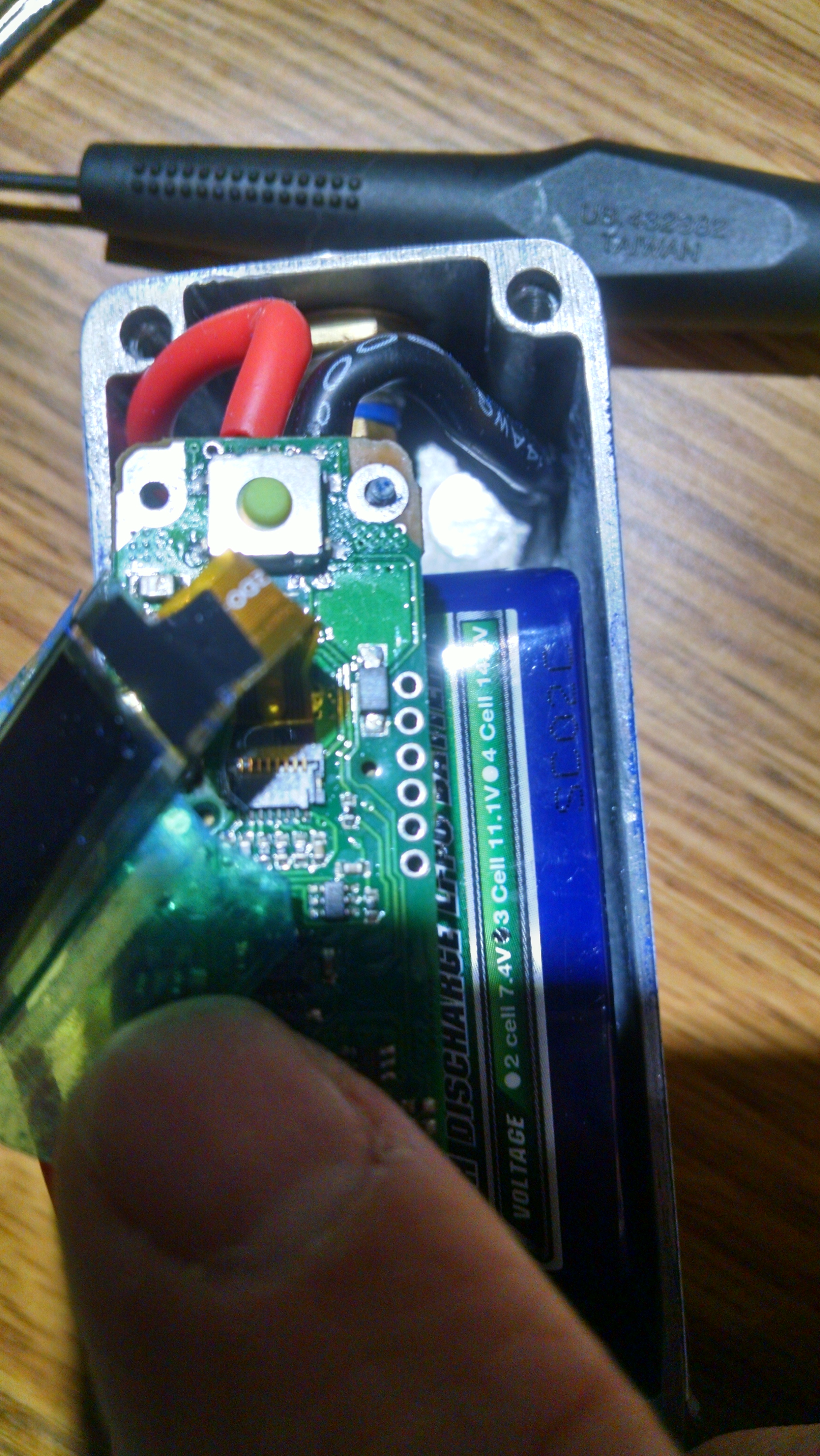

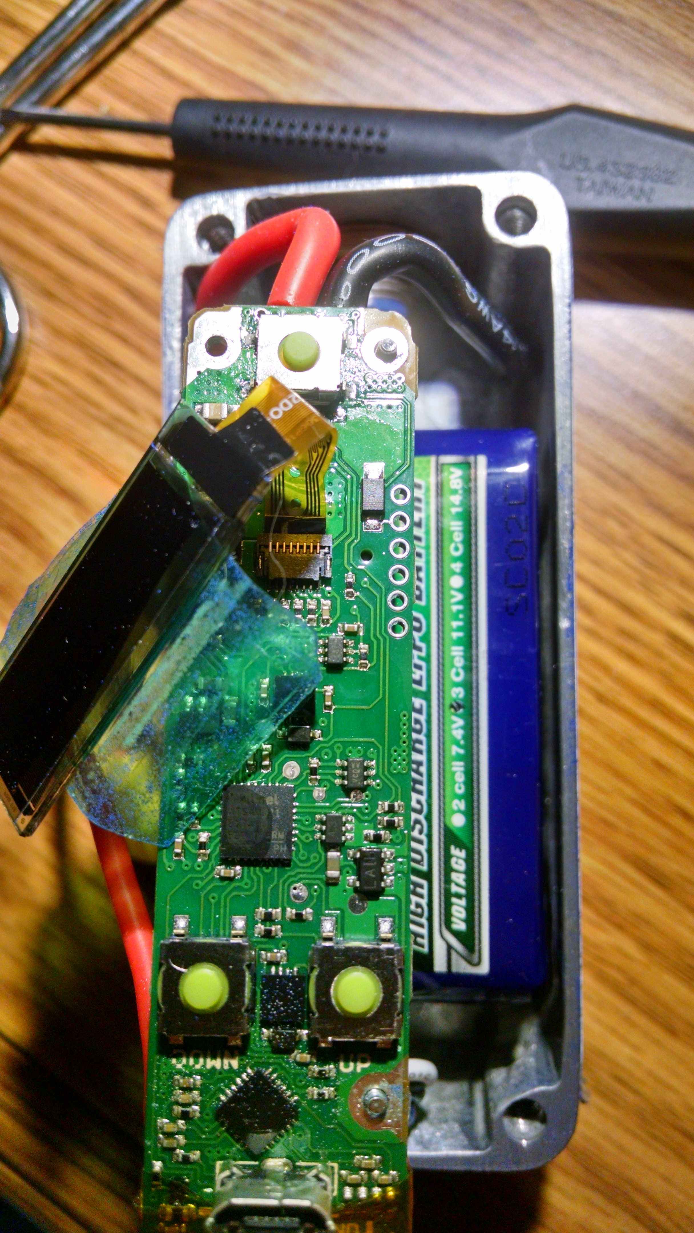

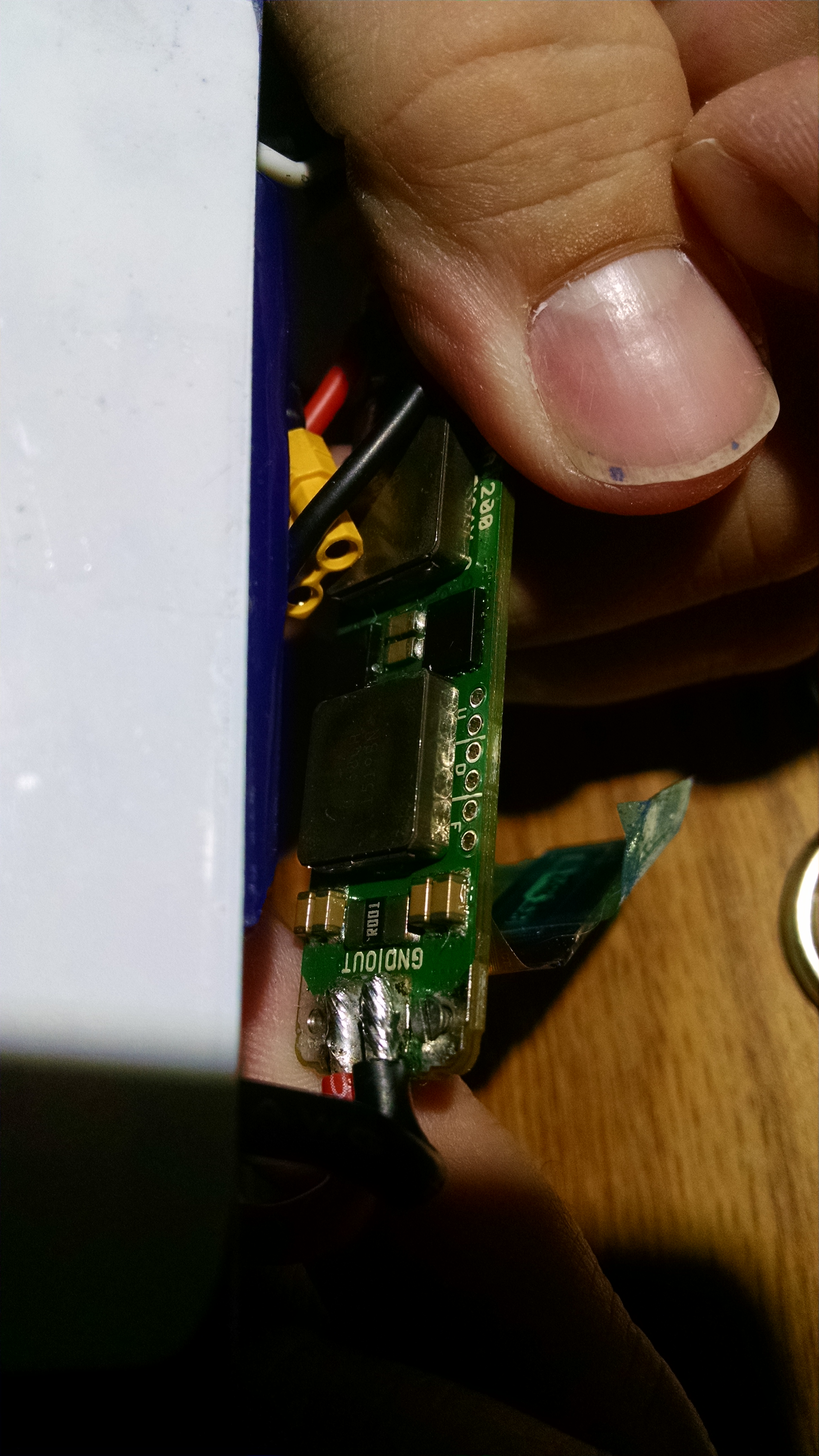

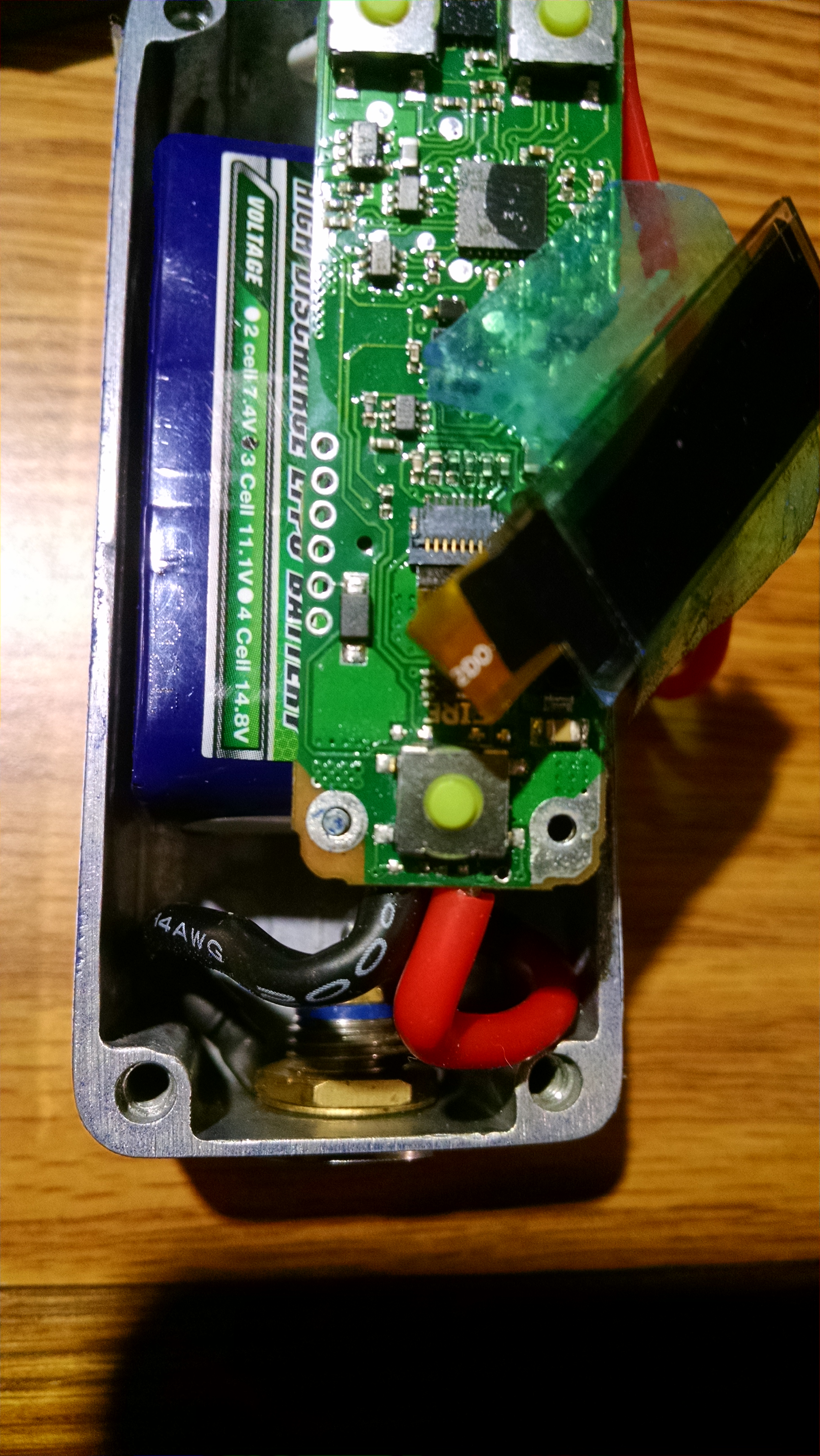

antyac2108 Posted July 21, 2015 Author Report Posted July 21, 2015 Here you go John the pictures you asked for hope it helps thank you
retird Posted July 21, 2015 Report Posted July 21, 2015 antyac2108 said:Here you go John the pictures you asked for hope it helps thank youSo with it open like shown in the pictures does it still lock up while firing by pushing the onboard fire button with your finger?
John Posted July 21, 2015 Report Posted July 21, 2015 When it is sticking, if you measure the voltage on the offboard switch holes closest to the output edge, does it read something like battery voltage, or does it read less (.5 volts or less)? Measuring relative to ground (any of the mount pads)
antyac2108 Posted July 21, 2015 Author Report Posted July 21, 2015 It reads 9. Something when being fired on the external switches
antyac2108 Posted July 21, 2015 Author Report Posted July 21, 2015 I measured it when I was at work and didn't bring the multimeter home sorry
antyac2108 Posted July 21, 2015 Author Report Posted July 21, 2015 9. Something volts sorry should have put that in there
John Posted July 22, 2015 Report Posted July 22, 2015 Which is what it should. The question is when it is continuing to fire after you stop pressing the fire button, does it read 9-12v, or does it read less than a volt?That would tell us if it is a hardware problem or a software problem.
John Posted July 22, 2015 Report Posted July 22, 2015 If you mean the via hole next to the output pad, then no, we use that to be able to test the output from the top side during production. It connects to the pad, so you can solder it or not, it doesn't make a difference.
antyac2108 Posted July 22, 2015 Author Report Posted July 22, 2015 Yeah that's what I was looking at.
antyac2108 Posted July 22, 2015 Author Report Posted July 22, 2015 hello john i just tested it this morning when i got to work and it reads 8.9 Volts when it continues to fire after the button has been pressed.
