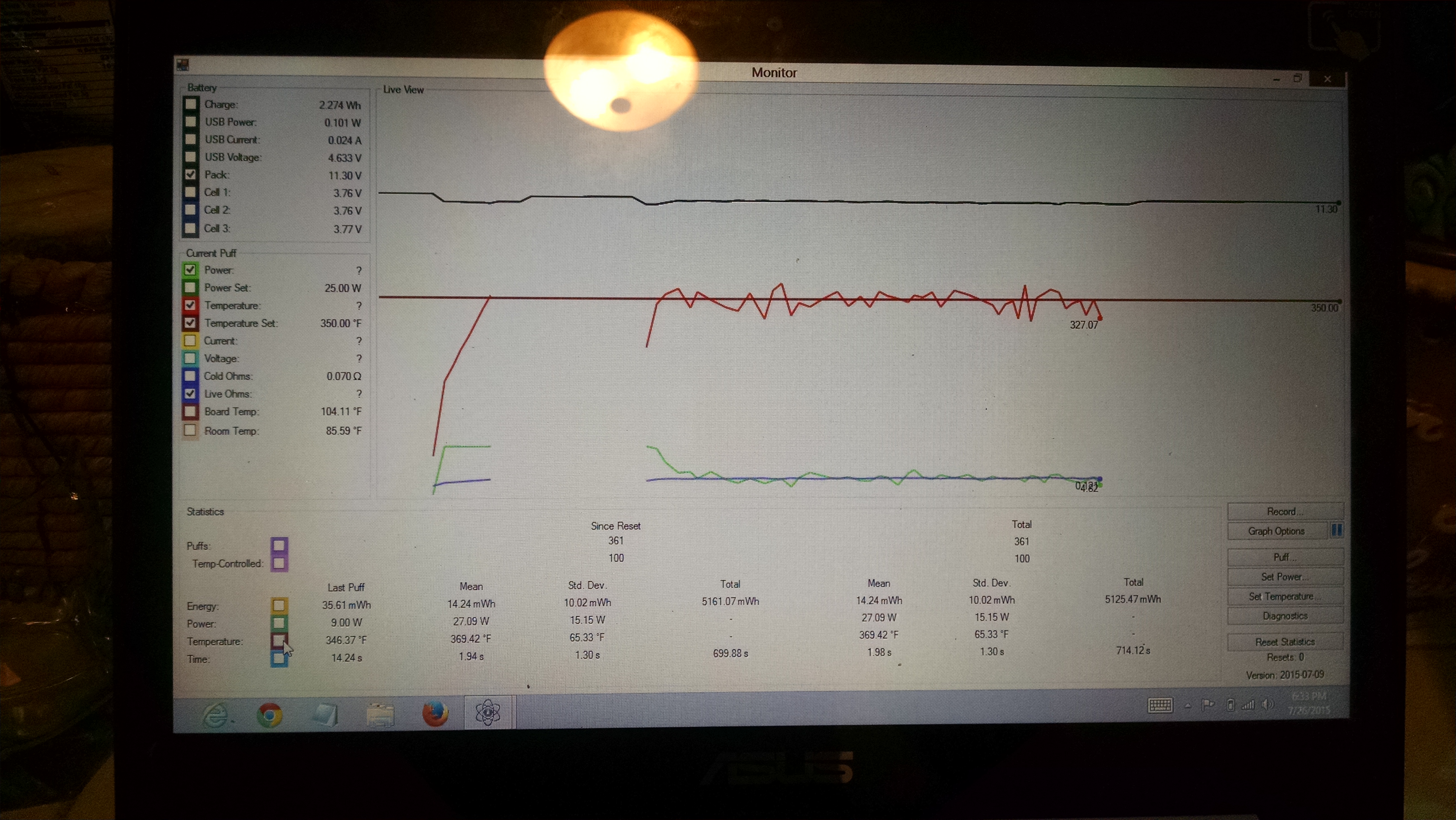

John Posted July 25, 2015 Report Posted July 25, 2015 If you turn temperature control off, does it work normally? You can fire nickel coils with temp mode off too. If so, can you post a graph of the live ohms from device monitor?

John Posted July 25, 2015 Report Posted July 25, 2015 Yes, go to device monitor, and then select the check box next to "live ohms"
Bern18462 Posted July 25, 2015 Author Report Posted July 25, 2015 So I should fire nickel coils on normal mode and while I'm firing it take a picture of the graph Right .. Is what u want ?
John Posted July 25, 2015 Report Posted July 25, 2015 Yep. Graph the live resistance. That way we can see what's going on.

retird Posted July 26, 2015 Report Posted July 26, 2015 Here is a graph showing 400F@25 watts with pre-heat set to 50 watts and punch set to 5 using the reference device with an Atlantis atty with Ni200 factory coil. Works great. Cold ohm's is 0.158 and moves to 0.308 while vaped. How does this compare to yours?

Bern18462 Posted July 27, 2015 Author Report Posted July 27, 2015 Bottom is live ohms middle is temp and top current ... Looks all screwed up to me
retird Posted July 27, 2015 Report Posted July 27, 2015 Bern, this may seem like a dumb question but does your juice pop and crackle alot while firing? Maybe why your graph looks that way...looks like it is just regulating temp and wattage with the ohm's staying consistent...
