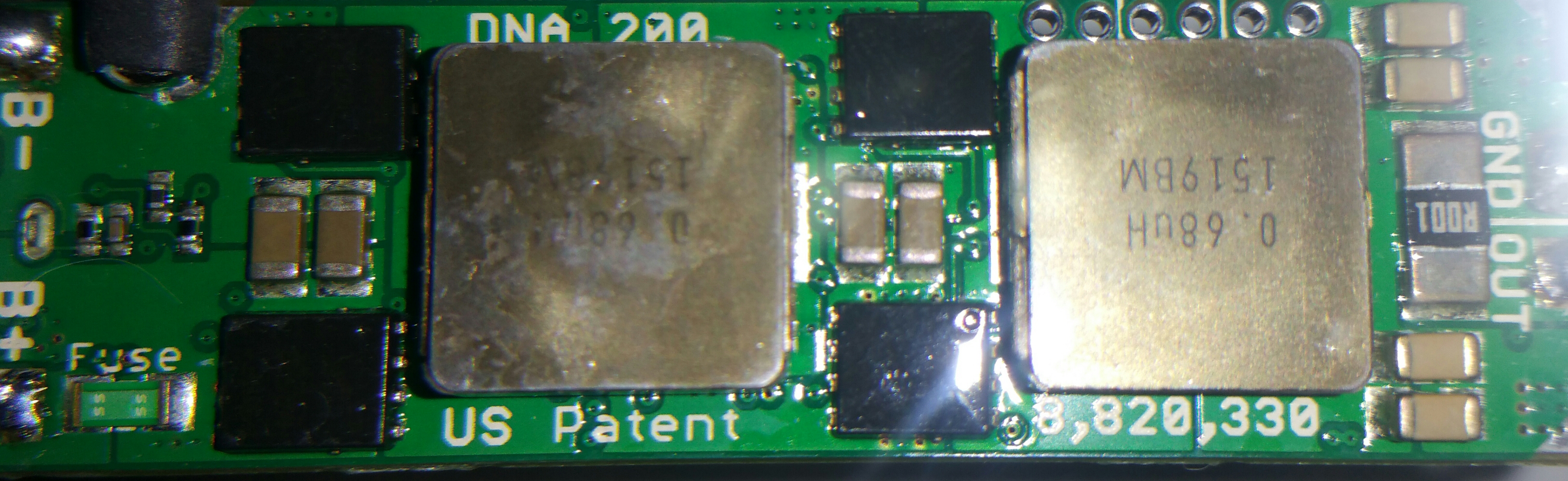

Nothing happens, only a great amount of heat developed from the marked chip (the chips where the coating partly melted away get hot too, but this chip seems to be the hottest):Hot-Chip.jpg
The Pc doesn't even recognise a new device beeing connected.

The Board Temperature sensor will protect well before the board should have any problems, and even at high powers it takes a while to get that hot. I admit I've not tested with a fan present, but I can't see that making a difference unless the Board Temperature sensor was being cooled by the fan better than the rest of the board...  What power were you doing the test at?
Hmm.
Send Help Desk a ticket for a replacement, and have them send the board to us to take a look at. We'll see what we can see.
