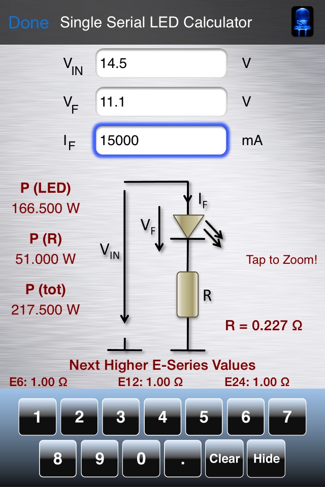

Guest Posted August 11, 2015 Report Share Posted August 11, 2015 There talking about AC-DC. Seeing how this board acts like an led I'm going to treat it like one so I'm buying this http://www.mouser.com/Search/m_ProductDetail.aspx?Arcol%2fHS200-0R22-1%2f&qs=sGAEpiMZZMtbXrIkmrvidKzXrWGN%252biMBiHsTbHMqfQQ%3d 15A is more than plenty plus I don't see why this wouldn't work Link to comment Share on other sites More sharing options...
