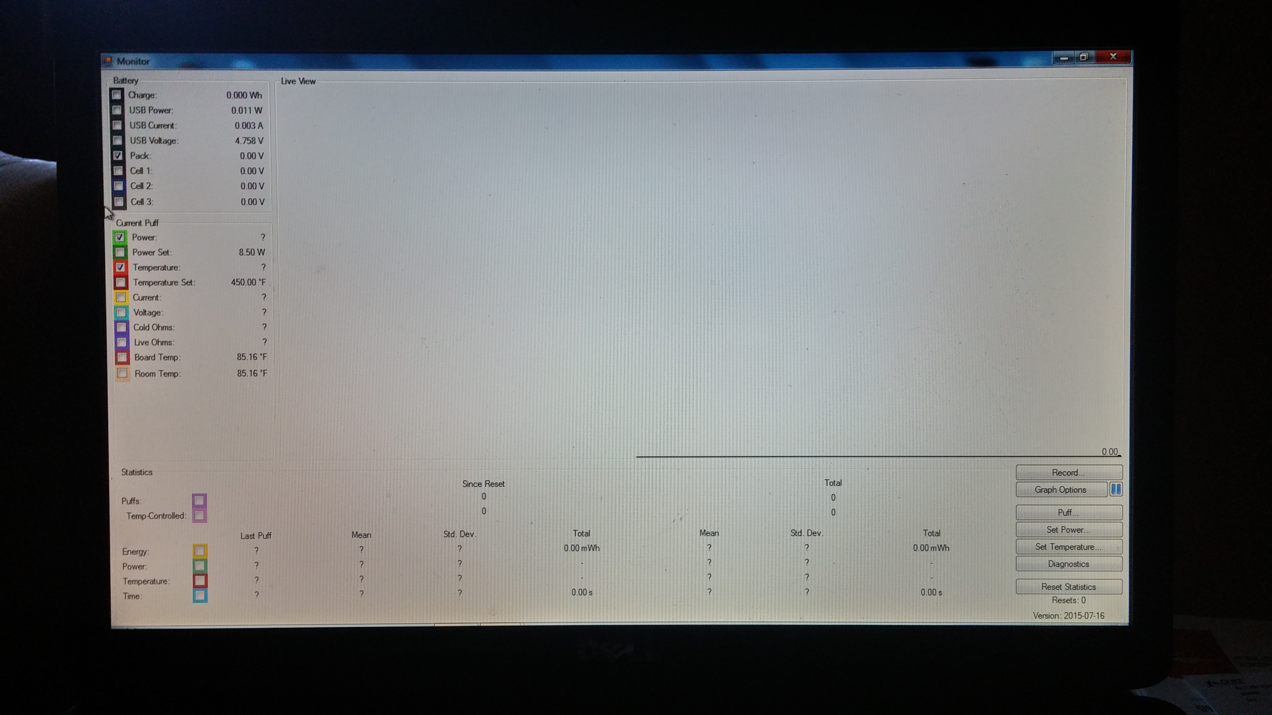

Always_Jonezen Posted August 2, 2015 Report Share Posted August 2, 2015 My board is not showing the battery on the display or on escribe 0 volts for pack power 0 volts on all 3 cells but the battery is working on my other 2 boards, any suggestions Link to comment Share on other sites More sharing options...

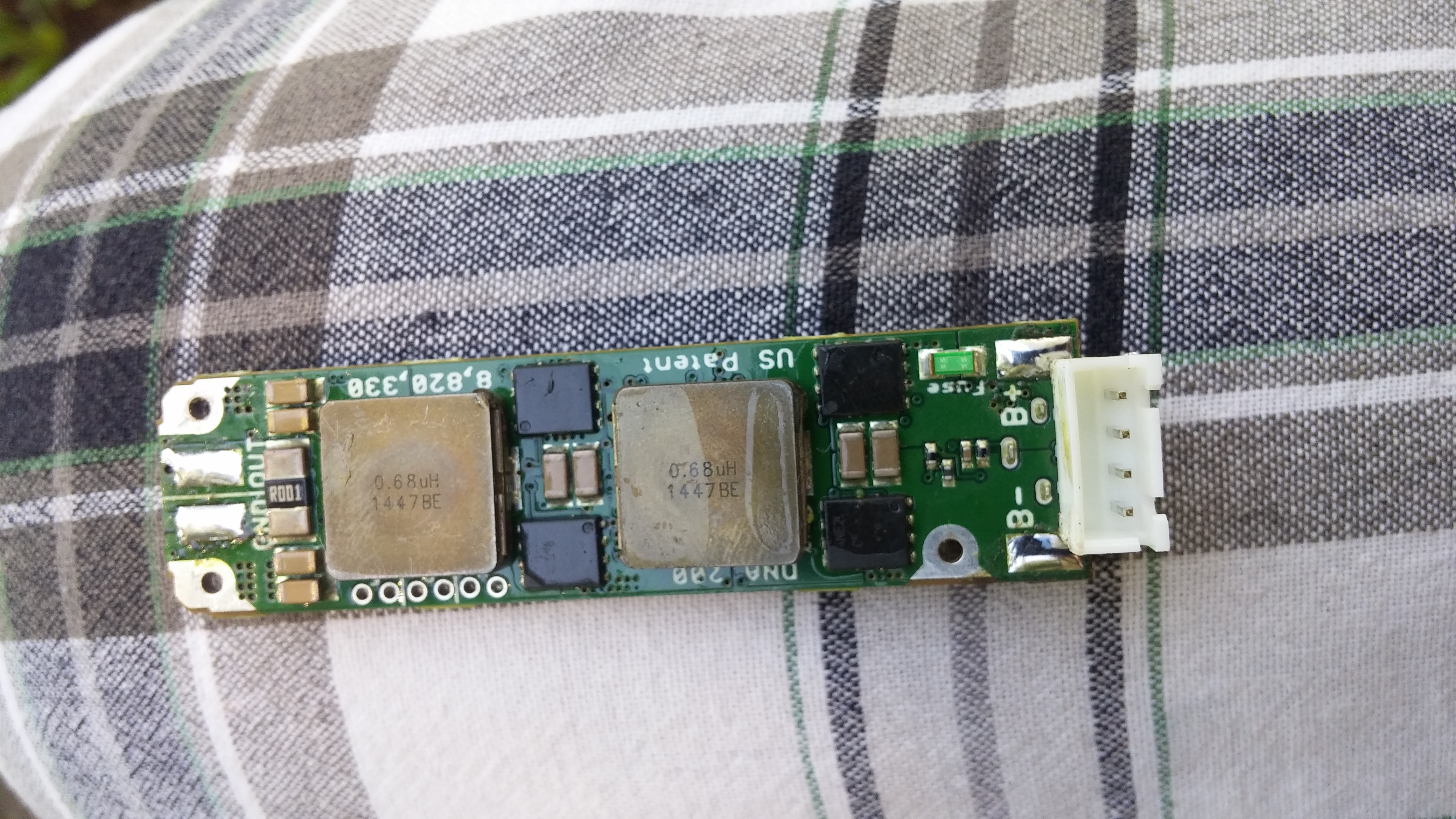

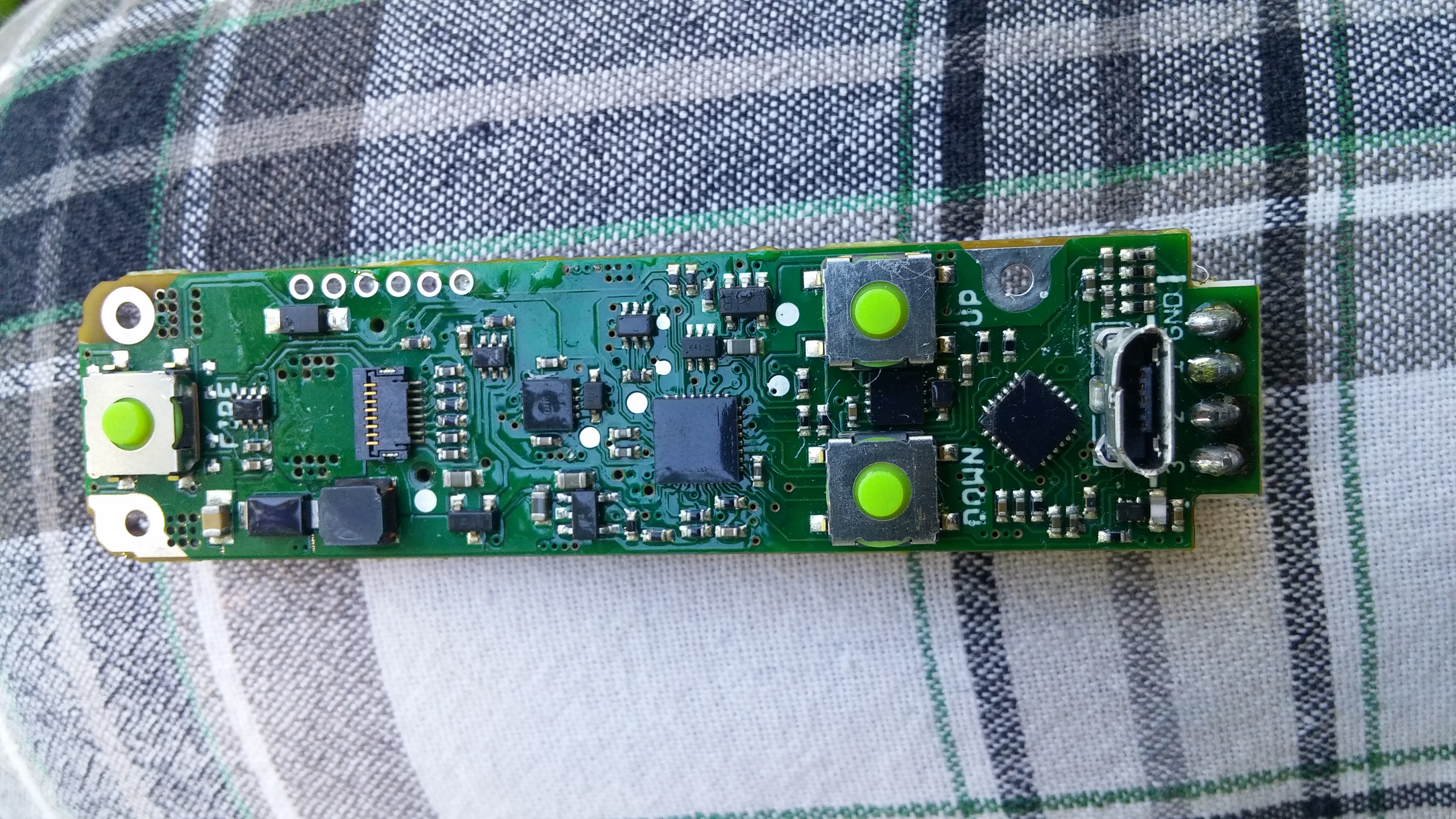

John Posted August 2, 2015 Report Share Posted August 2, 2015 Yeah, yours is definitely not talking to the analog front end. Is your cell 3 tap solid, and the resistors closest to the USB connector on the right? Link to comment Share on other sites More sharing options...
Always_Jonezen Posted August 2, 2015 Report Share Posted August 2, 2015 John said:Yeah, yours is definitely not talking to the analog front end. Is your cell 3 tap solid, and the resistors closest to the USB connector on the right? Yeah I'm not sure but it is a 11.1V 3s 35c wired directly to the board with balance connector plugged in. If you need me to wire it back up I will, sorry I should have taken a screen shot with it plugged up though eScribe, here is some pictures. I resoldered the joints to the tap just now and plugged it up to eScribe here is a picture. Link to comment Share on other sites More sharing options...
Always_Jonezen Posted August 2, 2015 Report Share Posted August 2, 2015 Picture of eScribe Link to comment Share on other sites More sharing options...
