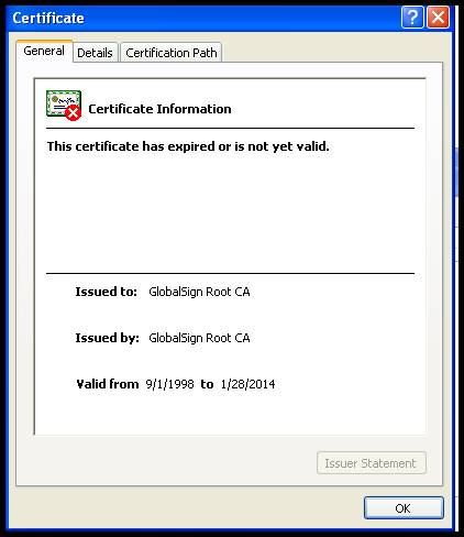

I played till I made Parallels crash. Got lots of screen shots of "certificates", here is one that looks expired.SS_367.jpg

Hmm. It must not have made that new Root Certificate take priority over the built-in, expired one.
EScribe uses Microsoft's .NET Framework, so underlying web requests use Internet Explorer. If it can't make a secure connection it will fail to connect -- we don't override the default verification. Here's a Windows update that should give you newer root certificates. Hopefully the GlobalSign is among them...
https://www.microsoft.com/en-us/download/details.aspx?id=26609
There was an even newer one, but it appears Microsoft has removed it in their desperately needy attempt to force people to use their new OS...
